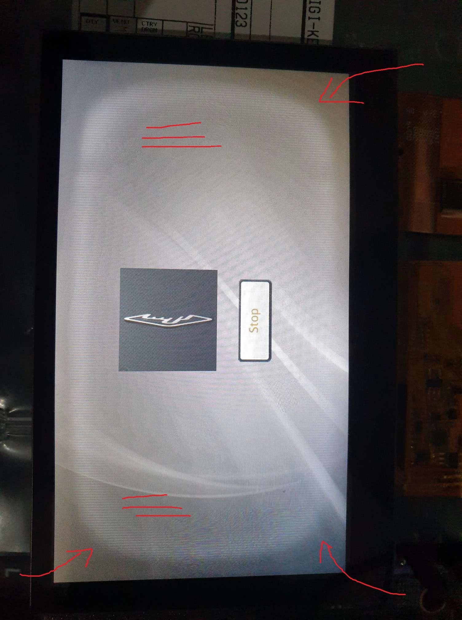

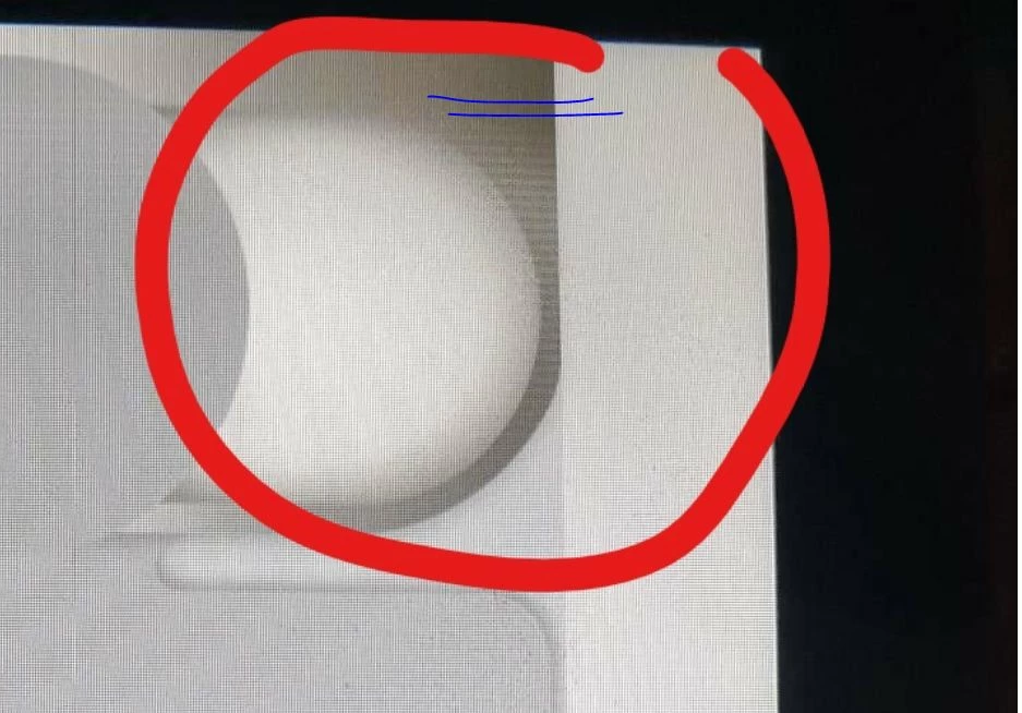

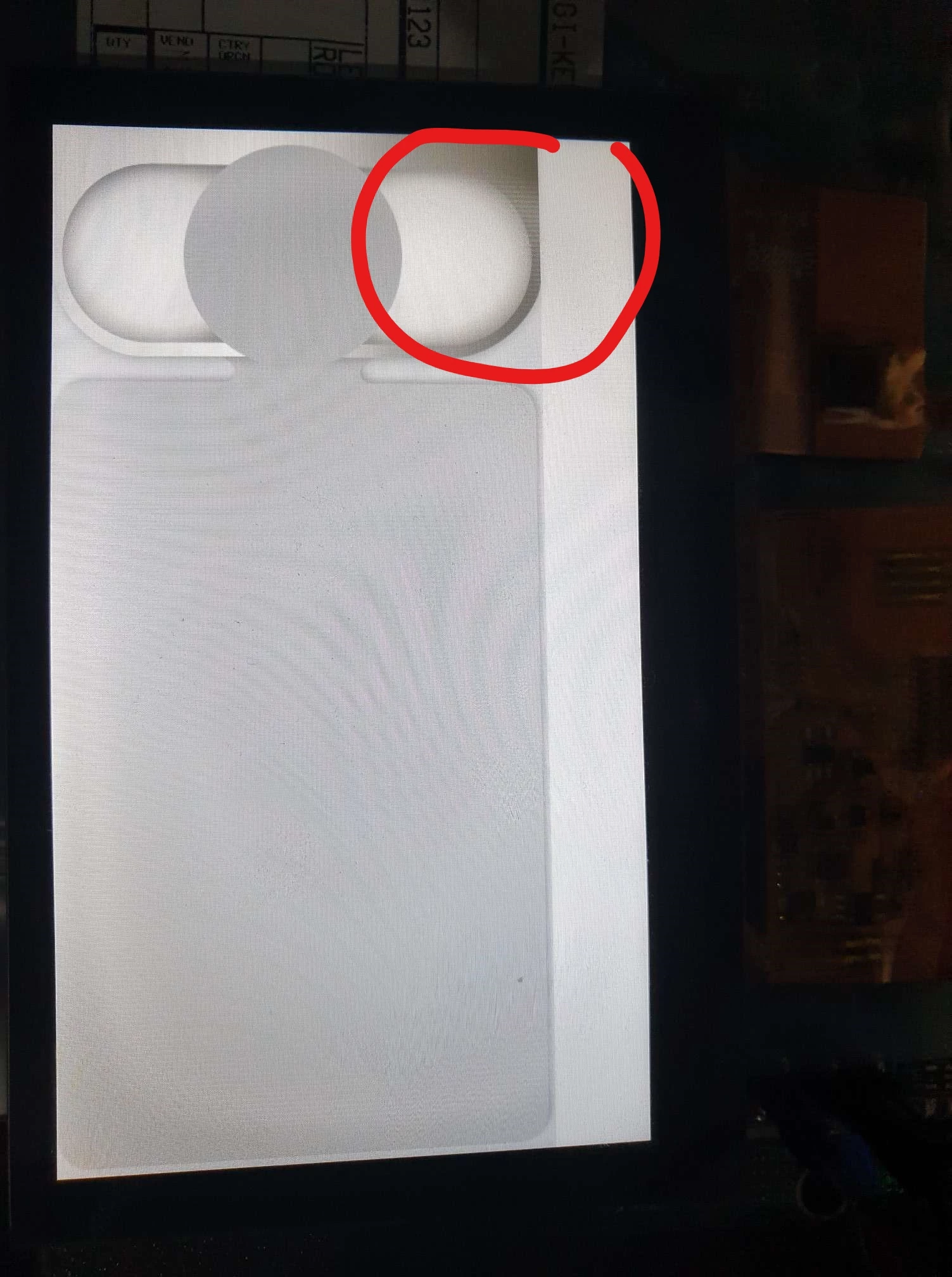

Hi all,
Does anyone know why do i get these vertical lines on my display. I get these on all four corners.
Thanks

Please provide more information like:
  • What board ?
  • Custom display ?
  • Used TouchGFX v?
  • Steps you did to arrive to this issue
/Alexandre

Hi alexandre,
Thanks for your reply. This is a custom board. but it uses same components in stm332h750 lcd board. LCD is 800x480.
TouchGFX  4.13.
I created a touchgfx project for h750 board. Opened it with cube ide and changed the resolution.

So the screen is not the same as on the H750-DK. There might be an issue with how you set your display interface. Changing the dimensions only can be insufficient. Are you using an LTDC display or a DSI one ?
