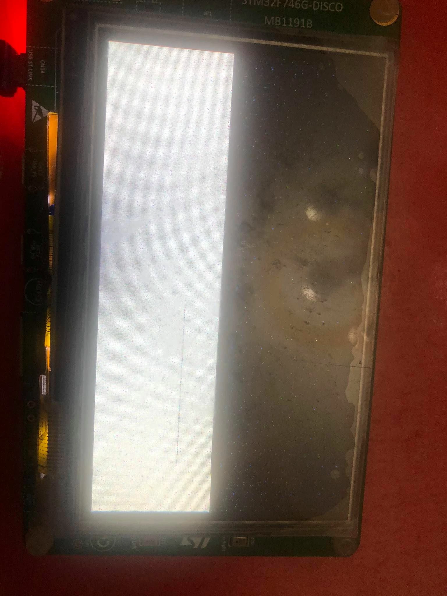

LCD does not work used touchgfx with stm32f746g-disco board
  • October 29, 2020
  • 7 replies
  • 3317 views
0693W0000059hTsQAI.jpgTouchgfx does not work for me, I get the pixelated screen I use stm32cubeide 1.4.0 it does not work for me download version 1.2.0 and also download TouchGFX V4.14 and nothing, change the version ==> V4.13 and still some help friend , I hope you can help me ??
I made a simple program in touchgfx and there it works, but the detail is that I use LWIP in my program, I need to use it from stm32cubeide

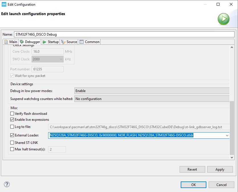

Best answer by Alexandre RENOUX
I looked at your project briefly and as Martin mentioned you haven't set the external loader for the F746-DISCO board in your CubeIDE project.
Here is the location where you need to modify it :
0693W000005A8dGQAS.pngIf this external loader is not set correctly I'm starting to wonder if you used the F746-DISCO Application Template available in the Designer. If you haven't, please in the future if you try to run some code on a board that we support, start with the corresponding Application Template to avoid unnecessary issues.
For the step to upgrade to a newer version, please have a look to this article in our documentation website : https://support.touchgfx.com/docs/miscellaneous/updating-to-a-new-touchgfx-version
When your question is answered, please close this topic by choosing Select as Best.
/Alexandre

What are you expecting the application to look like? Is the External Flashloader configured properly for your project?

Where do I know that the external flash loader option is set right for i project?
