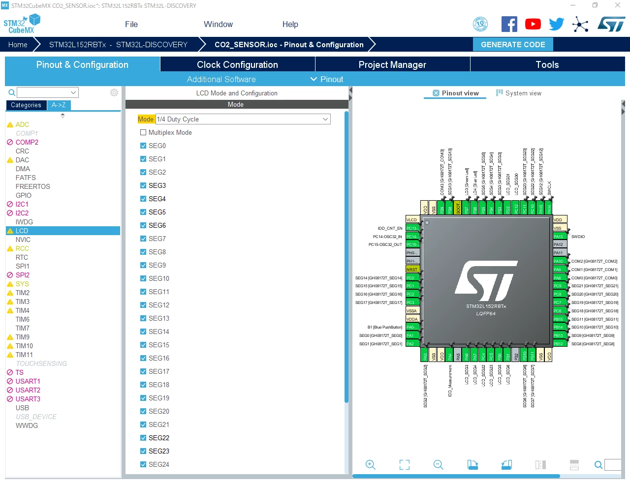

Hello.
I found several other people asking similar questions, but none of them have been resolved, so I will ask you a new question.
I am developing using STM32L-Discovery.Specifically, we would like to display on the LCD mounted on this evaluation board using the HAL library.
However, apparently I may not have set the LCD correctly in CubeMx.
This is because an error has occurred in the initialization function of the output LCD, HAL_LCD_Init ().
Specifically, TIMEOUT occurs in the following code and an error has occurred.
while (__ HAL_LCD_GET_FLAG (hlcd, LCD_FLAG_RDY) == RESET) {
   if ((HAL_GetTick ()-tickstart)> LCD_TIMEOUT_VALUE) {
     hlcd-> ErrorCode = HAL_LCD_ERROR_RDY;
     return HAL_TIMEOUT;
In other words, LCD_FLAG_RDY is not set regardless of how long.
In CubeMx, the settings are as shown below.
Can someone help me with the solution?
Thank you.

​�?Update】
I have confirmed that this is not a problem with the HAL library.
Let me explain how I confirmed it.
I downloaded the sample project of AN3964-Temperature_sensor and tried it.
This consists of a library different from HAL.
But this also output an error during execution.
The error occurred in the following function:・ LCD_GLASS_Init (void)
The following points are specifically stopped.
while (LCD_GetFlagStatus (LCD_FLAG_RDY) == RESET)
Again, this is probably because LCD_FLAG_RDY does not become 1, that is, the step-up converter is not activated.
