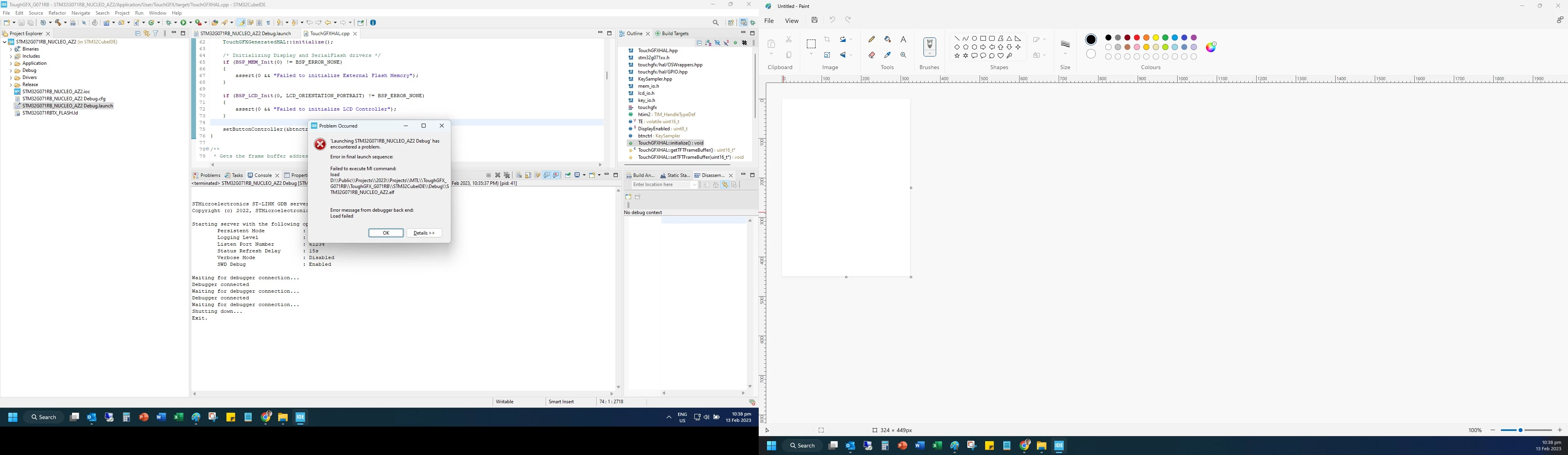

Launching STM32G071RB_NUCLEO_AZ2 has encountered a problem
Bought NUCLEO-G071RB + X-NUCLEO-GFX01M2, created a project with ToughGFX Designer. After compiled the project without errors.
But there is a "Launching STM32G071RB_NUCLEO_AZ2 Debug has encountered a problem.
Error in final launch sequence:
Failed to executed MI command:
load ...
Error message from debugger back end:
load failed.
What causes this issue?

Hello @Community member​,
That can happen sometimes with CubeIDE.
Could you try to unplug and plug again your board and try again to flash your application ?
/Yoann

I tried to plug and unplug USB cable for Nucleo board. but the issue still happen.

What happens if you choose another Toolchain ?
Go to CubeMX>Project Manager > Toolchains > EWARM and press generate code.
Then open the .touchgfx project and press generate code.
Open the EWARM project and try to compile and run.
/Yoann
