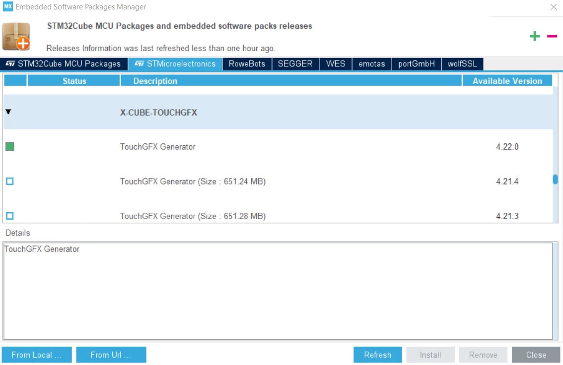

I'm running the latest release 6.9.2 of STM32CubeMx with admin rights.
When I'm going into the install/remove packages and scroll down to the X-CUBE-TOUCHGFX package, the latest release 4.22.1 does not appear, even after a press on "Refresh" button.
I exited STM32CubeMx, retried: same result. The latest package version does not appear.
In the end I downloaded the latest package from ST's website.
I guess this is abnormal, no?

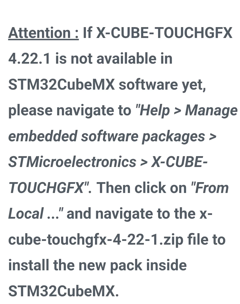

Hello @apadom
This is already mentioned in the release post of the x-cube-touchgfx V4.22.1 . You may no be able to find it yet in CubeMX. And that you should do as you have done.
Best regards.

I missed that note after the 4.22.0 release note. I only read the changes for 4.22.1... my bad.
