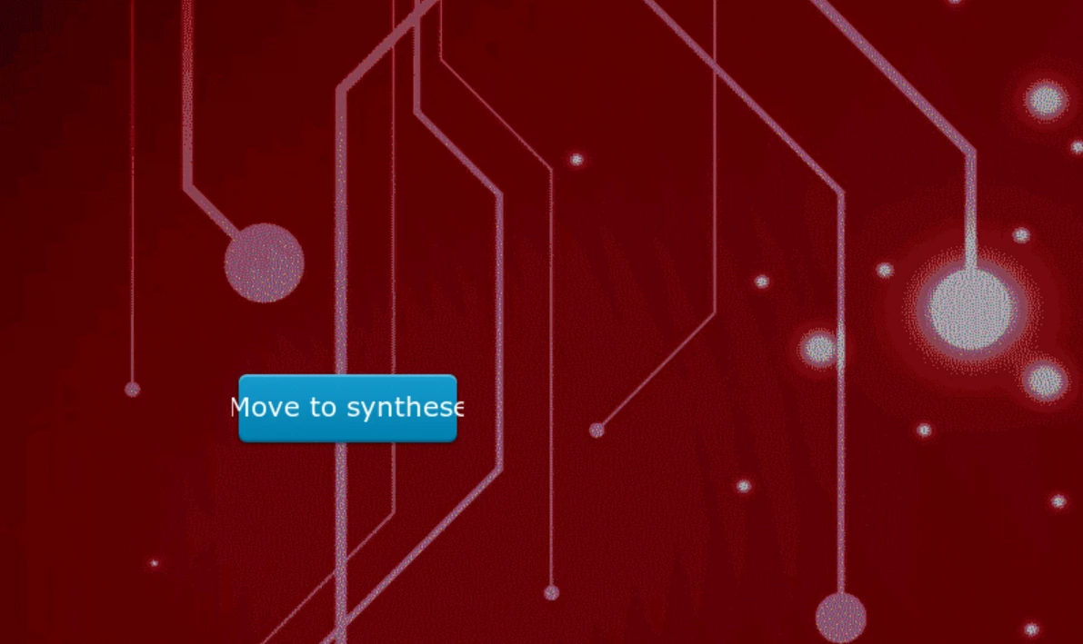

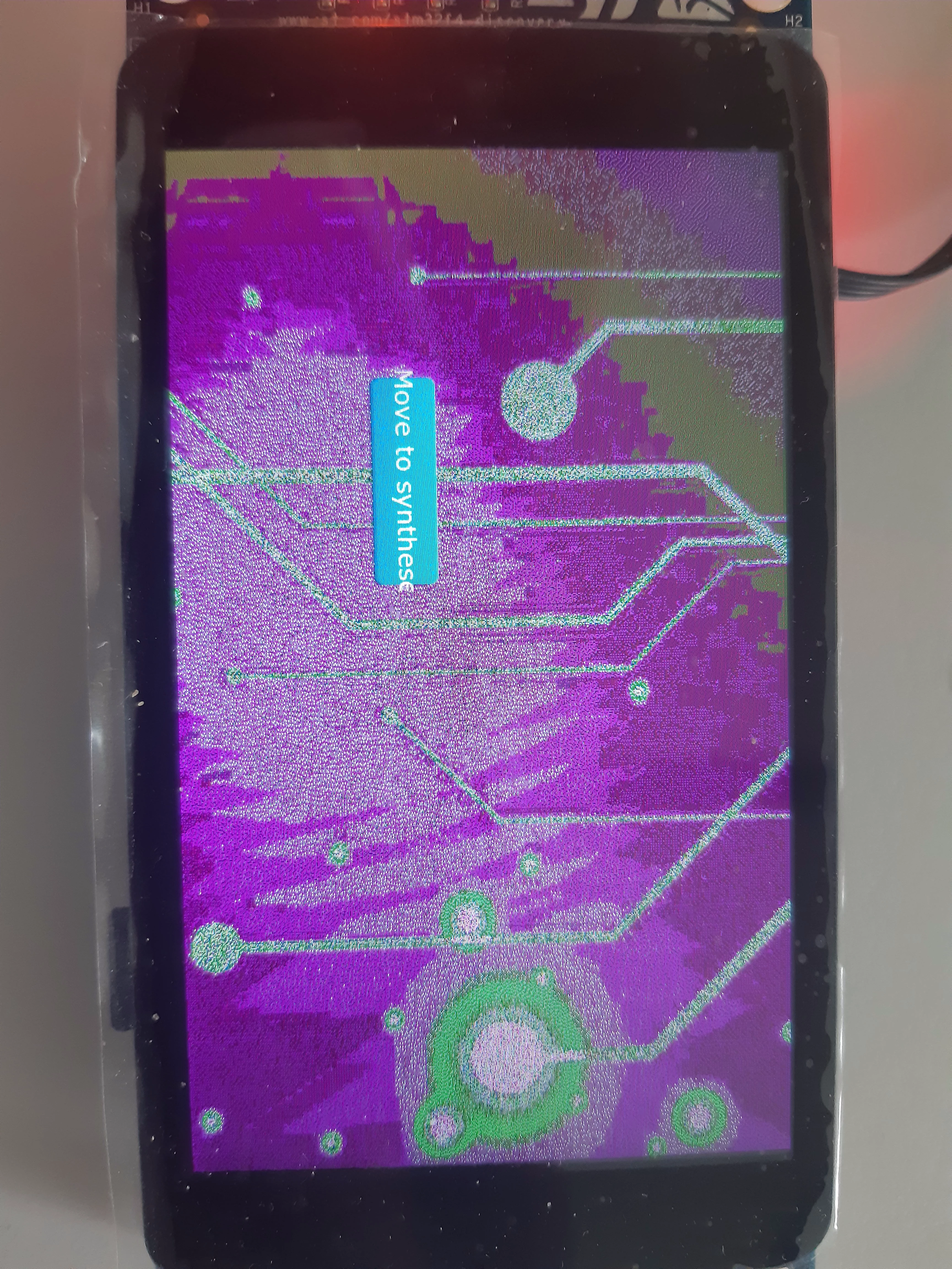

To save space on the section "ExtFlashSection" with the dev board STM32F469I-DISCO, I'm trying to use the L8_RGB565 format for my backgrounds. I'm doing this by changing the "Image Format" of all background on the "Images" section of TouchGFX Designer. This is working when I launch the Simulator but when I try actually seeing it on the board, the colors are weird like so:
Simulator:
0693W00000ANZGtQAP.pngSTM32F469I-DISCO:
0693W00000ANZHwQAP.pngHow can I solve the issue ?
Thanks in advance,

If you use a textureMapper widget instead of an Image widget the colors will be properly displayed. I will further investigate but my first guess is that this could be related to the DMA2D and ChromART. I know there has been a lot of work in the coming version 4.17 to stabilise ChromART to fix this kind of bugs.
For now I can recommend to use textureMapper widgets for the L8 images if relevant in your project.
/Romain
Romain DIELEMAN
May 10, 2021
Ok so I just tried disabling ChromART in STM32CubeMX and the L8 images are properly displayed even when using an Image widget.
So either use TextureMapper widgets or disable ChromART (which will lower the performances, but this could be acceptable depending on what you aim to do)
