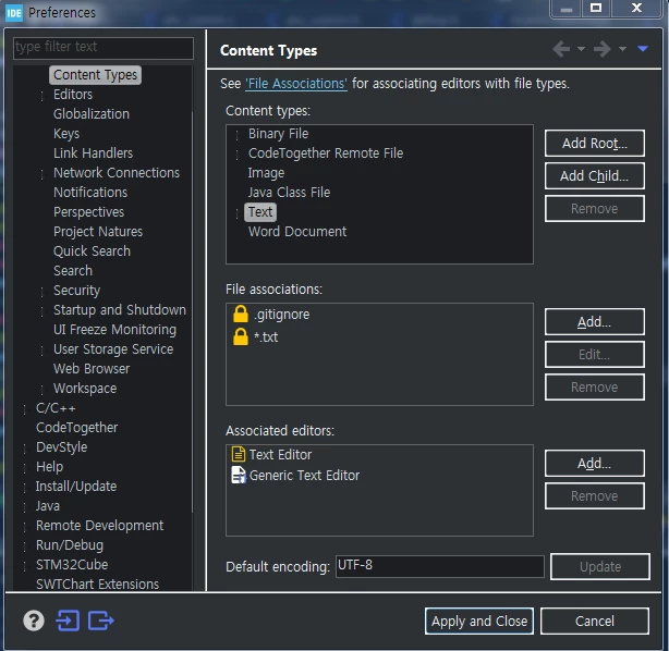

The encoding used in CubeIDE is attached as a picture file.

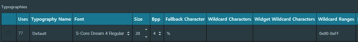

​(textArea and Typographies images are attached.)
"Unicode::snprintf(textMasterAirflowBuffer, TEXTMASTERAIRFLOW_SIZE, "STOP");" -> "STOP" is output.
Unicode::snprintf(textMasterAirflowBuffer, TEXTMASTERAIRFLOW_SIZE, "정지"); -> Fallback Character is output.
Unicode::snprintf(textMasterAirflowBuffer, TEXTMASTERAIRFLOW_SIZE, "%s", "정지"); -> Fallback Character is output.
How can I get Korea to be printed on the LCD normally?

You need to add in the Typographies settings the Korean characters or range of characters you will use (just add 정지 in the "Wildcard Characters "tab for example in your case). This step is necessary otherwise TouchGFX will just return the fallback character.
Make sure also that your font handles Korean, I used on my side the Noto Serif KR version because Verdana would not handle 정지.
