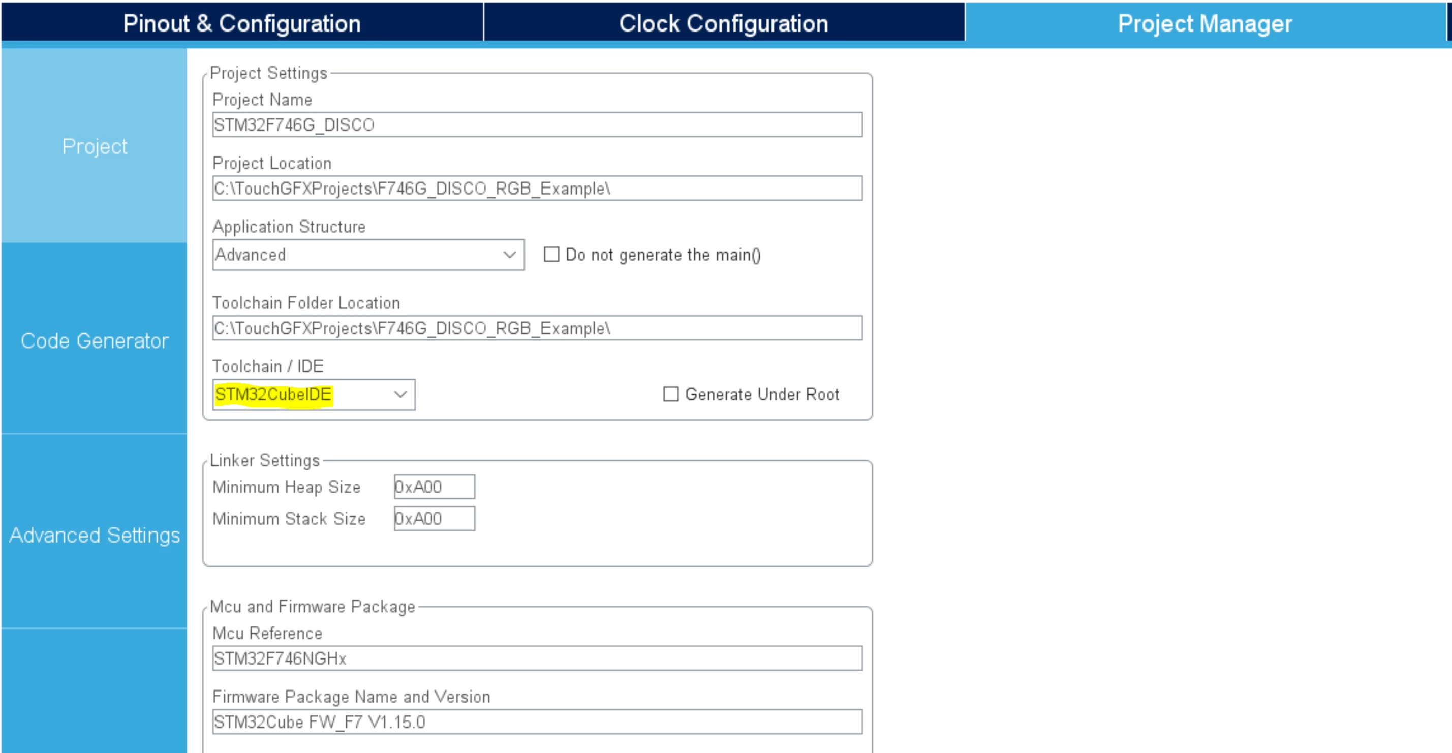

I am new to Touch GFX. I have build a GUI in touch Gfx and then generated the code.
But when I tried to compile the generated code in Keil IDE , It shows the following errors
Build started: Project: STM32F769I_DISCO

Best answer by Alexandre RENOUX
When you create a project the IDE by default is CubeIDE.
In order to make Keil compile, you need to specify in CubeMX (opening the .ioc file) the right IDE.
For that:
  • go to the Project Manager tab in CubeMX
  • Change the Toolchain/IDE into MDK-ARM (shown in the below picture)
  • Generate code from CubeMX
  • Generate code from TouchGFX Designer
  • Now you should be able to compile without errors.
/Alexandre

Alexandre RENOUX
Alexandre RENOUXBest answer
Visitor II
July 11, 2020
For that:
/Alexandre
