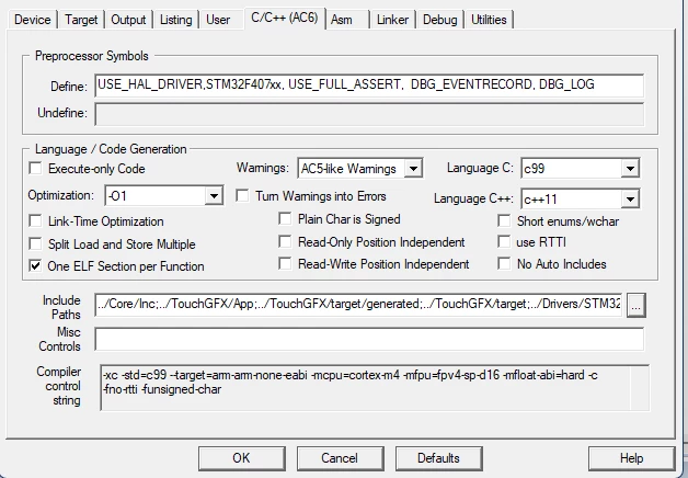

Jnevi.1
Jnevi.1Author
March 24, 2023
hi,
ok in parts this was my fault, because i added some extra flags for testing in the past which i did not remove and had just forgotten. you "have to" use the armclang compiler with the AC5-like warnings settings or you are overwhelmed by all kind of warnings. so i tried to add some extra flags which seemed to make sense to me
-fno-builtin-printf -Wall -Wpedantic -Wextra -Wshadow -fno-common -Wno-unused-parameter -Wno-nested-anon-types -Wno-c11-extensions -Wno-c++20-designator
the file i posted early was compiled with these warnings set on comand line and these are non-default settings
these are my default settings now which get with a clean keil uvision install
Without these parameters and standard config in Keil with armclang 6.16 there are less warnings (see attached file)
it is all missing override statements for tearDownScreen(), setupScreen() mostly (would still be nice to fix these)
