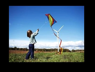

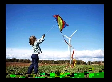

with libjpeg or using hardware in polling, mode compression works fine.
but when using DMA image is getting corrupted

Best answer by frackers
Check that the memory you use for the DMA buffers is accessible to the JPG block. I had 6 months of grief finding this out on an F7 as by default only the first 128k is in the correct cache region
2 replies
frackers
frackersBest answer
Senior
January 20, 2021

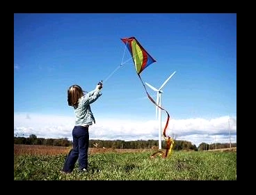

ALamb.314
ALamb.314Author
January 21, 2021
Thanks
got it working
I had to put
 SCB_CleanInvalidateDCache();
 SCB_InvalidateICache();
before dma call and removing this line "HAL_JPEG_ConfigInputBuffer(hjpeg, YCBCR_IMG, 4);" from HAL_JPEG_GetDataCallback
