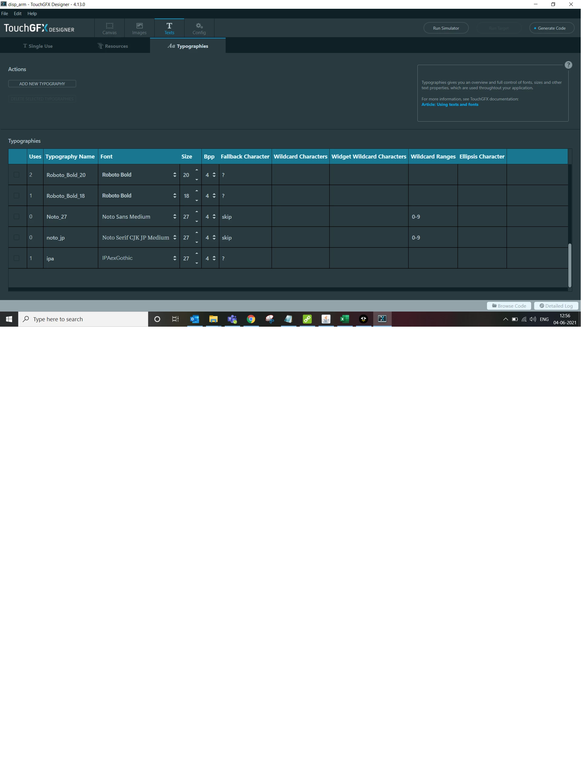

Japanese text problem.

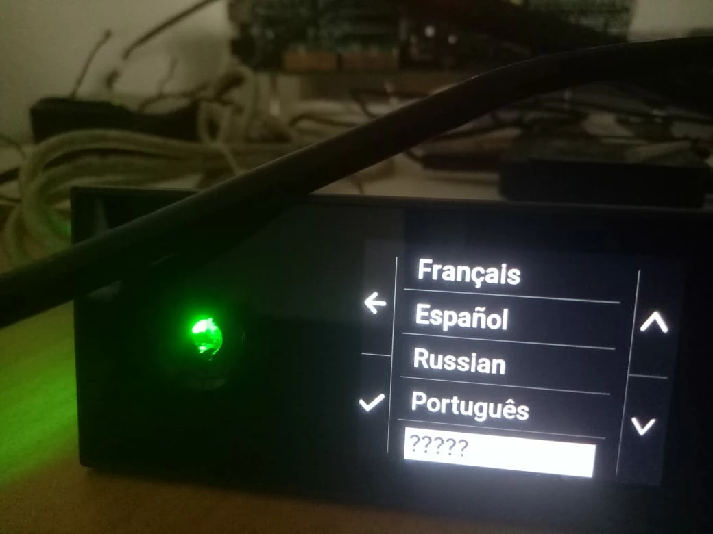

I have tried with Noto Sans, ipaexg, NotoSerifCJKjp-Medium. But still I am getting fallback character. I am using STM32H750VB. Can you please help how to fix this issue.

Problem Solved:
I was using Unicode::snprintf(textBuffer, BUFFER_LENGTH, "%s", TypedText(LCD_screen->templatesss.menu.items_text_id[i]).getText())
I replaced it with text.setTypedText(TypedText(LCD_screen->templatesss.menu.items_text_id[i])); it is working fine now.

Romain DIELEMAN
June 4, 2021

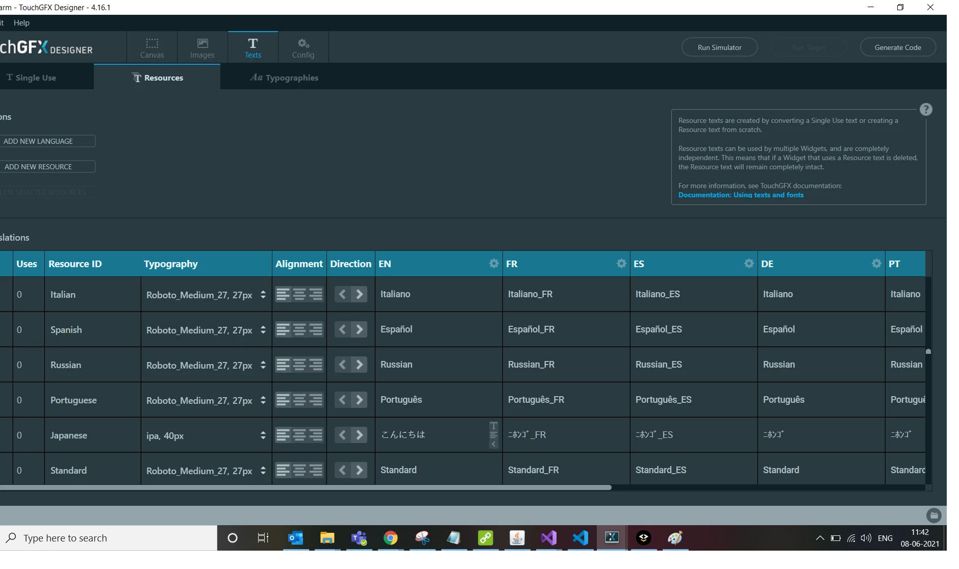

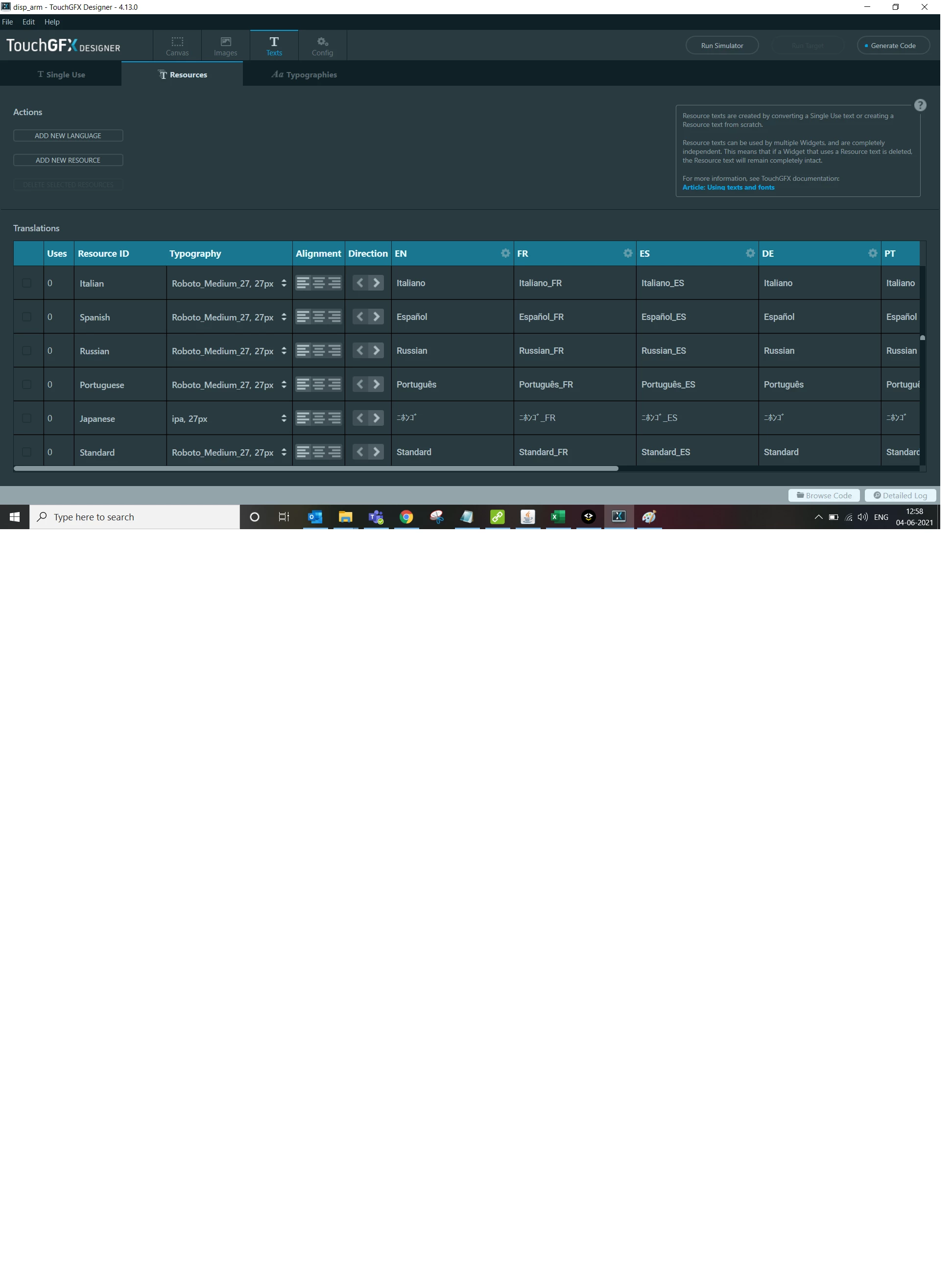

You need to add the characters you will need in the wildcard range or wildcard characters in your second screenshot.
/Romain
RG.3
RG.3Author
June 4, 2021
for Japanese what is the range?
I tried 0x0000-0x33FF.But still it is not working. Unicode - Hiragana falls between 0x3040 to 0x309f.
Romain DIELEMAN
June 7, 2021
When in doubts you can just add the characters you will use (just write the same text as in the textAreas you are using, not need to put the unicode) in the "wildcard characters" section. Noto Sans seems to not handle Japanese correctly, or maybe it is just the ttf I found online.
/Romain

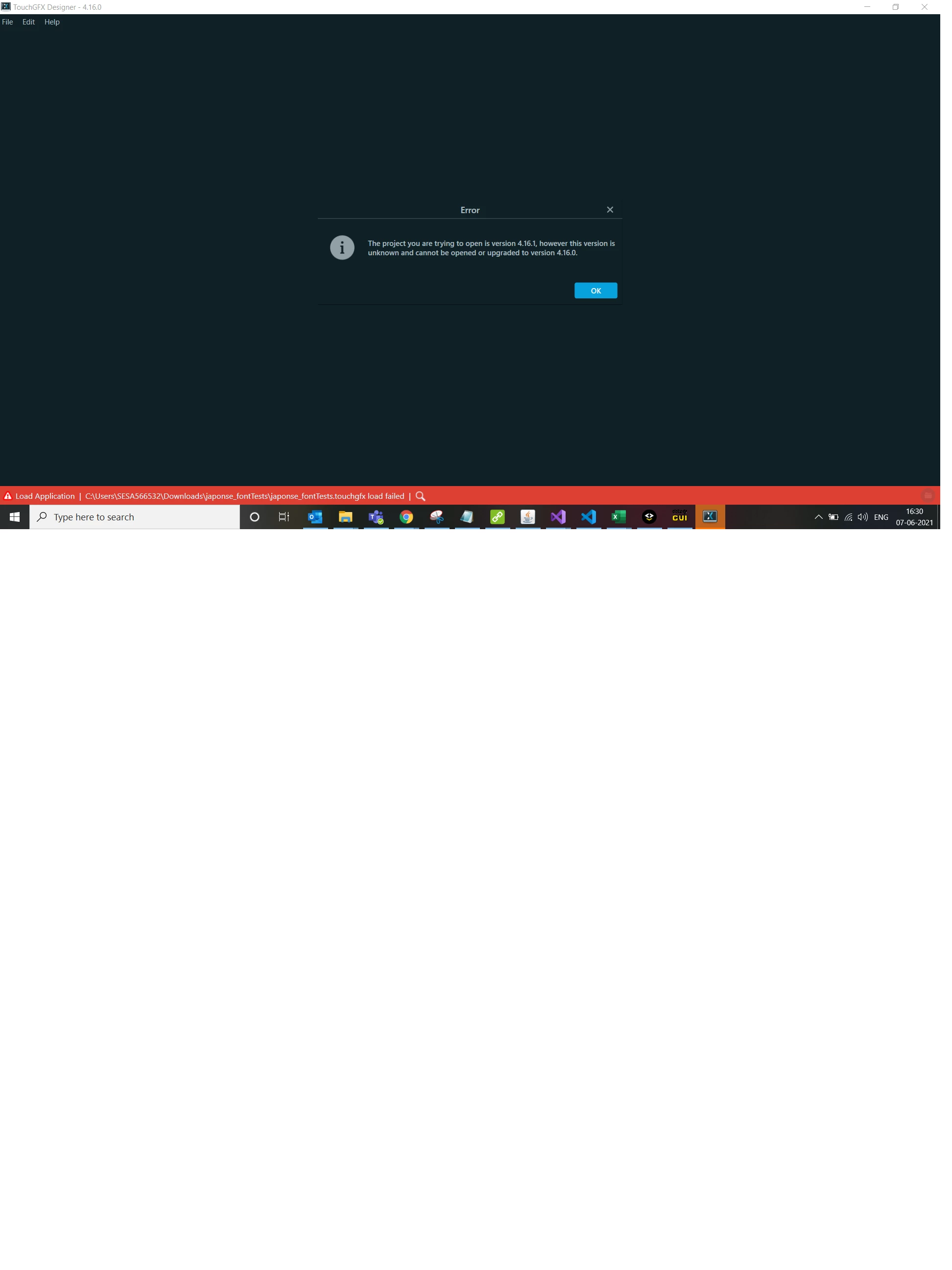

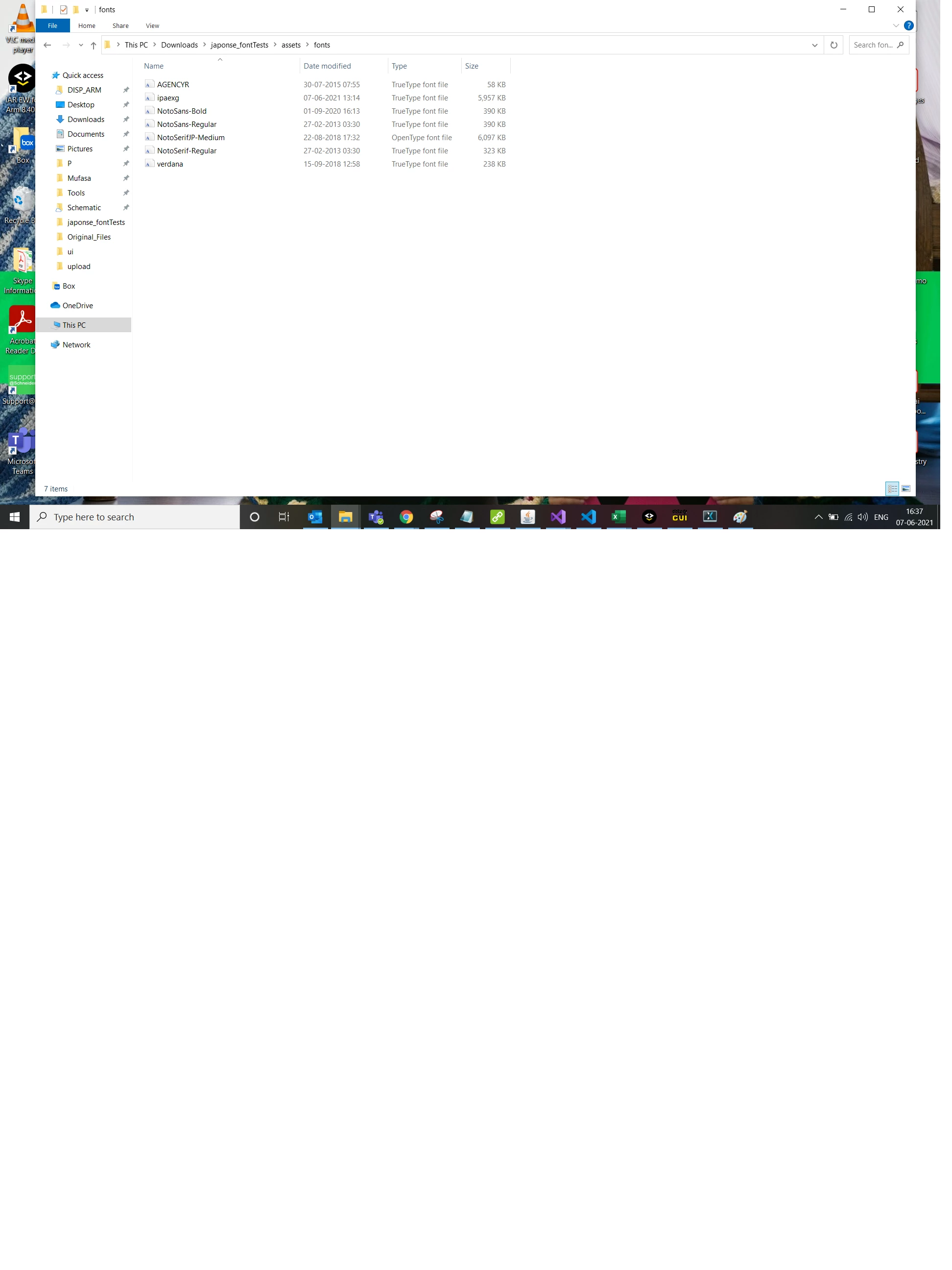

I am getting this error when I tried to open the file. I am able to download only 4.16.0 I could not able to download 4.16.1
0693W00000BaH4VQAV.pngoutof these fonts which one I Have to use
Romain DIELEMAN
June 7, 2021
you can download TouchGFX 4.16.1 from STM32CubeMX or from this link : https://www.st.com/en/embedded-software/x-cube-touchgfx.html

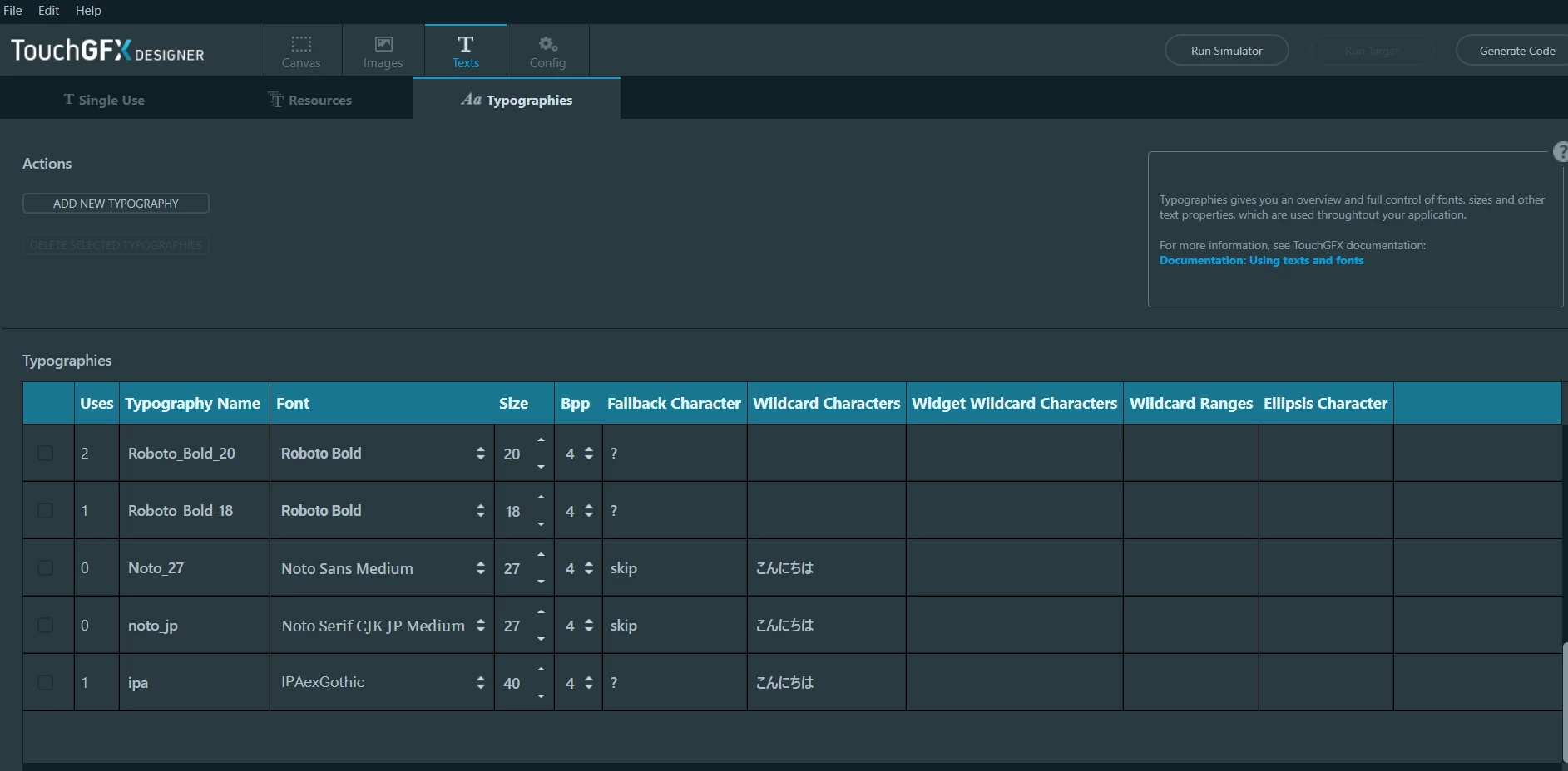

I tried with same fonts and same text...But Still I am getting the fall back character.
Romain DIELEMAN
June 8, 2021
could you share the text you are trying to display and the font you are using ? In your last screenshot you can see a small T icon in the first Japanese message under the EN tab, could you check that you are using the right font there ?
/Romain

June 8, 2021
In textsTobeDisplayed you can find the Text and in japanesefonts you can find the fonts that are used.
RG.3
RG.3AuthorBest answer
June 16, 2021
Problem Solved:
