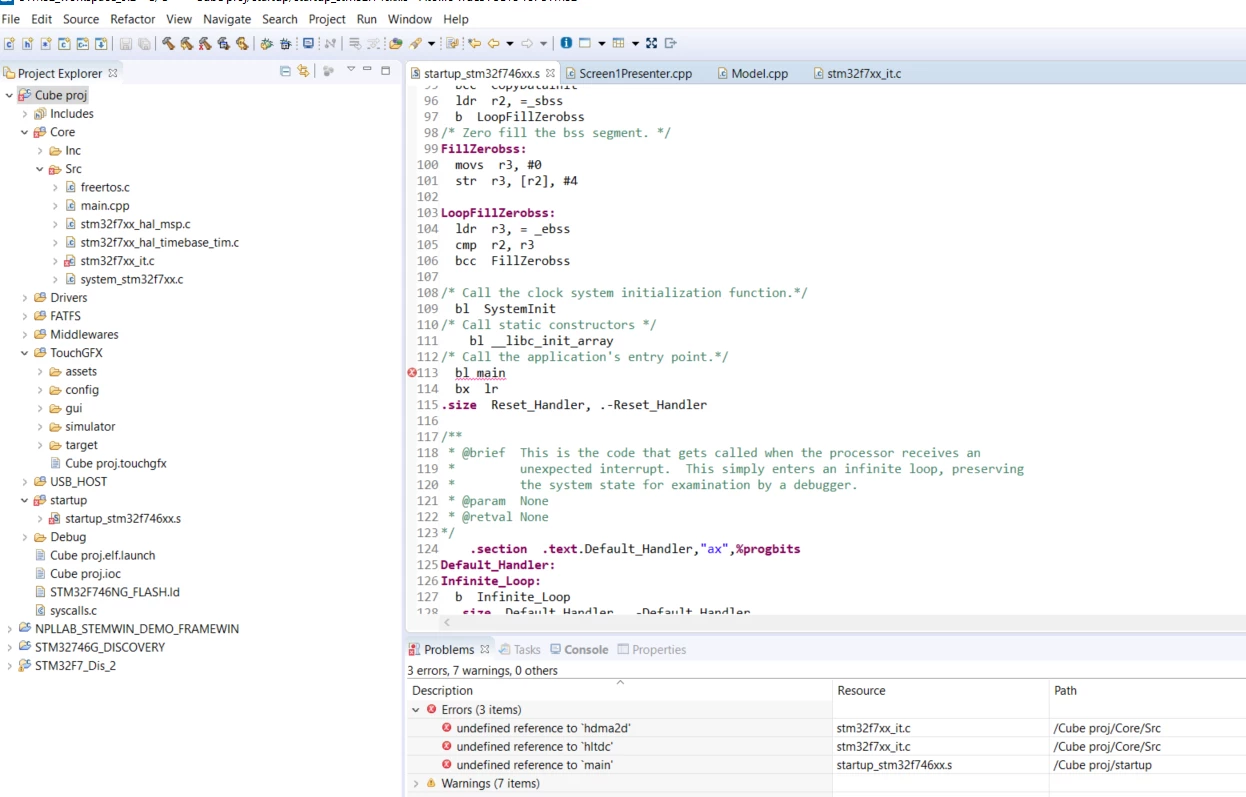

I am having same problem. Please see attached. I am trying to generate a project via Cube MX for Attolic True studio with Touch Gfx interface. I am using STM32F746G-DISCO board. Any ideas where things are going wrong?
Thanks for the help.

Mon2
Senior III
Apr 13, 2019 5:37 PM UTC
Hi @zul-a​ , I am in Hong Kong at this time and do not have full remote access to my lab setup so here are some quick comments:
1) The tool integration is broken so you are facing the observed issues
2) Review the following possible work arounds (in no particular order of preference):
Plan A:
Review the following webpage:
https://community.st.com/s/question/0D70X0000076dLS/guides-for-using-touchgfx-410-with-cubemx-50-known-limitations?s1oid=00Db0000000YtG6&s1nid=0DB0X000000DYbd&emkind=chatterCommentNotification&s1uid=0050X000007vr0X&emtm=1550748757318&fromEmail=1&s1ext=0
and note specifically that you must select V2.0 template from the TouchGFX toolchain.
For this method, you are launching the Touchgfx toolchain FIRST -> select v2.0 template for this target kit -> create your GUI -> compile and test with the simulator -> reflash your target kit and verify it works correctly.
Then proceed to locate the file folder built from this toolchain and launch the CubeMX tool. Suspecting that any code wizard use inside CubeMX will currently break the generated code so you must review the following to fix the broken code:
For use with IAR & STM32F746 Discovery Kit:
https://touchgfx.zendesk.com/hc/en-us/articles/360019884752-Configuring-STM32F746G-DISCO
PS: Do try to run with IAR (if you have it as-is before fixing the code using the above link).
From our experience of investing about a month into these tools with daily long hours, IAR is the most stable compiler to use for integrating these tools till all is fixed by ST in the future.
Plan B: Review the notes from @BBenn​  on how to use the same kit with Atollic on the same landing page.
Plan C: Review the document from @Clark Sann​ on how to get this kit working using the SW4STM32 compiler:
https://community.st.com/s/question/0D50X0000AAHSjZSQX/how-to-get-a-working-touchgfx-project-working-with-stm32f746gdisco-board-and-sw4stm32
As noted a few times, the forum search engine requires some improvement to locate some of these gems of articles.
Hope this helps.
PS: For future readers, please post your update on using this kit and resolution.

MVill.11
Visitor II
Oct 14, 2020 3:05 AM UTC
If you want to use cpp, do not forget to select cpp when using STM32CubeMX for the Target Languge. If you forget to select cpp and rename main.c to main.cpp , then you will get "bl main" error.

MVill.11
Visitor II
Oct 18, 2020 4:25 AM UTC
 This problem appears when main.c is changed to main.cpp and error is reported in file “startup_stm32f411ceux.s�? bl main (simply, main.cpp is ignored)
Also it appears randomly (on/off) when creating a new project from File→New→STM32 Project from an Existing STM32CubeMX Configuration File (.ioc). I was fortunate to have one project without the problem (original) and one generated with the .ioc file.
After swapping all files from the good project to the bad one, the problem got fixed when I changed the “.project�? file.
I copied all files from one project to the other directory by directory, but when I copied “.cproject�? , “.mxproject “and “.project�?, I opened these files with a text editor and edited the correct name in all locations needed for the project, before testing.
I found out the bad “.project�? file was missing <nature>org.eclipse.cdt.core.ccnature</nature> in line 25 in the file and when I added this line, the problem went away
In my opinion this problem is created when STM32CubeMX first creates the project and misses this line, randomly.
Note that I made sure that I selected the cpp option before creating the project.
I hope this helps,
Miguel
Visitor II
Oct 30, 2023 4:50 PM UTC
I have the same problem, have to create a second main in .cpp to use with CppUTest (i disable the other one in the build configuration)
" ../Core/Startup/startup_stm32h733zgtx.S:99: undefined reference to `main'"
In the .S startup file :
/* Call the application's entry point.*/
 bl main
main is undefined.
My .project seems fine (i have the ccnature) :

Tesla DeLorean
Guru
Oct 30, 2023 4:53 PM UTC
For C++ / .cpp you need to be aware of Name Mangling
If you want C / Assembler linkage use extern "C" to ensure the name is visible in the name space.
