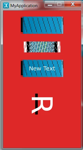

TouchGFX Simulator
The simulator did function correctly in portrait when adding the following to its main.cpp file:
HAL::getInstance()->setDisplayOrientation(ORIENTATION_PORTRAIT);
However, items are distorted on the simulator:
0690X00000AtPEwQAN.pngThis is what it looks like in the Designer:
The "R" is an Image widget I added.
The target shows the same thing as the image above (after editing the BoardConfiguration.cpp file).
Is there anything I can do to fix the distortion of the widgets?

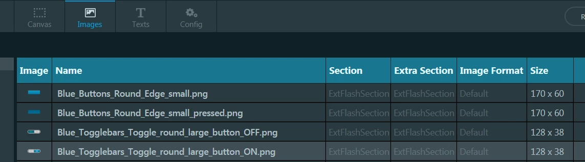

Further experimenting helped me find an answer to this. Hopefully it will help anyone else that is having issues with Display Orientation.
Go to the Images tab in the Designer:
In the right margin set the Layout Rotation to 90:
And it fixes my issue:

Dec 6, 2019 7:00 PM UTC
I was able to fix the "R" image by appending ".90" to the image file name prior to adding to the Designer. The article says in the "Switching Dynamically at Runtime" section that this can be done so that the image will be rotated 90 automatically.
