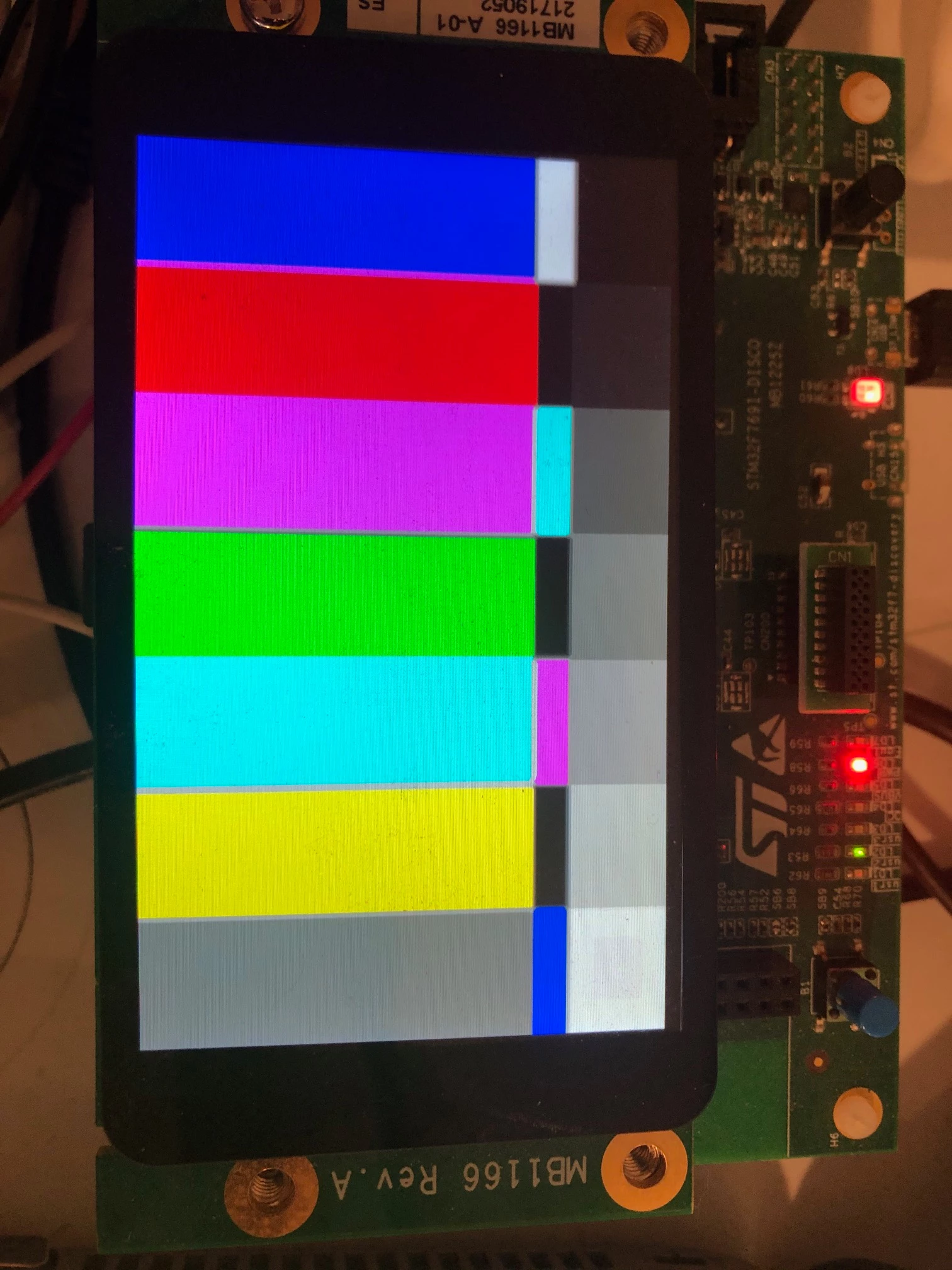

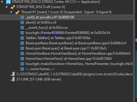

I followed this guide to changing the pixel format of an application. Although my TouchGFX designer file does not have the code listed above the framebuffer pixel format table 2/3 of the way down the page, in the Designer itself it reports 16bit color and RGB565. However, when I build and run my application, the screen appears corrupted and then freezes. The stack trace is attached, but it appears that during the constructor call of one of my custom containers, a PainterRGB888 reference is called and an assertion fails(?), hanging the program.
If I make a simple screen that doesn't have that custom container, the display still corrupts though it doesn't seem to crash.

Apologies for the late reply - this issue fell off my radar while I was working on other parts of my application. The procedure you described works but causes graphical glitches when TouchGFX is configured to use ChromArt. Especially in areas of transparency, elements below appear to "bleed through" the higher level elements. Disabling ChromArt seems to solve the problem, albeit at some performance cost in certain situations.
Any ideas related to ChromArt? I've tried with the original application template settings, as well as the settings listed in the board bring up documentation (https://support.touchgfx.com/docs/development/board-bring-up/how-to/08-hardware-acceleration) and both result in the same issue.

In addition, I was using a Painter888RGB in one of my customer containers, which was the actual root cause of the particular assertion failure shown in the stack trace in the OP. Replacing it with a Painter565RGB resolved that particular issue.
