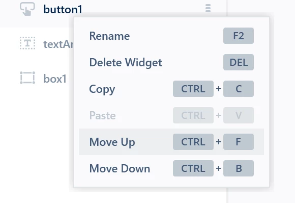

Issue: Widget overwritten.
For example, I create 2 widgets (button and box), the box in top and button in bottom.
I need to change their position like picture 2, how can I do except delete and rebuild to changed their order ?

Yoann KLEIN
Aug 12, 2022 7:53 AM UTC
Hello @V.H​ ,
In the Screens menu, you can simply right click on the widget you want to put on foreground, and then select the "Move Up" option :
0693W00000QNYdaQAH.pngPlease not that you can also do the same with background, if you select "Move Down".
Hope that this answers the question,
/Yoann

V.H
V.HAuthor
Senior
Aug 12, 2022 8:12 AM UTC
Thanks for your reply.
Does the API have this function? I want to do this movement in the firmware.
Yoann KLEIN
Yoann KLEINBest answer
Aug 15, 2022 9:55 AM UTC
Unfortunately this function is not implemented in the API.
But, there is a little work-around you can use if you want to do that :
  • First, programmatically remove your widget from your container (in your case, the Screen)
  • Then, insert your widget before/after the other widget to show it on foreground or background on your interface
The code could look like that :
void Screen1View::changeWidgetPosition()
 remove(box1);
 insert(&button1, box1); // insert the box below the button
/Yoann
