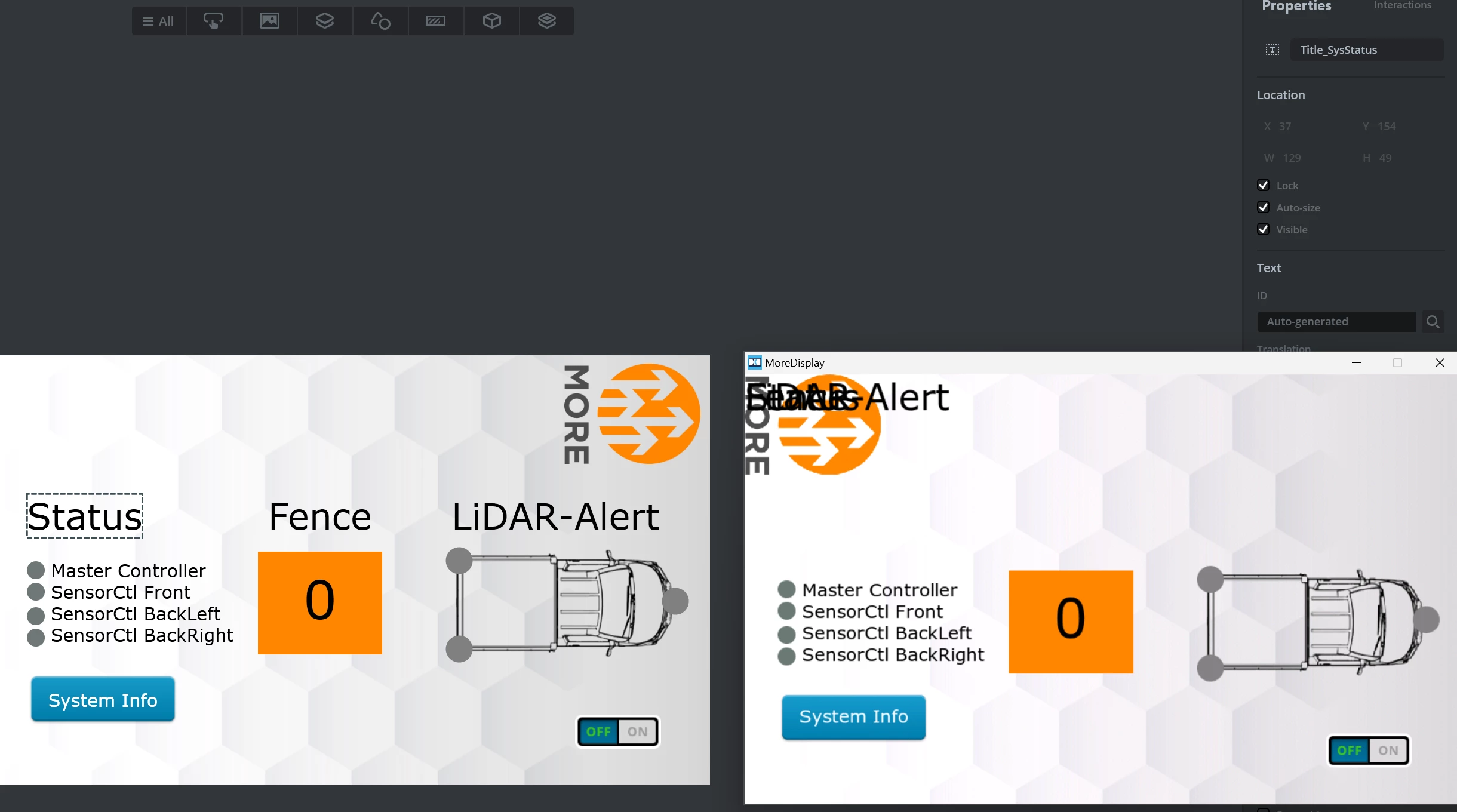

Issue: locked Elements don't stay where they are
After update TouchGFX 4.20.0 to 4.21.0, all fixed element on the screen don't stay where they are meant to be. I post the following image, in which the Text element and MORE-logo element are locked. But after simulation these elements are all arranged to the left up of the page. 0693W00000Y7UVJQA3.pngIf I unlock those elements, there is then no such problems. How does that come?

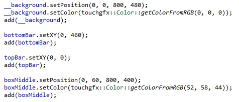

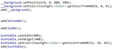

I just updated to 4.21 and also encountered this bug. I have some "background" items that I have set to locked in the designer - they are all at the wrong position. Seems that the constructor of the views baseclass does not set the origin of an item when it's locked. Screenshots of the generated code attached.
 bottomBar, topBar and boxMiddle unlocked:
bottomBar, topBar and boxMiddle locked:0693W00000Y7pV0QAJ.png
