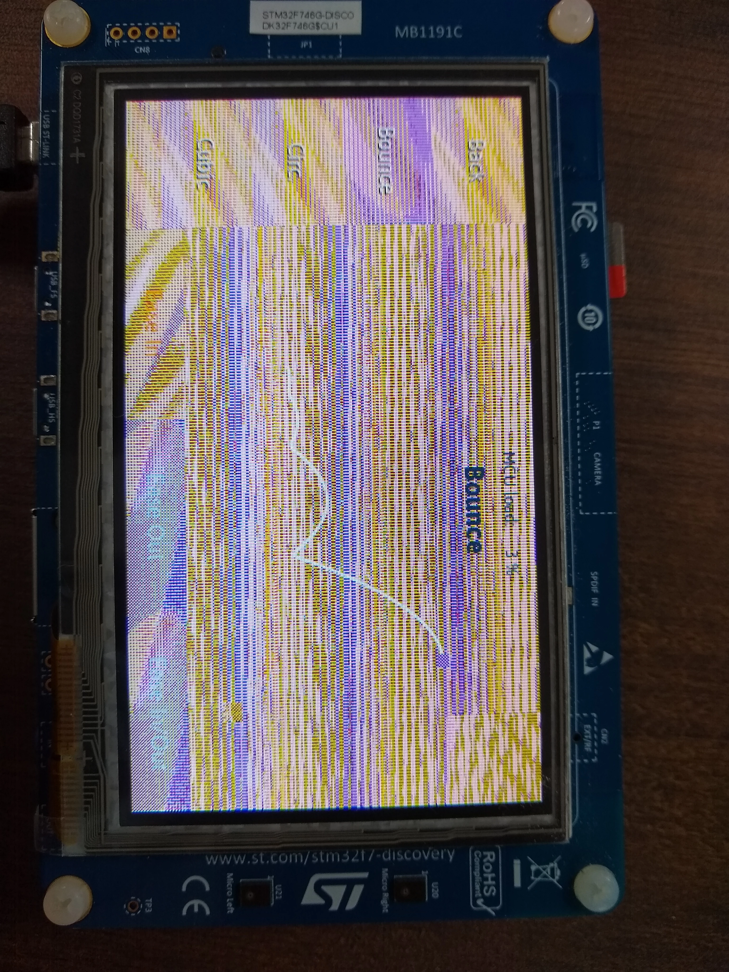

Issue in Display programs on STM32F746 Discovery Kit.
  • April 27, 2021
  • 1 reply
  • 1358 views

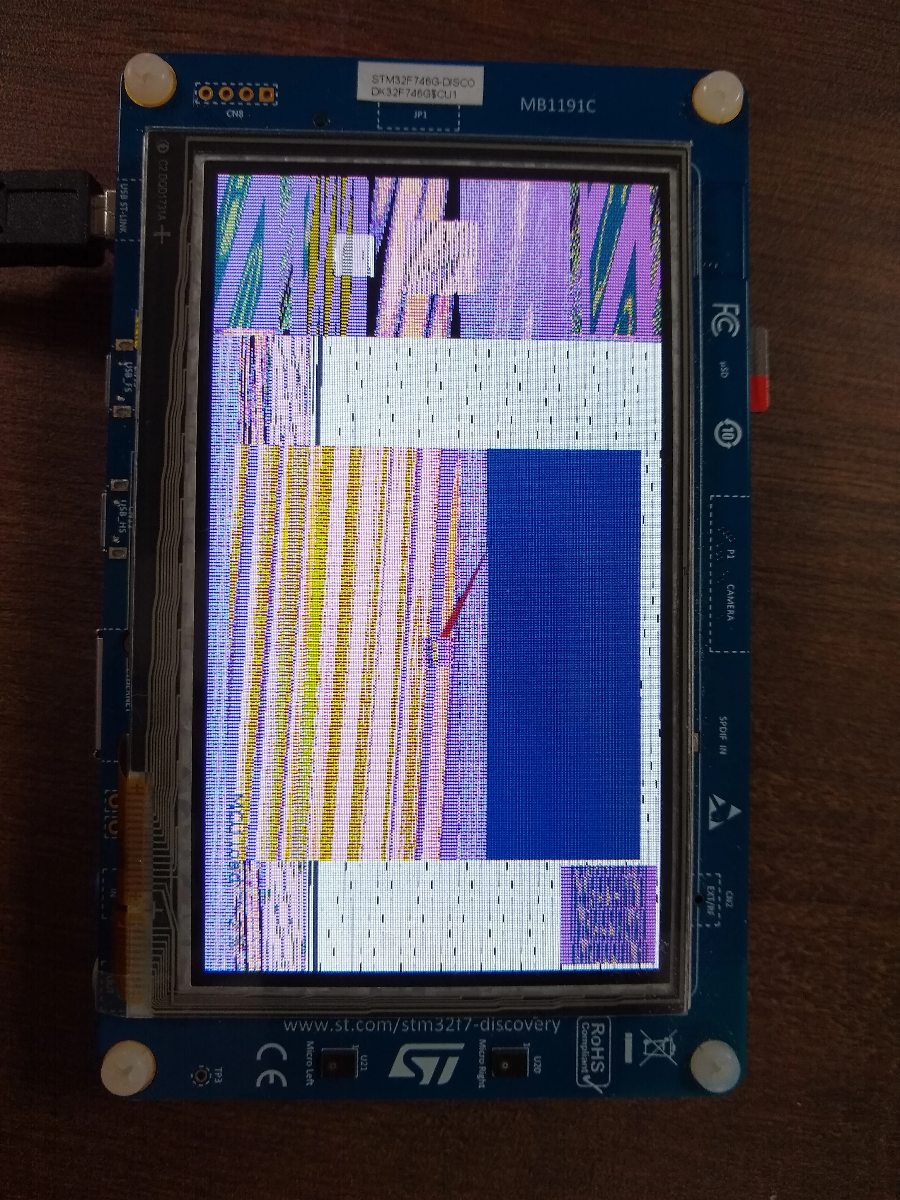

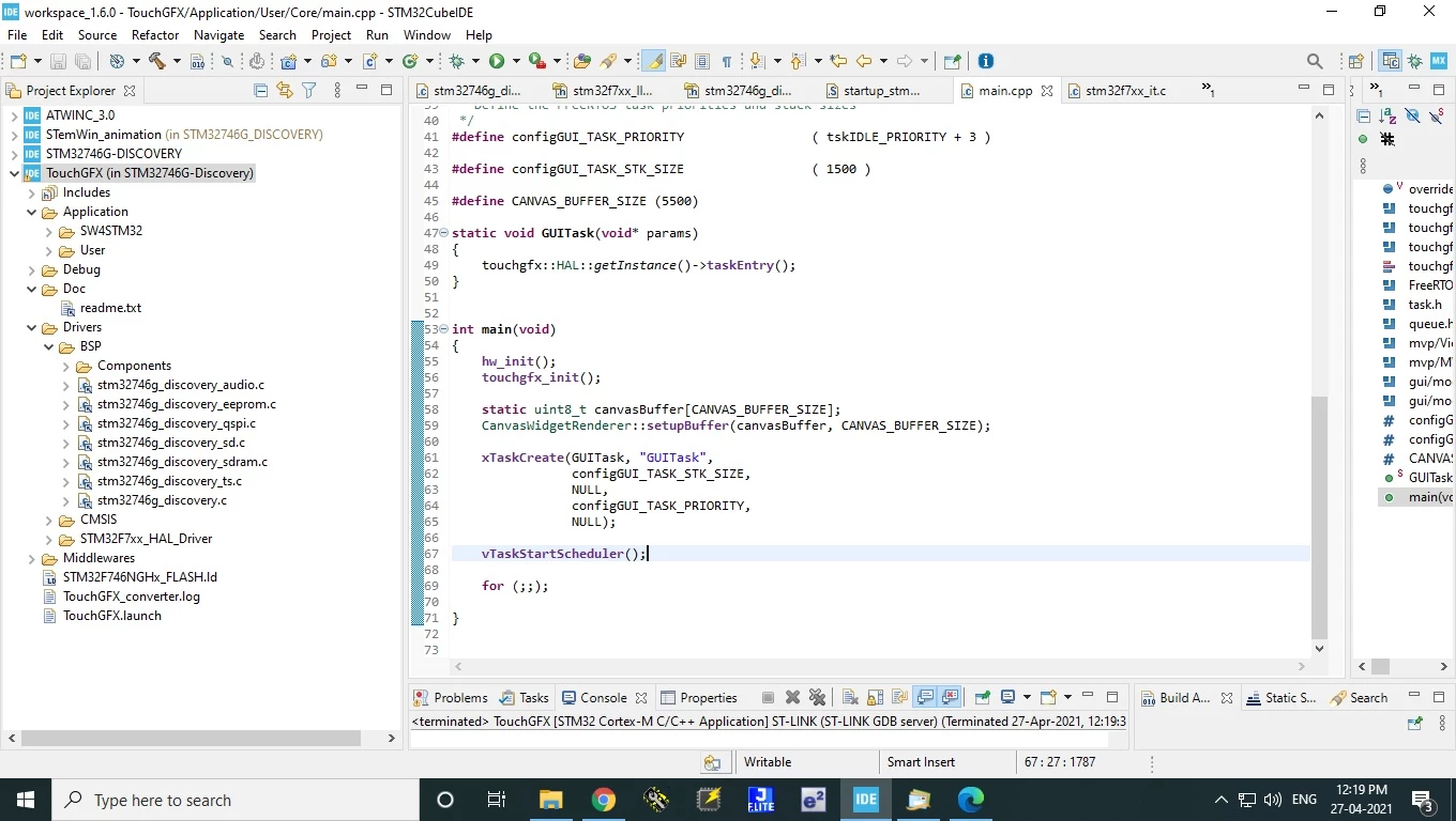

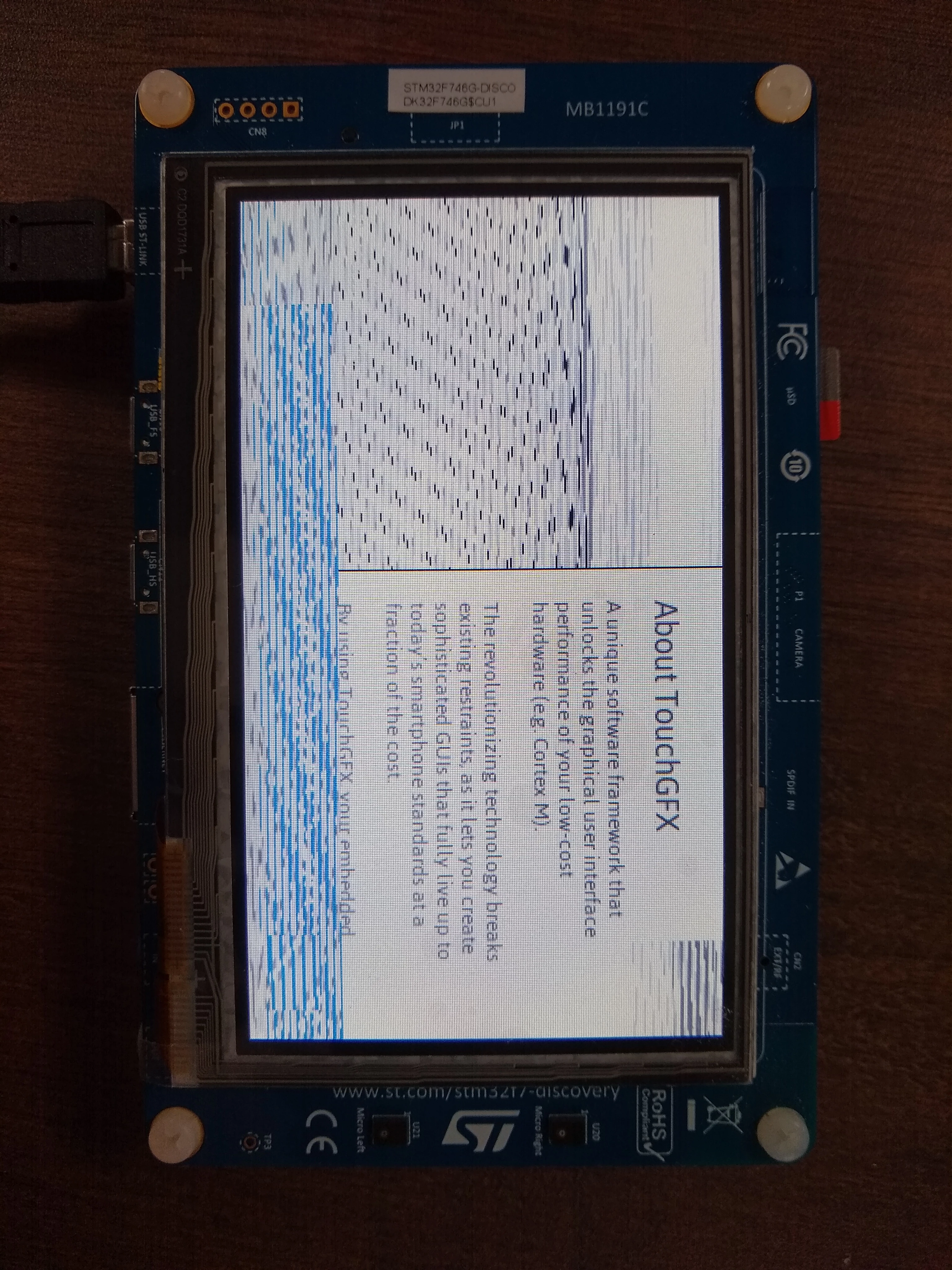

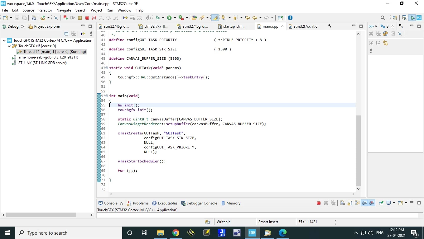

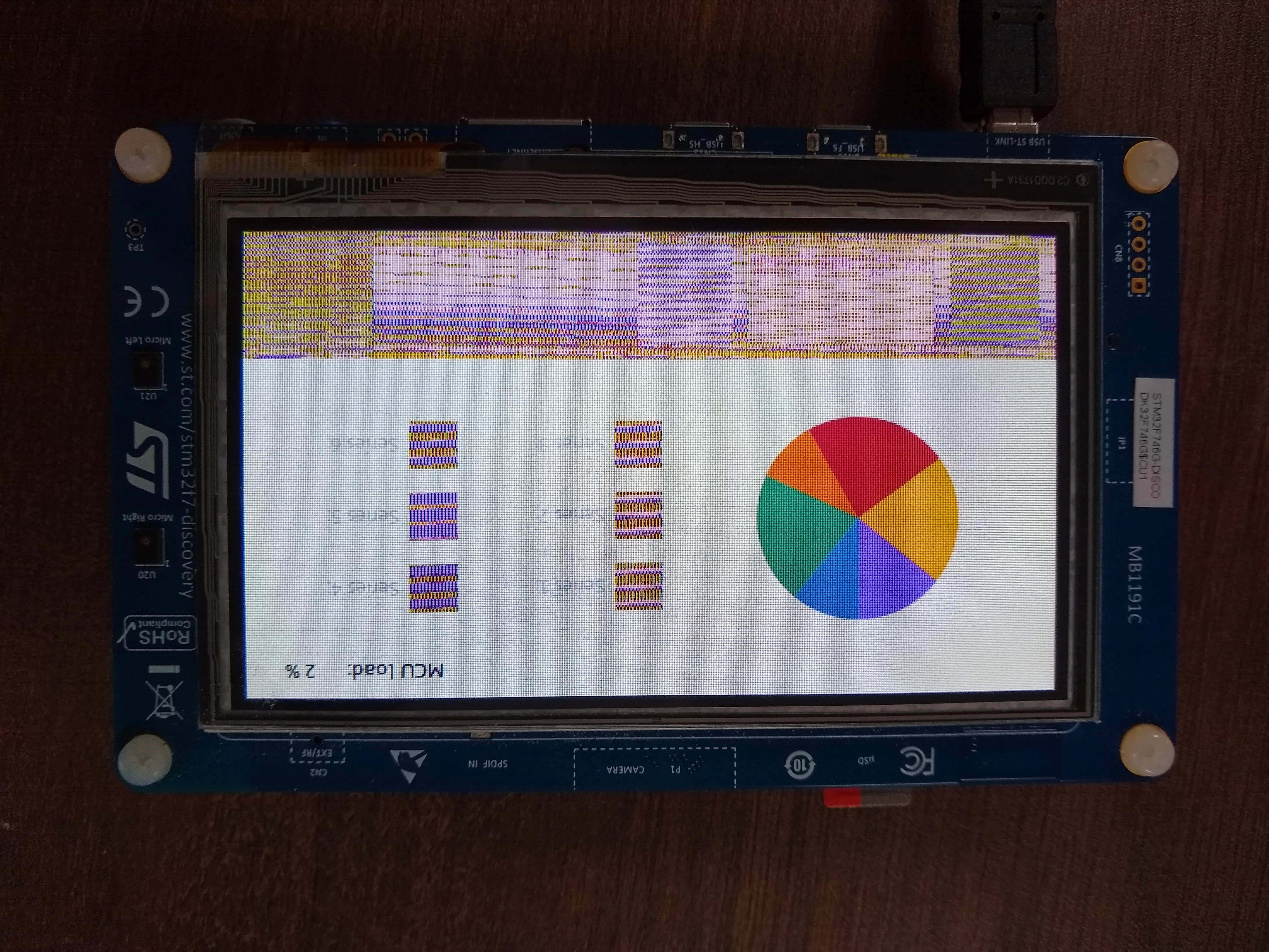

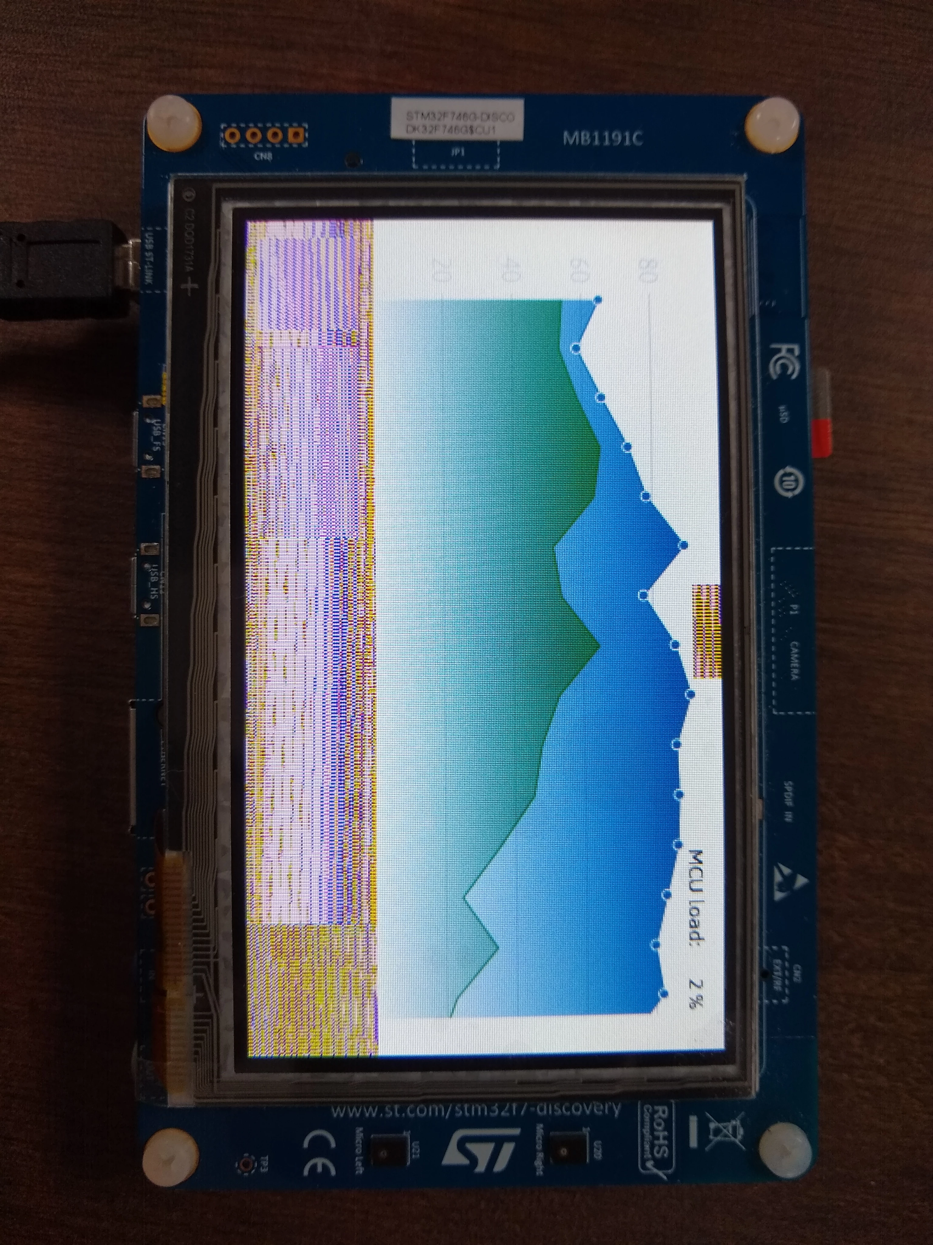

Dear Sir,
We have STM32F746 Discovery Kit.
We are trying to study STM32 with given example for STM32F746 Discovery Kit.
We run the TouchGFX application on this board.
We observed that TFT screen displayed on TFT are wrong.
I attached screen and photos for your referance.
Requested you to do needful to solve the issue.

Your portrait landscape setup in designer need set images default angle 90 or manualy on images management screen... Know bug ...
