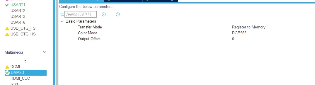

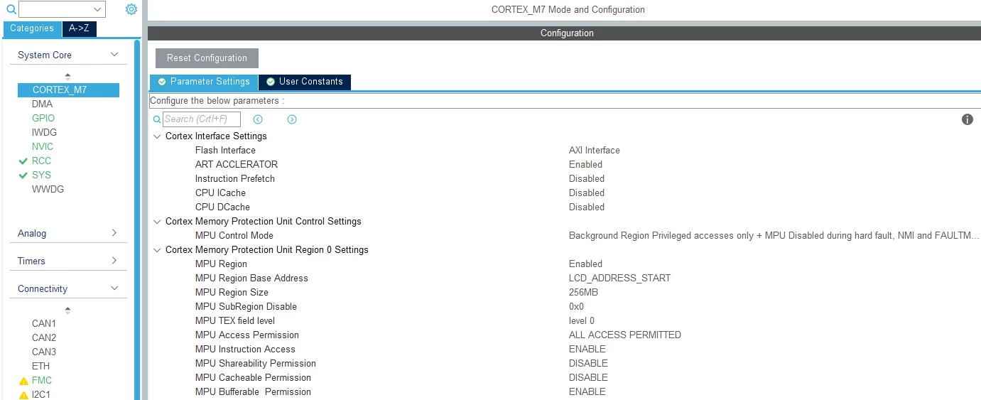

I use CubeMX to construct a project for RGB LCD in a STM32F767 custom board.
MPU is enable, and is set as follow

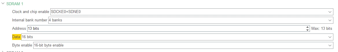

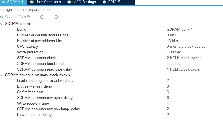

0693W000008xjrPQAQ.pngSDRAM is used and FMC is set as :
0693W000008xjroQAA.png​0693W000008xjrpQAA.pngDMA2D is actived and set as :
0693W000008xjsIQAQ.png​

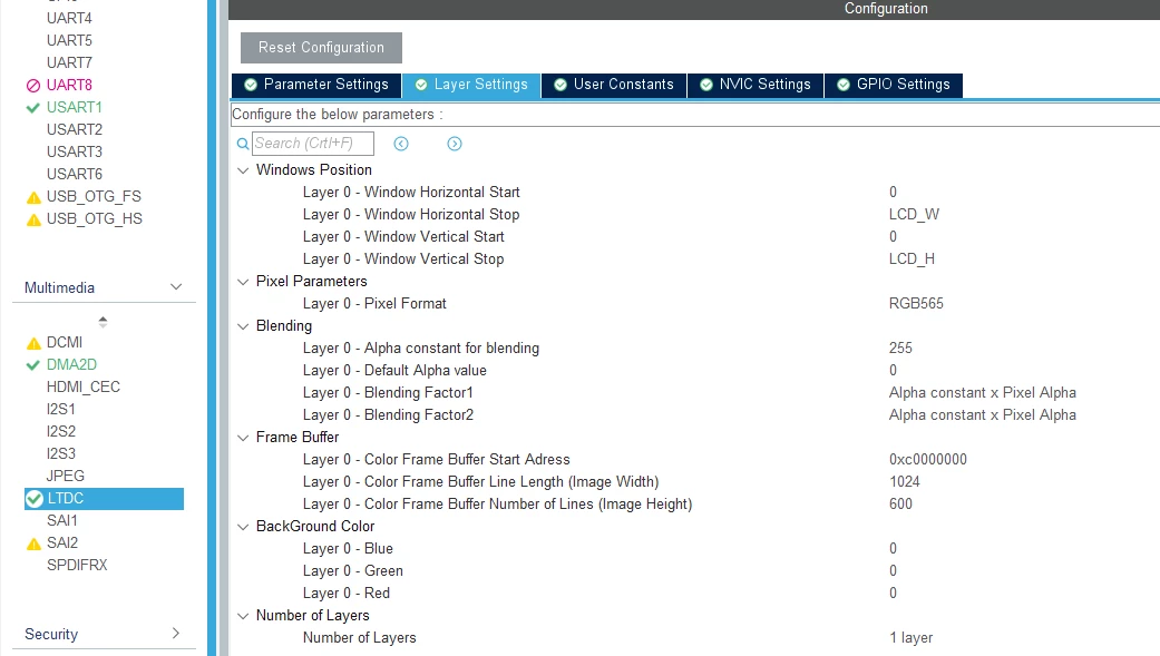

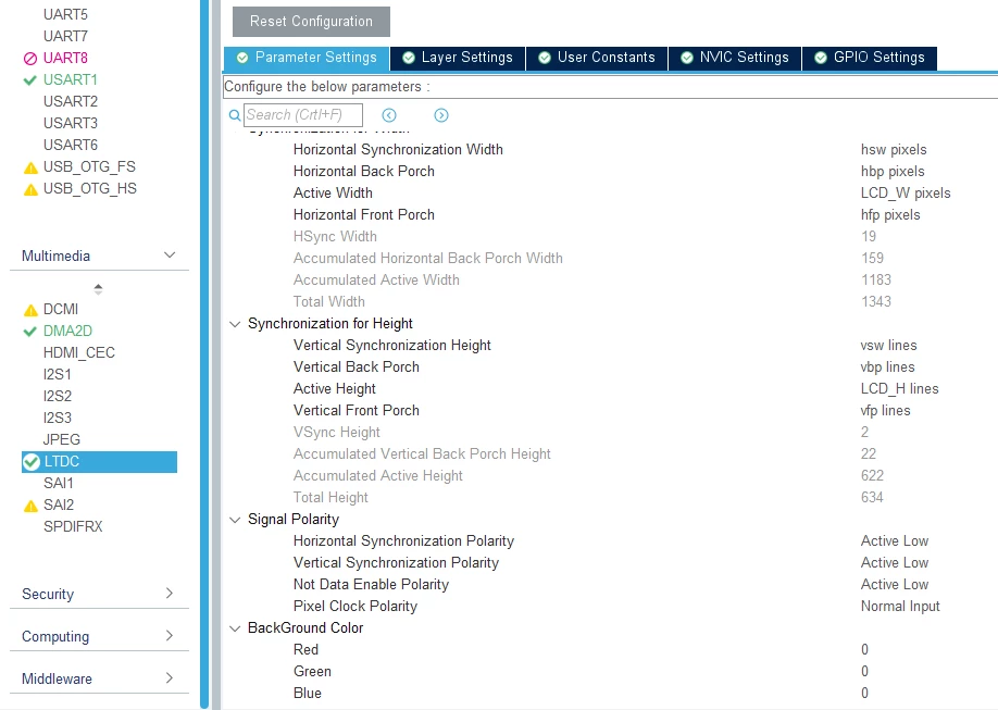

the LTDC is set as :
0693W000008xjswQAA.png ​0693W000008xjt1QAA.png​The following code is used to fill the LCD with color :

At the first call, the DMA2D is stop via set DMA2D->CR as 0x30000 and then set the DAM2D parameter, start the DMA2D via set DMA2D->CR as 0x30001, but timeout in data transfer finally.
At the second call, the DMA2D can not be stop via as DMA2D->CR as 0x30000, is always in start siutation, and can not be set as 0x30000 to stop the DMA2D. I suspect that the data can not be transfered and causes the DAM2D to be died, but I can not find the reason.
I have checked the other setting such as GPIO and clock with the driver provided via custom board vendor that can run correctly.
Could anyone give me suggestion? Thank for your help! best wishes.
