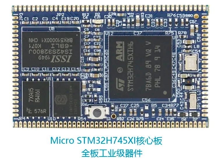

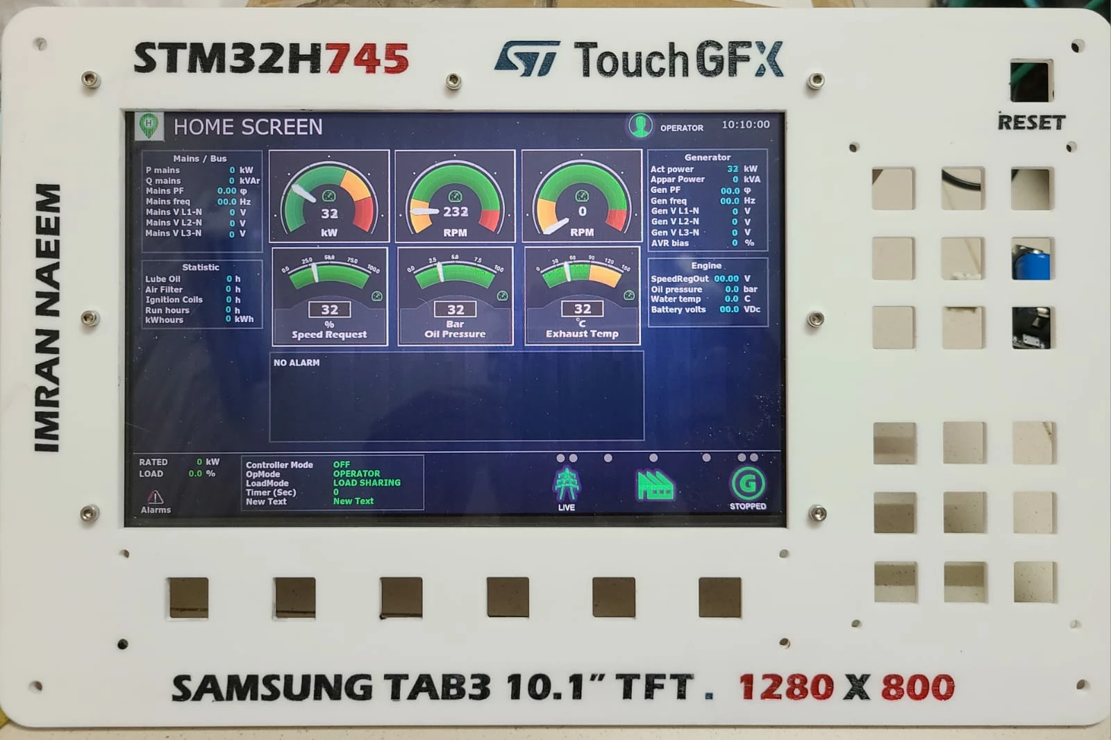

Hi @Shivani
I am using STM32H745XIH6 and various TFTs from low to High resolutions , mostly LTDC/RGB interface.
following SOM i used for my present TouchGFX experiment.
8)8)8)

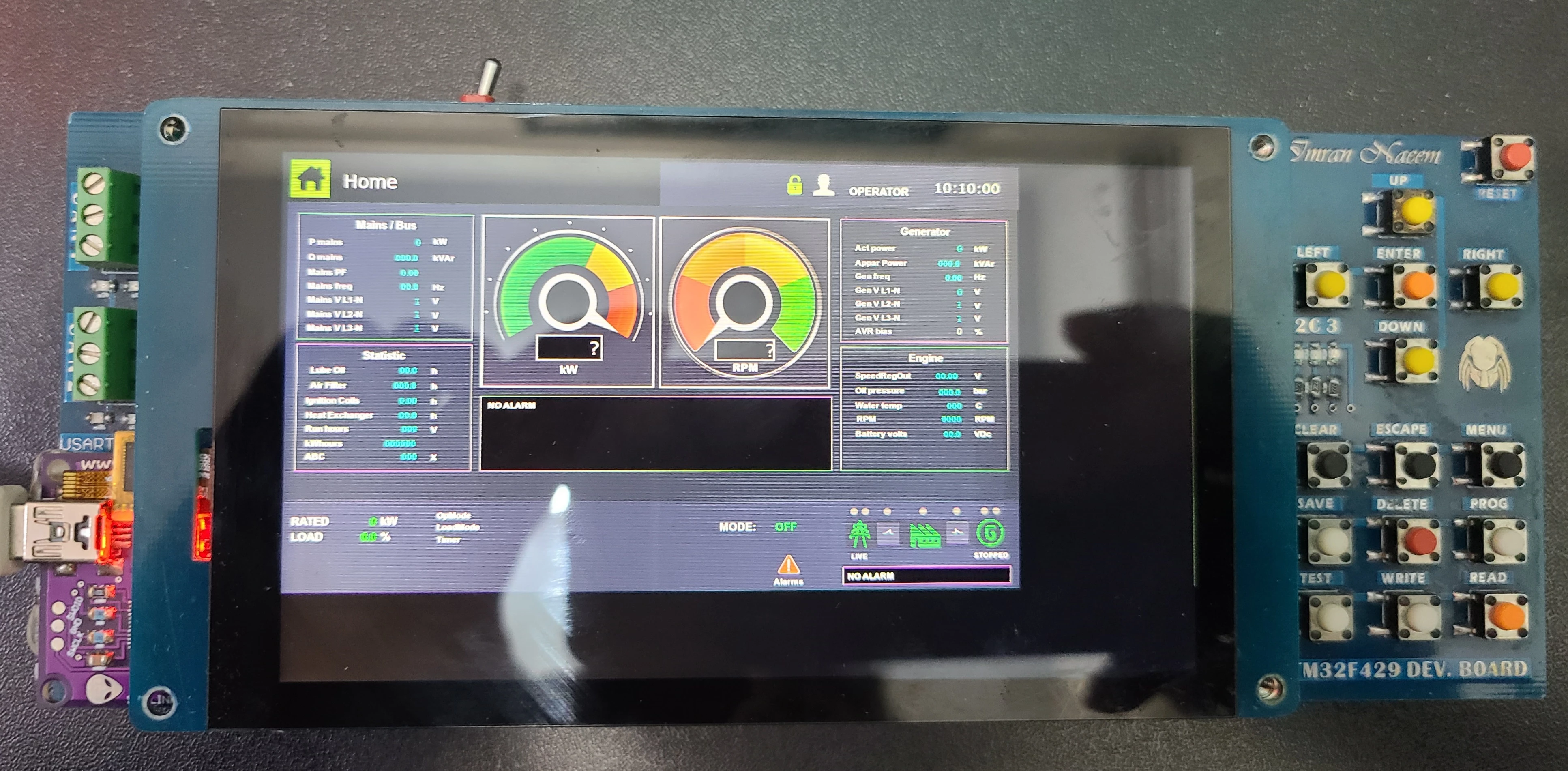

One of my previous experiment which I did was with 5" SPI and LTDC LCD of 720X1280 with STM32F429i-DISCOVERY.
LCD PART No. TL050HDV31CT5-H1206A & the lcd driver chip/COG is NV3052
The NV3052 accepts the configuration over SPI .
Regards
