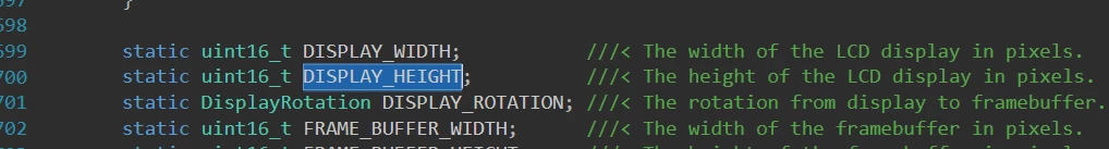

Is there Gfx interface to get screen/display size ?
I cannot find API to get display height/width. Is there any ? I tried to find something like
int16_t touchgfx::HAL::GetDisplayHeight ();
int16_t touchgfx::HAL::GetDisplayWidth ();
In GfxDesigner I see 240x320 values:
In TouchGFXConfiguration.cpp there is display initialisation:
static TouchGFXHAL hal ( dma, display, tc, 240, 320 );
SimConstants.hpp contains
static unsigned short SIM_WIDTH = 240;
static unsigned short SIM_HEIGHT = 320;
Thanks

You can use getScreenHeight() and getScreenWidth() (no need to put anything in front of those methods).

Thanks @GaetanGodart ,
this is close but not enough.
>"no need to put anything in front of those methods"
This is true only when within methods of a gfx::Screen derived class or having an instance of it.
Implementation of Screen::getScreenHeight () looked promissing
however, it is a variable
So cannot be used with compile-time expressions e.g.
static constexpr int DisplayNumberOfPixels { HAL::DISPLAY_HEIGHT * HAL::DISPLAY_WIDTH };

So you need a define?
I have found a few defines but they seem to not be used for every project:
ft5336.h seems to be a driver or a library related to the screen used:
stm32746g_discovery_camera.c is clearly related to the mcu:
SDL_test_common.h seems the most promising but I don't know what is PSP and why it is not declared there.
Also, SDL is used for the simulator :
SimConstants.hpp is generated by TouchGFX and accessible "in his scope" so this might be your best bet.
Since it is a static unsigned short, can you use it in your expression?

The SimConstants.hpp file does seem to have this information.
It is just unfortunate that we don't clearly refer to a constant for the various generated functions that require the screen size.
Have you tried accessing SIM_WIDTH and height from SimConstants.hpp?
Even if this file seems to only be used for simulation, I expect it to still exist and be accessible when compiling for the target.

>"The SimConstants.hpp file does seem to have this information."
Yes it does, however not marked as 'const(expr)' so cannot be used in compile-time calcs.
>"You have selected my last comment as best answer. Were you able to solve your problem?"
Yes, I think the answer is what I want is sth specialized and there are many places where screen size is available as you showed. I'll define my own global height&width.
