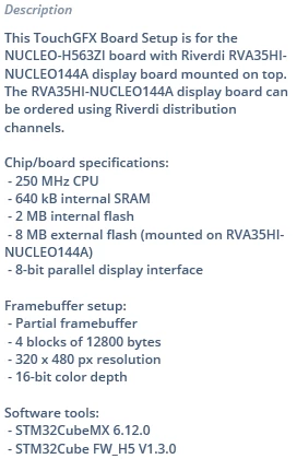

You can use TouchGFX, which is an ST GUI tool that will help you get started quickly. If you are new to TouchGFX, I recommend checking out TouchGFX Academy, where you will find tutorials and how-to videos to help you get started.
In TouchGFX Designer, there is a TouchGFX Board Setup (TBS) for the NUCLEO-H563ZI with the Riverdi RVA35HI-NUCLE0144A display board. This is a complete example project based on STM32CubeMX.
The Riverdi RVA35HI-NUCLE0144A has an 8080 interface, and the STM32H563 is, in broad terms, quite similar to the STM32H523 - just with more RAM and flash.
The TBS is using partial framebuffers with a total size of ~50 kB, so an identical setup for STM32H523 will easily fit in internal RAM.
If you need to investigate the graphics capabilities, I recommend getting the NUCLEO-H563ZI and the RVA35HI-NUCLE0144A. Then you can test GUIs right away with the TBS in TouchGFX Designer.
In any case, the TBS is a good starting point for running TouchGFX on an H5 MCU with an 8080 I/F LCD.
