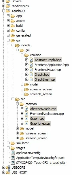

I made it work on my STM32F429 VGA project.
There is graph widget on GitHub TouchGFX Open Repository:
https://github.com/touchgfx/touchgfx-open-repository/tree/master/widgets/Graph
Download it and put in the paths like in the original project.
The picture shows it in my STM32CubeIDE.
Then you only need to edit your ScreenXXXView.hpp:

More you can do with graph you can find in TemplateView.cpp in the repository (link above).
My "code" draws a saw-like curve.
Jiri K.

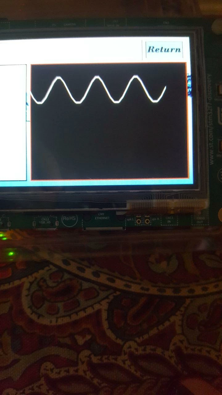

MFall.1
MFall.1Author
March 21, 2020
Hi Jiri
Thanks so much I earlier saw your file and learned so much from that .
actually you used two line segment for each segment , it was so genius . I didn't use your Abstarct Graph , and directly used CanvasWidget but the same Idea as yours and finally I could make the graph as attached . I have two question
1- is there any straight way to draw a set of open lines , simply without having to render those as a closed shape .
2- I have to put TickCounter around 50 to work otherwise it can not invalidate completely , it draw just a random part of the container not all of that .
Any way I like to thank you again for your contribution .
Morteza
