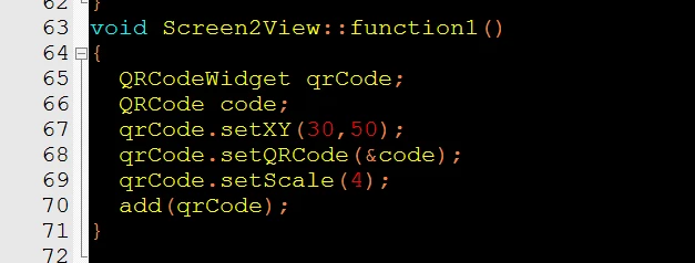

The chip is:STM32F429
When I was using the downloaded QRcode program, I found that the program crashed. The use method is as follows:0693W000007YzIvQAK.png

JJIAN.21
JJIAN.21Author
February 22, 2021
Thank you very much,I run the code as you said,it worked.

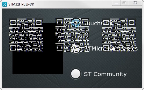

Agran.1
April 9, 2021
I wanted to put your example on the STM32H7B3I-DK.
"On a board you need to open your Application Template .touchgfx project in Designer. Click on Edit-> Import GUI -> Browse -> Select the .touchgfx file enclosed."
but it doesn't work in Run simulator and in Run Target. (picture attached)
Thanks in advanced to all your replies

Agran.1
Maybe there's something wrong with your steps,I've done a UI example,You can try this one first。The TouchGFX version is :TouchGFX 4.16.0 Designer
Agran.1
April 13, 2021
Thank you,
I also use the TouchGFX 4.16.0 Designer. but it doesn't work on the STM32H7B3I-DK and I don't understand why.
Hello Alexandre RENOUX (ST Employee),
Do you know why this doesn't work not on the STM32H7B3I-DK even in Run simulator of TouchGFX 4.16.0 Designer
