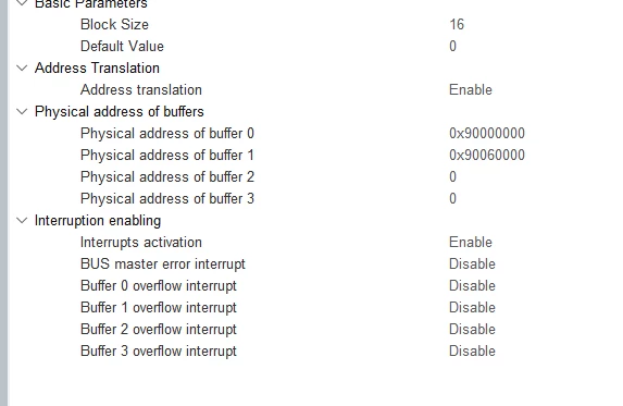

It seems  the gfxmmu between these chips are different, I can not configure the same as U5G9 .

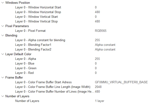

This is the GFXMMU and LTDC setup I am using:
The screen size is 480*480,I use 16 bytes per block,256*16=4096 bytes, I use RGB565,So 2 bytes per pixel.
4096/2 = 2048. So I changed the Image width to 2048. Is my calculation correct?

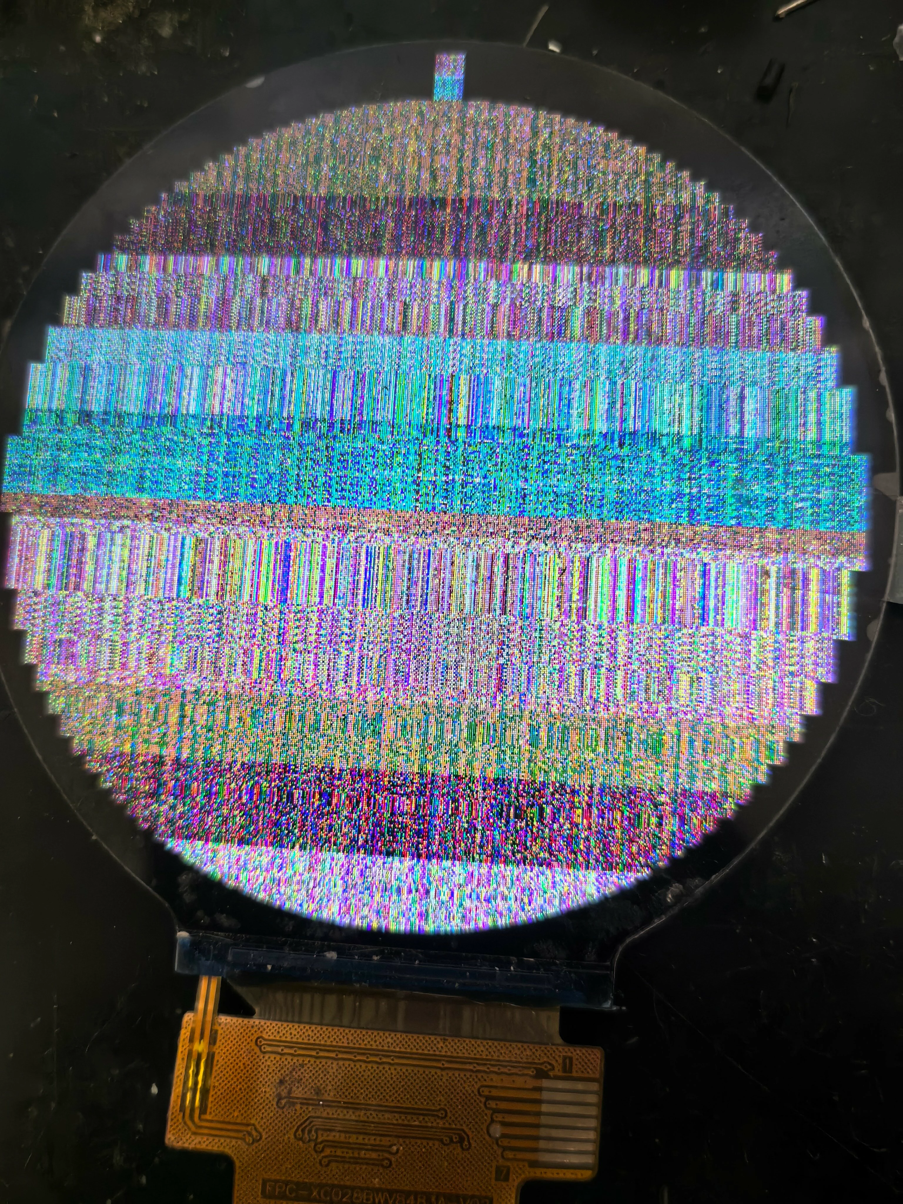

After this config,I got a display like this:
This is exactly what I want.But I did not use touchgfx, the random display is normal.So I believe I am doing right till now.

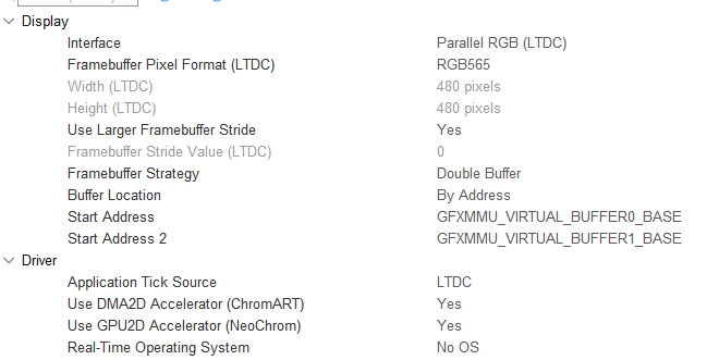

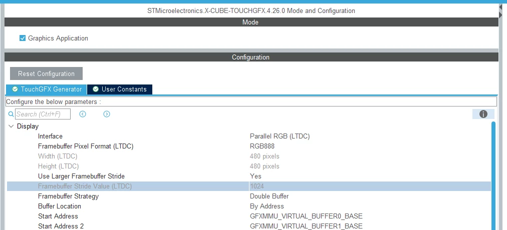

Then I enabled touchgfx ,use this configure:
I changed “Use Large Framebuffer Stride” to “Yes”,But The “FrameBuffer Stride Value” did not change as expected.

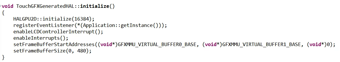

After generate code ,I found this changement in TouchGFXGeneratedHAL.cpp:
 setFrameBufferSize(0,480); This is  clearly a wrong number.
So I changed 0 to 2048,and build the project, download to mcu. The program is running ,If I place a break point ,It breaks normally. The RENDER_TIME pin is mormally fired, I can see 60hz 10% pwm coming out,which is normal.
The only thing that did not work is Display never changed.Still random pixel I showed before.
So what I am missing?

September 4, 2026
Hello amb,

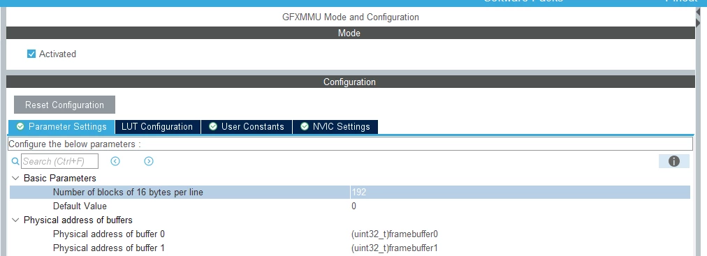

I agree that the value for “Framebuffer Stride Value (LTDC)” should definitely not be calculated to 0. In our U5G9 example project, this is calculated as a result of the “Number of Blocks” selected in GFXMMU configuration:
192 * 16 bytes / 24 bit/pixel = 1024 pixels
But this “Number of Blocks” parameter does not exist in the H7S7 GFXMMU configuration. I will have to investigate this further, give you a solution.
In the meantime, I am curious to know why you want to create a “round framebuffer” on the H7S7?
The typical purpose is to save around 20% of framebuffer RAM, by not storing the corners. But this comes at the expense of a little increase in rendering performance, because of the overhead of going through the GFXMMU. On the U5G9, this can be a good tradeoff because of the very limited internal RAM. But with external RAM, you normally have enough RAM that the 20% framebuffer size reduction is not important.
