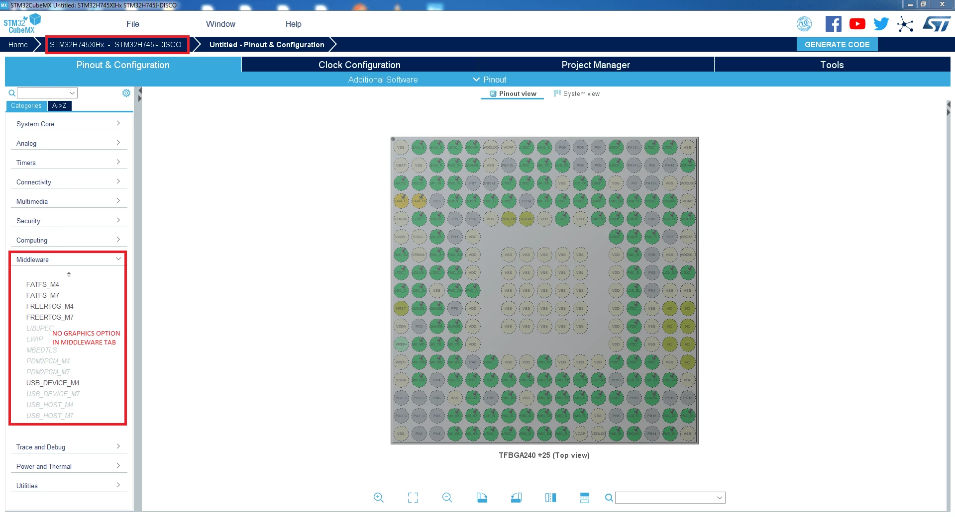

I select the "STM32H745I-DISCO" kit in "Board Selector" in "STM32CubeMx" software.
I have not found "GRAPHICS" option in "Middleware" TAB in "Pinout & Configration".
Can you please provide the some clarity on it.
How can i deal with "STM32H745I-DISCO" along with "TOUCHGFX".
Can you please provide me the steps that how to enable "GRAPHICS" option.

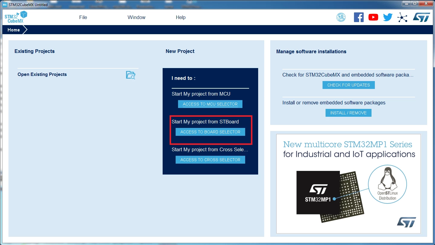

1. Open "STM32CubeMx" and click on "ACCESS TO BOARD SELECTOR".

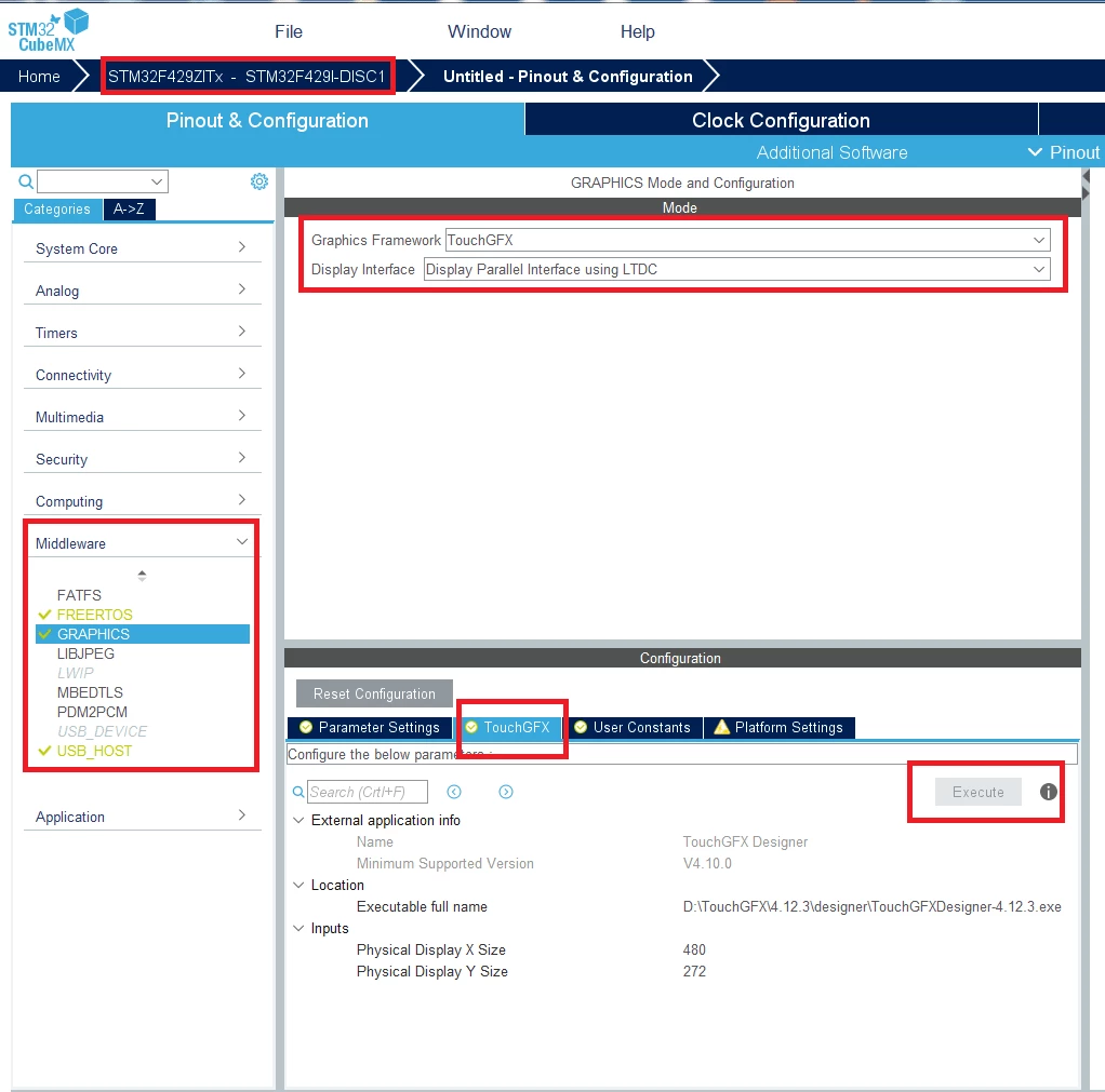

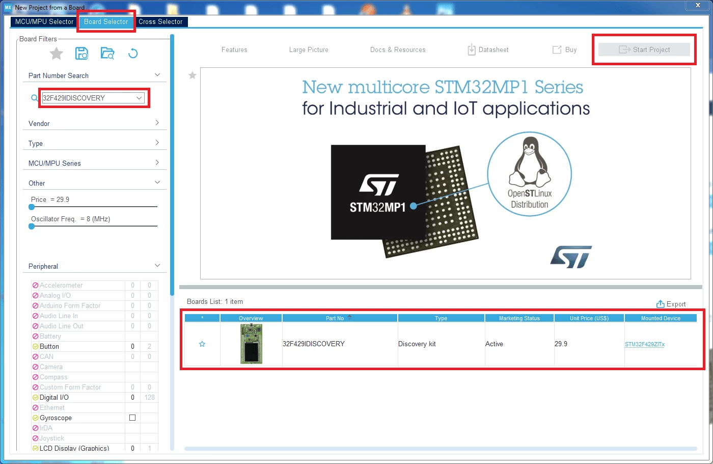

2. First, I am choosing the "STM32F429I-DISCOVERY" board, where I can find the "GRAPHICS" Option in the "Middle-ware" TAB, so I can able to choose the "TOUCHGFX" as Graphics Framework. please find the below snapshot.

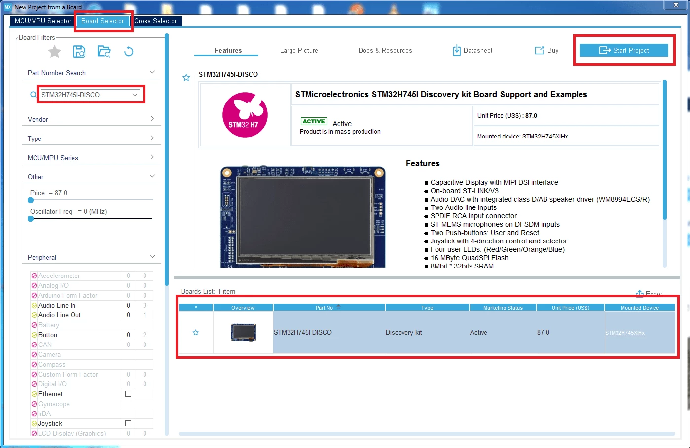

4. Now, I am choosing the "STM32H745I-DISCO" board, where I can not find the "GRAPHICS" Option to works with "TOUCHGFX". please find the below snapshot.

I received the following message from STM support:
The support for additional software packages like X-Cube-TouchGFX for H7 Dual cores, is still on the way. I expect end of the year. But please note that one can still run TouchGFX ontehse MCUs, on either the M7 or M4 core.
For now there is this github project: https://github.com/chcbaram/stm32h745_discovery - this is including the BSP, and a TouchGFX project.
I just simply switched to the STM32H750B-DK discovery board, which is supported.
