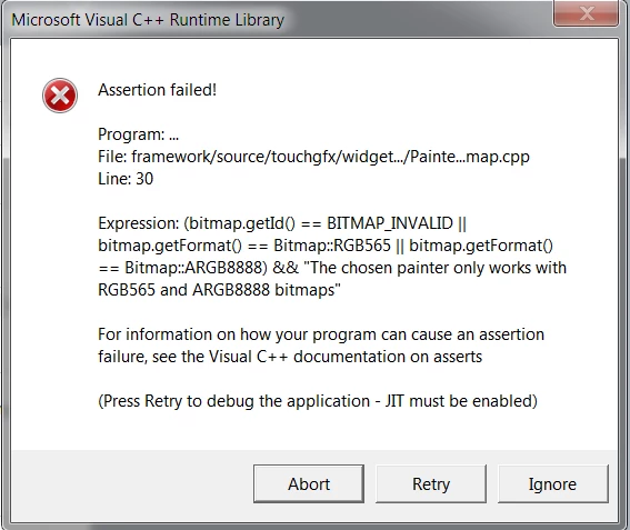

I attempted to use an image formatted to L8_ARGB8888 in a shape widget. The code compiled, but when running on the simulator I received the following assert:

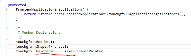

The painter for the shape is not instantiated as an L8_ARGB8888, but a PainterRGB8888Bitmap as seen in the gui_generated Screen1ViewBase.hpp file:
Does the shape widget support the PainterARGB8888L8Bitmap? If not will it support it in the future?

I created a simple project with an image formated to default (not L8_ARGB8888). Placing this in a shape in the TouchGFX Designer, it works fine. Then I added a copy of the shape (named differently) and formatted it to L8_ARGB8888.

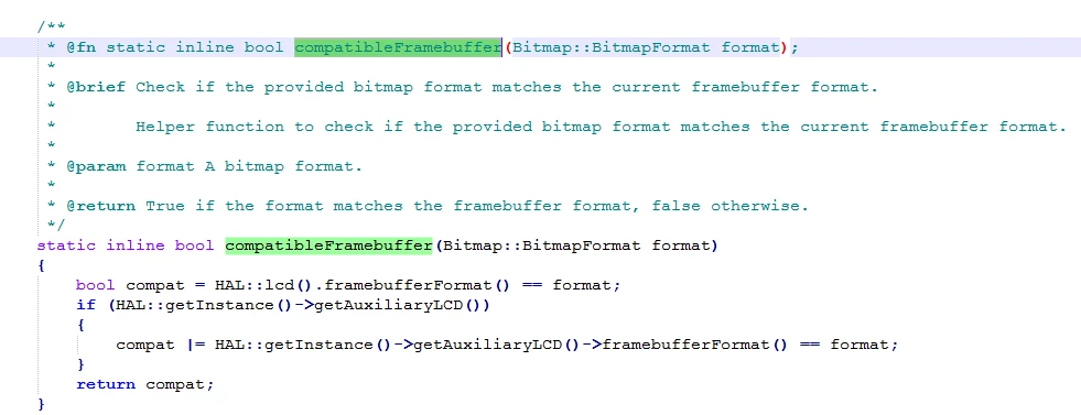

I manually added this shape and set it's painter to PainterARGB8888L8Bitmap. The code compiles, but I get an assert in the AbstractPainterARGB8888 (which is the base class of PainterARGB8888L8Bitmap).
A little bit more digging and I did find that this painter asserts this when it's not compatible with the framebuffer:

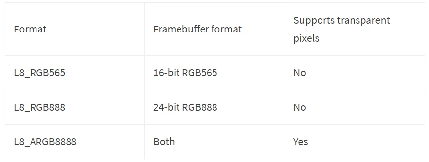

But, according to the L8 article (https://touchgfx.zendesk.com/hc/en-us/articles/360009793299-Using-the-L8-Image-Format)
L8_ARGB8888 should be supported in BOTH Framebuffer formats:
Am I missing something?

I formatted an image to L8RGB565 using the TouchGFX Designer. Then I used this image in a Shape widget (within the Designer). However, in the gui_generated Screen1ViewBase.hpp file, it is creating an instance of PainterRGB565Bitmap (not PainterRGB565L8Bitmap setup in the Designer):
touchgfx::Shape<4> shape1;
 touchgfx::PainterRGB565Bitmap shape1Painter;
I do not understand why it is creating a PainterRGB565Bitmap when the image is formatted to L8RGB565. Can you explain this?
