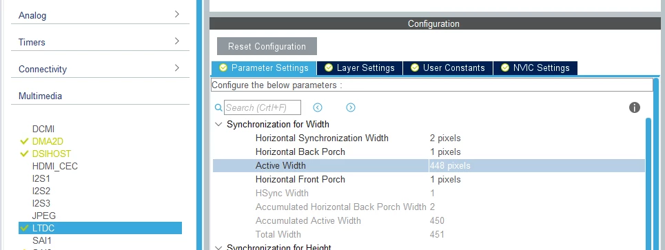

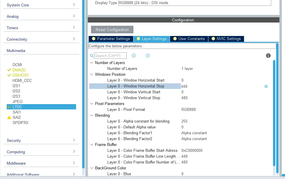

I recently tried the Application Template for the Stm32F769i-Discovery board and noticed that the horizontal sizes in the CubeMX file are 448 instead of 800:
This appears to be incorrect.
19 replies
Martin KJELDSEN
Principal III
April 29, 2020
It's correct, but confusing - I agree =) It has to do with the "chunks" of the framebuffer we transfer to the DSI display for 16 and 24 bits respectively, to avoid tearing. And 448*2=896 also has special significance. If you check the HAL code you'll find that we split the framebuffer into these areas and transfer one at a time until done. (TE and EndOfRefresh interrupt handlers)
You can't represent this intention in CubeMX in a clear way, though :)

@Martin KJELDSEN​  thanks for your quick reply.
That does explain it a bit. I also see that the following function is being called in MX_LTDC_Init():
 HAL_LTDC_SetPitch(&hltdc, 800, 0);
