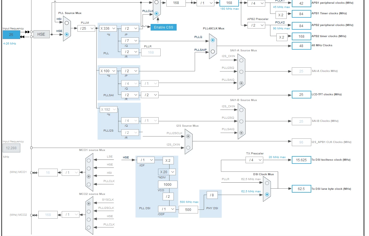

ari_v2
Senior
July 22, 2021
My LCD is 480*800*16bpp @60 Hz, results to 368.64 mhz. SDRAM is 16 bit wide.
Please see attached clock configuration. Could you see any indication for bad performance? images on screen often are darker than expected, after changing screen I see faded "leftovers" from the previous screen and also some screens flicker, while others are stable.
