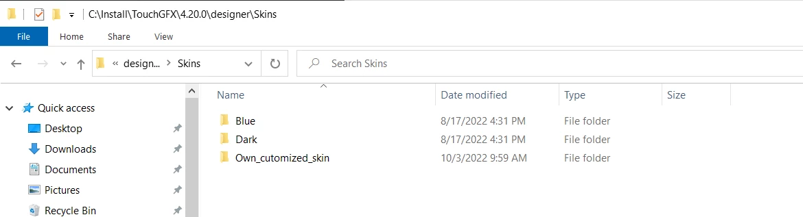

1- Go to your TouchGFX installation path, and navigate to this folder : "TouchGFX\4.20.0\designer\Skins"
2- Copy paste one of the Folder already there, for example "Blue", and rename you new folder with the name you want for your own customized skin :

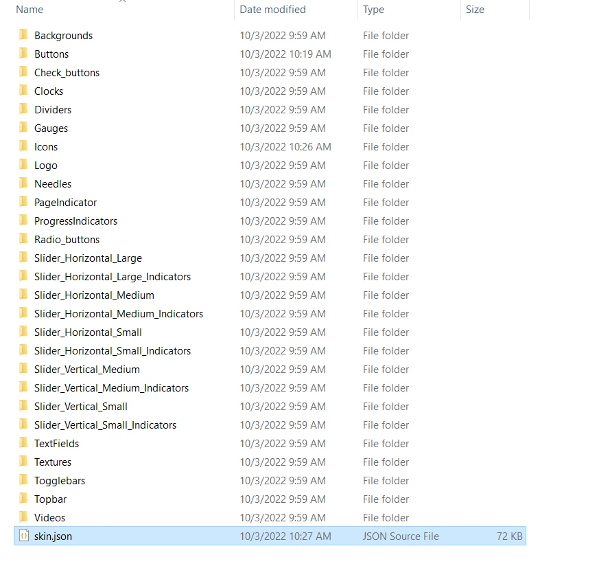

3- Open you new folder, and edit the skin.json file. You'll see on the first line, an entry called "Name". Replace the value with your new skin name :
 "Name": "Own_customized_skin",
4- Replace all the images you need in each of the folders
Be careful, TouchGFX Designer will warn you if the image you've put doesn't suit, for example, for check_buttons, all of the buttons need to have same size.
6- If you need to rename the images, edit again the skin.json file to add/rename an image. You'll probably also need to edit it if your image has other dimensions than the one you replace.
