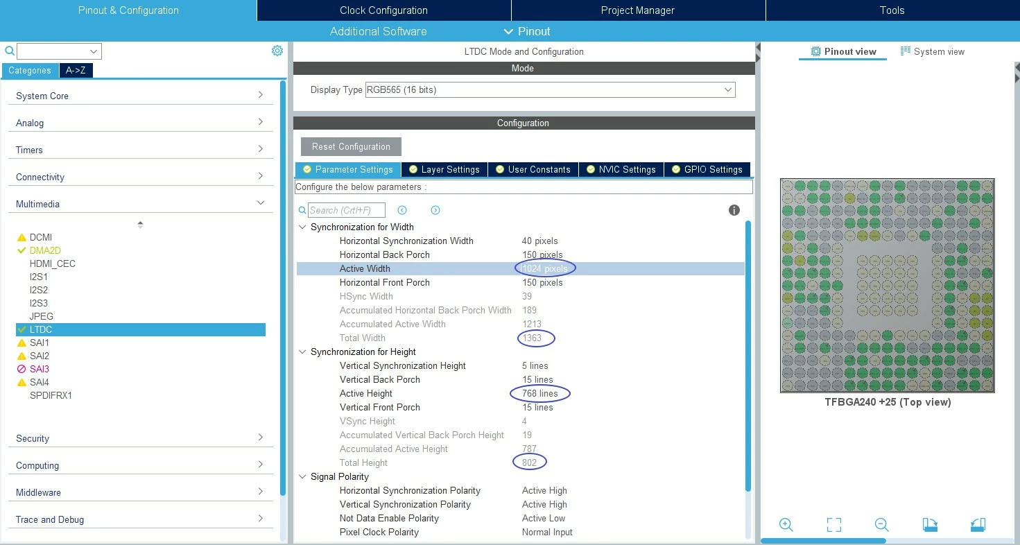

Hi all,
I am working on a project that requires a GUI with high resolution. I created a very simple TouchGFX project on a Sharp XGA LCD with a STM32H743 evaluation board. I got glitches between screen transitions. According to ThouchGFX specification, the maximum resolution it supports is 1024 x 720. My questions are, is the glitch caused by the limitation of the resolution? Is it possible to make TouchGFX support higher resolution? Thank you very much.

Thank you so much for helping me. I am not using a SD or MMC card to store images. I put the images in SPI Flash, and the SPI Flash is running under XIP mode and has been mapped to 0x90000000.
The LCD I am using is Sharp LQ064X3LW01. The datasheet is in the attachment. And a picture of LTDC settings is also attached.
I setup a very simple project. I have two screens, each screen has a pictures in the size of 1024x768. And I switch the 2 screens periodically.
If I set the LTDC clock to 40MHz, the frame rate would be 40,000,000 / (1363 x 802) = 36 Hz. And I can barely see the tearing effect. But because the clock is a lot lower than the recommended frequency, I can see the screen is flickering.
If I increase it to 50Hz, I get a 45 Hz frame rate. The flickering gets weaker, but the trade off is I would see an obvious tearing effect.
Do you have any idea about this? Thanks.

February 5, 2020
Hi JChan,
Thank you for your reply. My SDRAM is working fine. I have already enabled the MPU, so the read and write speed is fast enough to support XGA. I also have tried different LCD pin configuration, making them working under different speed mode. It does not help. As for the HCLK, I slowed don the clock for LTDC to 40MHz, TouchGFX can work with very few tear effect. But because of the clock is a lot lower than the suggested frequency (60Mhz) of the LCD, I can see a few flicker. I have already contact the ST technical support, hope they can give me some suggestions. Thanks.
Zli.1
Zli.1Author
February 11, 2020
Hi JChan,
Thanks for your answer. Yes, you are right. In my SDRAM settings, I forgot to turn on the burst read. After doing this, the tear effect issue improves. Now my LCD can go with a 66 MHz clock. But along with the increment of the frame rate, I'v got some side effects. Touchgfx is using LTDC clock for the tick event. It seems that the tick event on my board is a lot faster than it was on the simulator. On the simulator, the frequency of tick event is 60 Hz. Plus, the screen transition loses the transition animation.
