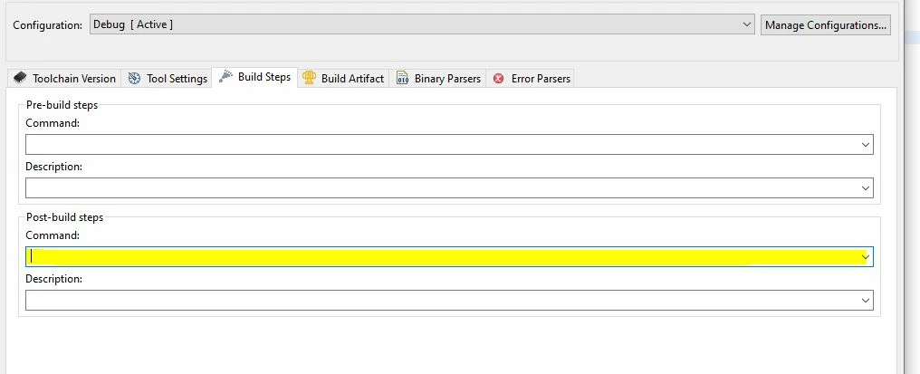

MPast.1
MPast.1Best answer
Senior
Feb 9, 2021 9:26 PM UTC
Sincerely, I appreciate all kind of hints from everyone!
Then I start to experiment and to filter the varoius answer on web.
The result is that objcopy --remove-section command syntax is right . is it also possibile to create a queue:
objcopy --remove-section=ExtFlashSection --remove-section=FontFlashSection --remove-section=TextFlashSection
instead themost important missing code is the first part of the command:
arm-none-eabi-objcopy.exe
writing :
arm-none-eabi-objcopy.exe --remove-section=ExtFlashSection --remove-section=FontFlashSection --remove-section=TextFlashSection "${BuildArtifactFileBaseName}.elf" "${BuildArtifactFileBaseName}.elf"
 Everything works.
I checked inside the "*.elf" file the ExtFlashSection, FontFlashSection and TextFlashSection and i discovered that these sections are not even presents.
Thank you so much.

Can you help me with this instruction?
I never use it. Have you got an example?
Must I insert the script in this section, right?
Tesla DeLorean
Guru
Feb 8, 2021 5:27 PM UTC
These aren't things I use day-to-day, and I'm not a CubeIDE user, think of me as the guy on the street giving directions, not the taxi driver.
There is documentation, check what sections you have in your linker script (.LD), check those which have content via (.MAP), or dumping the .ELF file
Here with typical naming from TouchGFX, pick those contributing to your QUADSPI foot print
objcopy --remove-section=ExtFlashSection --remove-section=FontFlashSection --remove-section=TextFlashSection target.elf
MM..1
Feb 7, 2021 9:14 AM UTC
For example when you use CubeIDE in debug config turn off DOWNLOAD at all and create flash only code script without reflash QSPI.
Scritp you can place to run after build part in config.
