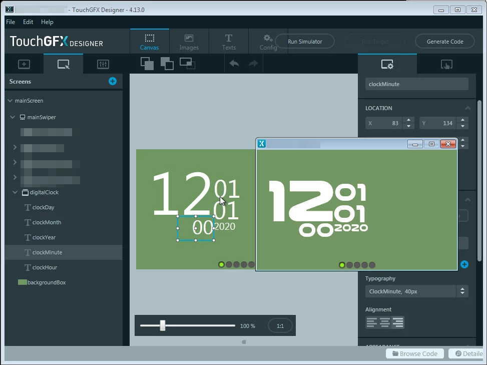

Invalid font displayed on canvas in TouchGFX Designer
I've came across a weird bug, where Designer displays a completely different font in the design window than is selected in the Typography . On compilation (emulator or on device) appropriate font is displayed. Example:0693W000003QoEgQAK.jpg
As you can imagine, sizing and placing of text elements is extremely annoying.
I'm specifically talking about the Nullshock Bold font, which you can find here: https://www.dafont.com/nulshock.font
Any hints on how to solve this would be appreciated.

Romain DIELEMAN
Sep 7, 2020 8:49 AM UTC
Just tested it, you apparently found a font file that we cant handle within Designer :grinning_face_with_sweat: I also tried to download it and see if it was recognize as a font installed in Windows but still could not find it. I talked to a colleague who will have a look, but it is mainly bad luck for now, I guess you could try to work wihtin Designer with a look alike font to do the settings but this might be complicated for nothing. Good luck :|

In addition to this, there is another frustrating issue with the Designer. The Designer doesn't place the text in the same location that the generated and/or simulated code does. Having to constantly simulate to verify exact location of the text is quite cumbersome.

I am having the same issue. As @scottSD​ stated, constant simulation is necessary to check if the fonts have the correct location on the screen. Without any observation of screen shown by the simulator this makes it nearly impossible to place the texts correctly.

We ran into another problem. We would like to use a custom font we are making, but now the TouchGFX Designer will not even list the font in it's list of available fonts, whether we copy it to the assets directory or install it in Windows. It is an OTF font.
So, we cannot even use the font in our design regardless if we can see it correctly in the Designer or not.
Any help in understanding why the Designer doesn't recognize a font would be appreciated.

I did find out what was wrong with the Designer not seeing the font. Font file names (and likely any other file) cannot have spaces in them.
When I changed the file name so that no spaces were in the name, the Designer does see it and puts it in the list.
