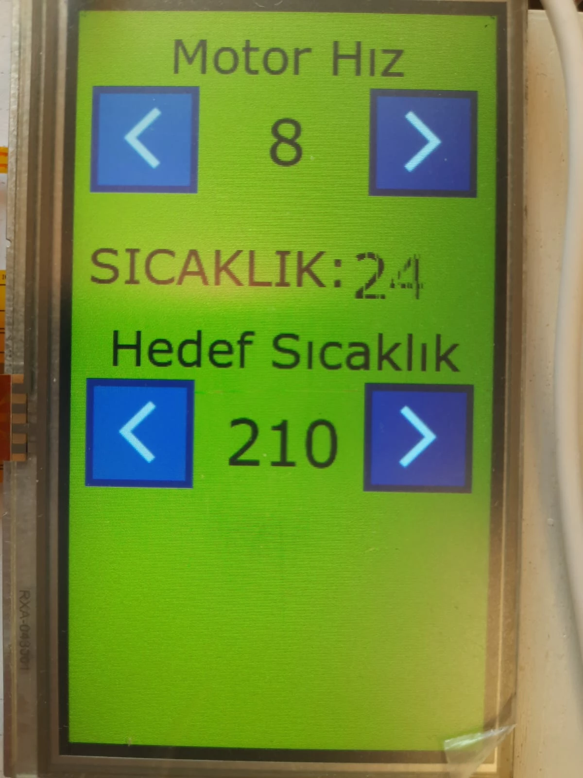

Hello.
I try develop TouchGFX+FreeRTOS based project for my custom board.
I have a text area problem. I attached photo. Also project attached.
It is not stable. It looks like always updating.
Also when i touch the buttons other text areas looks same just for a moment then stay stable.
What may cause to this problem?
I try to solve it via typography, task priority, but no result.
Microcontroller:STM32F750
CubeIDE ver: 1.15.1
TouchGFXDesigner: 4.24.0
Thanks.

https://community.st.com/t5/stm32-mcus-touchgfx-and-gui/text-not-showing-on-new-system-touchgfx/td-p/665235
https://support.touchgfx.com/docs/development/board-bring-up/how-to/02-cpu-running#cache-on-f7-and-h7
I disabled "DCache" and it works stable now.
It says: "It is recommended to disable at least the data cache until you have a stable platform."
"The solution is to flush the cache at certain points in your project, but we recommend to deal with this at a later point."
The solution doesn't look like easy. Disabling the Dcache is best solution for me.
Which problems may occur if i disable the Dcache?
Decreased performance.
