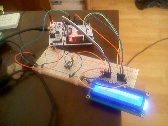

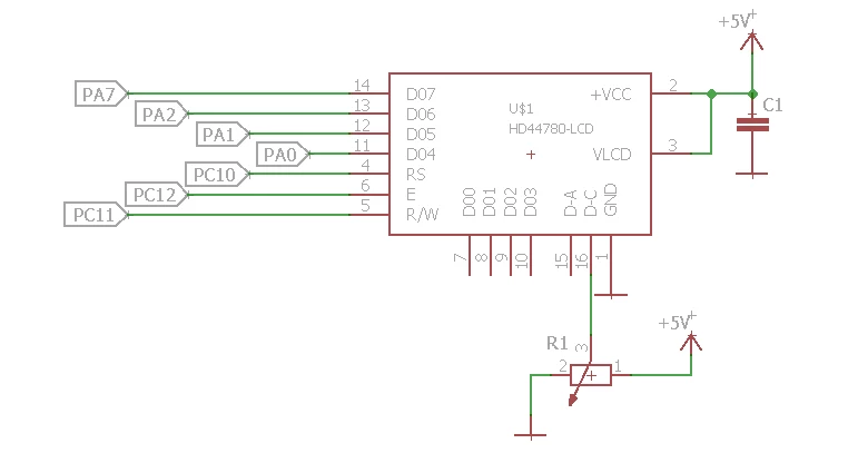

Recently I got the STM32L476 Nucleo-64 board. Now I am trying to interface it with LCD display. 0690X00000605acQAA.png To generate code (initialization and so on) I used the STM32CubeMX. LCD Initialization function is written by me (based on what's here: http://web.alfredstate.edu/weimandn/lcd/lcd_initialization/lcd_initialization_index.html)

Unfortunately, it isn't working and I can't figure out why. There is still a bunch of rectangles in upper row: 0690X00000603MYQAY.jpg I would be very grateful if somebody could help me. Best regards, TSM #hd44780 #stm32l4 #hal #lcd-display
