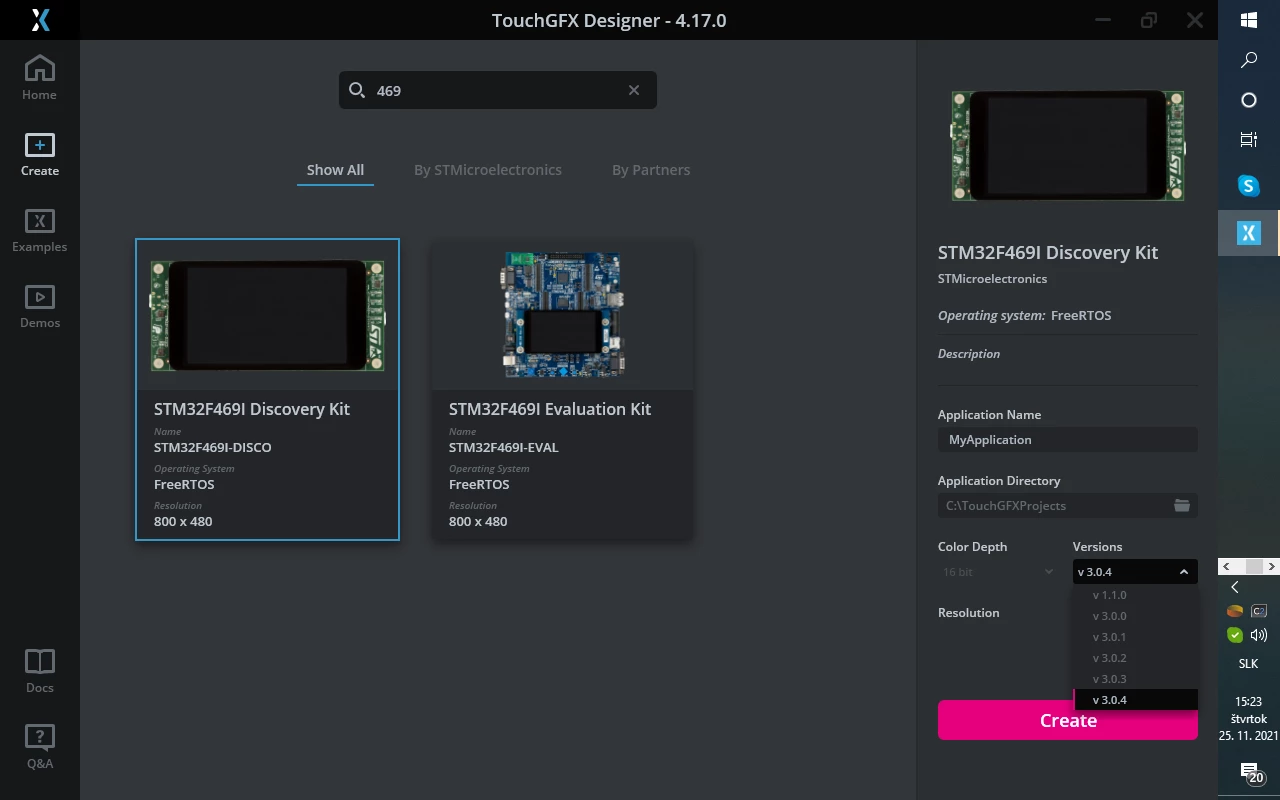

I created a TouchGFX Designer project for my 469 disco board, clicked "generate code", opened STM32CubeIDE, File->Import->Existing Projects into Workspace, chose the folder my my TouchGFXDesigner App ("MyApplication" default TouchGFX Designer project name). In the checkboxes under "Options" in Import window only "search for nested projects" was ticked. Nothing else. (hasn't found any nested projects anyway). Imported it.
Now I have a project named "STM32F469I-EVAL" in STM32CubeIDE. Yes, EVAL. No idea why. I can't open IOC file, it says
Invalid State: Most probably trying to open 'STM32F469I-EVAL.ioc' file from an abnomal previous IDE session exit. Please close such editor and have a new try to recover properly.
I don't have any editors open and didn't have any. I never opened that IOC file with anything. Anyway, I restarted STM32CubeIDE multiple times. It stays.
Also, when I press "build" (the hammer icon), I I get all those smart lines about compiler doing it's compily things, until
make: *** No rule to make target 'C:/TouchGFXProjects/MyApplication/Drivers/STM32F4xx_HAL_Driver/Src/stm32f4xx_hal_uart.c', needed by 'Drivers/STM32F4xx_HAL_Driver/stm32f4xx_hal_uart.o'. Stop.
Specifically this file. The previous files with similar names like stm32f4xx_hal_tim compile OK and don't give any errors. IDE restart doesn't help it either.

First, unfortunately you are working with the STM32F469 Disco and there is a known issue at the moment with the TouchGFX Board Setup for the STM32F469 DISCO where it is renamed STM32F4669 EVAL in STM32CubeIDE. This will soon be fixed. Meanwhile you could use a previous version of the TBS by clicking on the version number of a TBS when creating a new project in TouchGFX Designer.
When you start a project from TouchGFX Designer with a TouchGFX Board Setup for one of ST development kit you will have a fully configured STM32CubeMX project along with projects for the toolchains STM32CubeIDE, Keil and EWARM. You just have to double click on .cproject or .project in the /STM32CubeIDE folder in your project folder to open the project in STM32CubeIDE.
When you want to create a project from scratch it is recommended to start a project from STM32CubeMX (for better folder structure). Before generating code make sure you have selected the right toolchain, STM32CubeIDE in your case, and set the TouchGHFX Generator. Then you will have a generated TouchGFX project and a generated STM32CubeIDE project that work together. You can just copy paste the configuration we have set in our TBS (in STM32CubeMX but also in code in the main.c and in the files under the TouchGFX/target folder) until it gets fixed.

I created a new project in TouchGFX Designer, "run target" (it's running on MCU now), then I opened .cproject. STM32CubeIDE proudly said "imported in workspace successfully" (or the verb wasn't "imported", I closed the window without remembering the exact work). I clicked "build" and got the same as before:
arm-none-eabi-gcc "C:/TouchGFXProjects/TestApp4/Drivers/STM32F4xx_HAL_Driver/Src/stm32f4xx_hal_tim_ex.c" -mcpu=cortex-m4 -std=gnu11 -g3 -DUSE_HAL_DRIVER -DSTM32F469xx -DDEBUG -c -I../../Core/Inc -I../../Drivers/CMSIS/Include -I../../TouchGFX/target -I../../Drivers/CMSIS/Device/ST/STM32F4xx/Include -I../../TouchGFX/App -I../../Middlewares/Third_Party/FreeRTOS/Source/CMSIS_RTOS_V2 -I../../TouchGFX/target/generated -I../../Drivers/BSP/Components/Common -I../../Middlewares/Third_Party/FreeRTOS/Source/include -I../../Drivers/STM32F4xx_HAL_Driver/Inc/Legacy -I../../Middlewares/Third_Party/FreeRTOS/Source/portable/GCC/ARM_CM4F -I../../Drivers/BSP/STM32469I-Discovery -I../../Drivers/STM32F4xx_HAL_Driver/Inc -I../../Middlewares/ST/touchgfx/framework/include -I../../TouchGFX/generated/fonts/include -I../../TouchGFX/generated/gui_generated/include -I../../TouchGFX/generated/images/include -I../../TouchGFX/generated/texts/include -I../../TouchGFX/gui/include -I../../TouchGFX/generated/videos/include -Os -ffunction-sections -fdata-sections -Wall -fstack-usage -MMD -MP -MF"Drivers/STM32F4xx_HAL_Driver/stm32f4xx_hal_tim_ex.d" -MT"Drivers/STM32F4xx_HAL_Driver/stm32f4xx_hal_tim_ex.o" --specs=nano.specs -mfpu=fpv4-sp-d16 -mfloat-abi=hard -mthumb -o "Drivers/STM32F4xx_HAL_Driver/stm32f4xx_hal_tim_ex.o"
make: *** No rule to make target 'C:/TouchGFXProjects/TestApp4/Drivers/STM32F4xx_HAL_Driver/Src/stm32f4xx_hal_uart.c', needed by 'Drivers/STM32F4xx_HAL_Driver/stm32f4xx_hal_uart.o'. Stop.
make: *** Waiting for unfinished jobs....
"make -j4 all" terminated with exit code 2. Build might be incomplete.

Holy mackerel! Thanks for this thread. I've lost weeks struggling with this issue.
Why doesn't ST inform uses about this problem and the simple fix.
SOLUTION:
When you select the STM32F469I-DISCO board in TouchGFX, before clicking on create, select Version 3.0.4.
