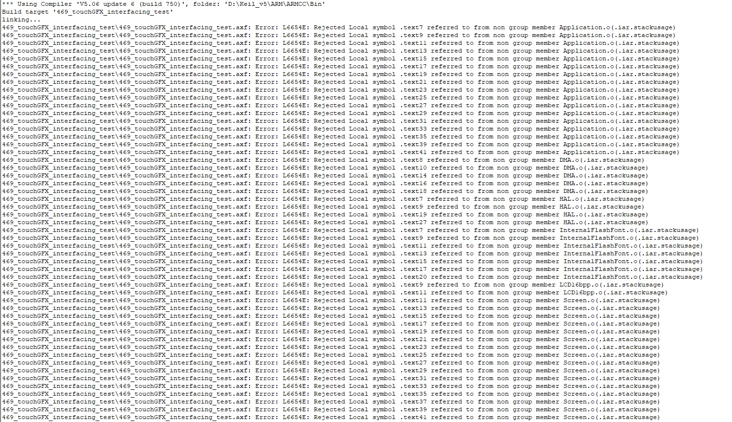

Hello all, I tried to integrate touchGFX to ​STM32CubeMX and I'm using keil to complie all the files. The complication is successful yet mountains of errors occurs during linking ! All errors are of the same type like this:
Error: L6654E: Rejected Local Symbol .x refered to from non group member x.o (.iar.stackusage)
Please help! I think I'm almost there!

Thanks a lot for your comment. I agree that it might be a bug since L6654E is so rare that few solution is released currently.
I disabled touchgfx in STM32CubeMx and deleted all related c files. I enabled the framework again and the error comes to be:
"Error: L6242E: Cannot Link Object xx.o as its attributes are incompatible with the image attributes.   ... wchart-16 clashes with wchart-32."
These xx.os are all touchgfx objects. Hence enum length definition conflict between touchgfx lib and STM32CubeMX library might be the reason.
I have to switch to AC6 compiler and use command line options to unify their length or just shift to IAR/SW4STM32 (which can be a better solution)...

Thank you for your sharing! It's rather impressive! I still worked on keil afterward and I switched to Arm Compiler Version 6.10.1. Here's the only error left:
469_touchGFX_interfacing_test\469_touchGFX_interfacing_test.axf: Error: L6683E: Merge Section TextFlashSection(texts.o) has an element size of zero
Furthermore, there're lots of touchGFX objects showing the warnings as below:
469_touchGFX_interfacing_test\469_touchGFX_interfacing_test.axf: Warning: L6776W: The debug frame in .debug_frame(stm32f4dma.o) does not describe an executable section.
as well as:
469_touchGFX_interfacing_test\469_touchGFX_interfacing_test.axf: Warning: L6869W: utils.o requested the Rogue Wave Standard C++ Library which has been removed from the product. This might cause link errors because libc++ is used instead.

​The problem is finally solved. Here I will list the related procedure.
  1. Enable DMA2D, LTDC, SDRAM, I2C(if you wanna touch control), FreeRTOS, CRC, SPI
  2. Make sure LCD clock is 6MHz and ili9341(screen driver) is enabled in GRAPHICS
  3. Make sure timebase source in SYS is NOT SysTick
  4. Make sure you have configured every parameter in GRAPHICS correctly, especially the platform settings, every pin should be defined properly.
  5. Locate the touchGFX exe in GRAPHIC so that you can execute it afterward BUT NOT NOW.
  6. Configure the project manager and press generate code.
  7. Confiure the keil project by adding a group containing discovery files: stm32f429i_discovery.c/h, stm32f429i_discovery_ts.c/h, stm32f429i_discovery_io.c/h
  8. Add extern "C" before MX_FREERTOS_Init() at main.c and void GRAPHICS_MainTask(void){} at BoardConfiuration.cpp.
  9. Delete one LCD_Delay() function in EITHER hal file OR discovery file, the latter is recommended.
  10. Compile the project and make sure it succeeds.
  11. Include stm32f429i_discovery_ts.h in TouchController.c and make the commented BSP functions code.
  12. Now it's ok to execute touchGFX in STCube and make your own GUI. IF you've already execute touchGFX at step 5, error as mine stated above might happen.
Hope this help.
Enjoy and goodluck!
