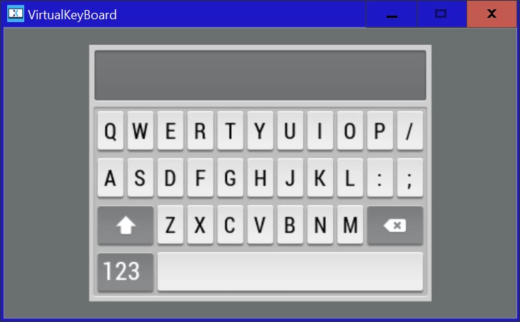

Integrate Qwerty keyboard example code into and existing TocgGFX project
  • June 1, 2022
  • 1 reply
  • 1357 views
I have project running on an STM32H7B3I-DK. I need to use the display to enter WiFi data SSID, password etc.
I don't really want to spend a week writing my own so I thought I'd use the example in Touchgfx
Has anyone done this?
What steps do I need and how do I instantiate it and get the reurn string?

Hello @Garnett.Robert​ ,
I will share you a project my team did and that implements a concrete example of using a keyboard, getting the result of what the user entered, and triggering an action after comparing the user string with a known buffer.
You can look at the Screen1View::keyboardDonePressed(Unicode::UnicodeChar buffer[]) method, to understand how the process work.
To explain with more details, every time the user presses the "DONE" button on the custom keyboard widget, a callback in Screen1View.cpp is triggered, and then the given string is passed to the keyboardDonePressed(Unicode::UnicodeChar) method, which will compare this string with a known buffer to display images on the screen, or not.
So you can get inspiration from this example an adapt it for your needs.
