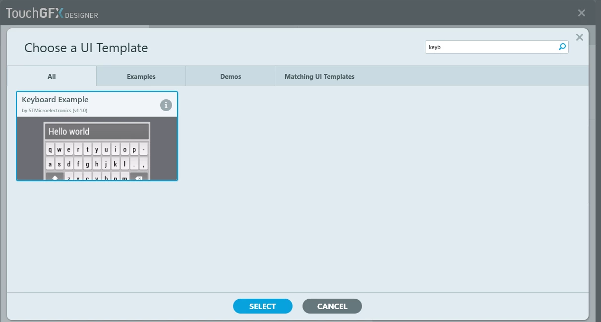

Have looked at the "Keyboard Example" from TouchGFX Designer?
With regards,
Badreddine

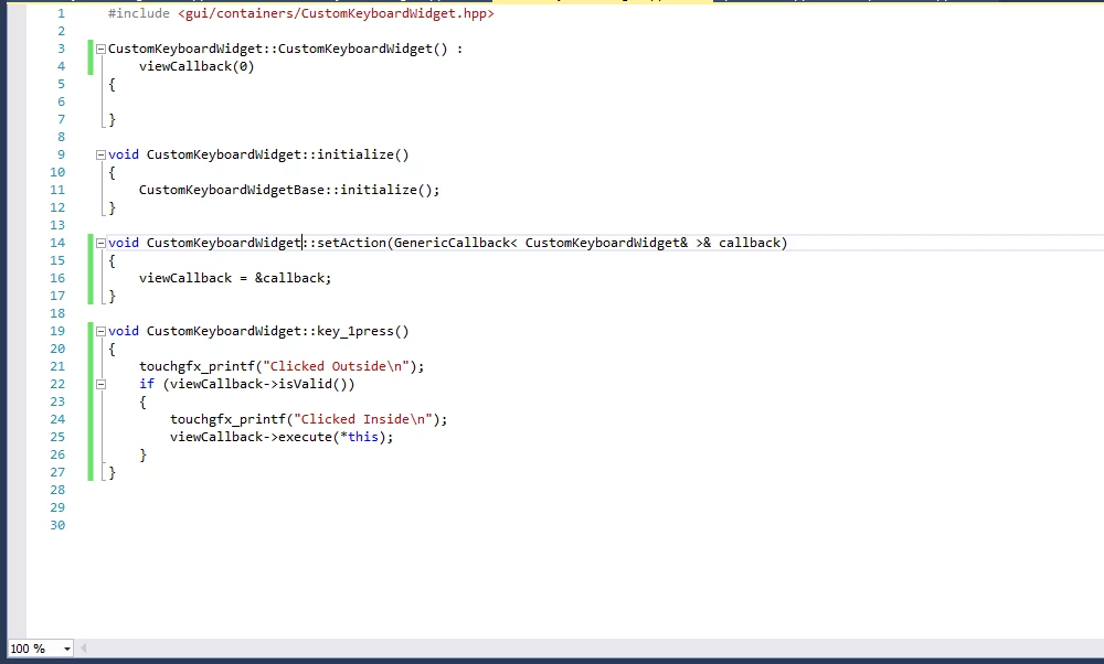

The concrete problems are,
1) A keyboard pops up when I press the text box(I have placed a button with trigger over here and upon that button, text will be written). I have achieved this via Show Widget Action since I have made my own Custom Keyboard Widget.
2) I have placed that custom Keyboard Widget on my Main Screen.
3) I am trying to implement a functionality where when I press the keyboard key (say for example A) on my custom widget, it overrides the text box on my Main Screen with the character pressed.
4) I adopted a callback approach for this linking the buttoncallback on custom keyboard widget with a callback I created on my Main Screen.
5) The code compiles fine however as soon as I launch the simulator and press the key on custom keyboard, the Simulator crashes. I did some printf debugging and found out that the code gets stuck at " if (callback -> isValid()) " part of the code and I can't understand how to fix this.
6) I understood your point of using * in place of real character. Thanks for this. Please also respond to the above problem. I shall be very thankful.

So you're not getting an assert popup? Did you set a callback? Usually it would be
if( callback !=0 && callback->isValid() )
So if you haven't set a callback i'm sure the code would just crash since your pointer is uninitialized. That's a "mistake" in the keyboard to not guard for null pointers before dereferencing.

Yes I have set up a callback. Basically, I am using the callback generated by GUI Interaction. In that buttonhandlercallback, I have called a virtual function. In my code, I am using that virtual function and checking the assert popup condition inside that virtual function.
Do you mean I can't use the gui generated callback's function directly? What could be the other approach then?​

There's no reason why you shouldn't be able to do that, but you need to initialize the callback to point to that specific handler. I don't think the application should crash, though, if you have not bound a handler to the callback:
e.g. default init of a callback
MyView::MyView() :
 callback(this, &MyView::callbackHandler)
/Martin

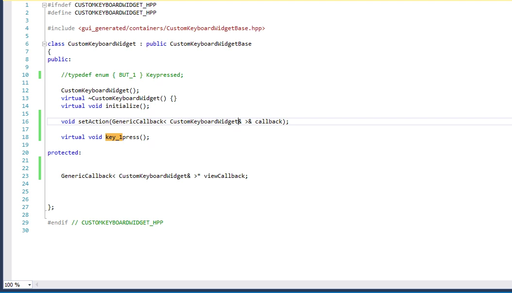

Let me post my code snippets for a better explanation of my query.
I have a Custom Container named CustomKeyboardWidget. The respective .hpp and .cpp files are attached below.
The GUI prints "Clicked Outside" and as soon as if (viewCallback->isValid()) condition is entered, the GUI crashes.
The key_1press function is a virtual function automatically created by the GUI whenever key_1 on keyboard is pressed.

Resolved. I was referencing the callback in my mainview but I was not calling setAction function in my mainscreen that's why gui was crashing.​
