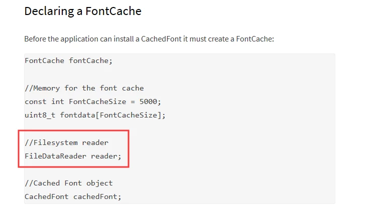

Installing the binary font at the external SDRAM on the STM32F429BI board will Cause program crash.
Here are my programs:
const int FontCacheSize = 10000;
uint8_t fontdata[FontCacheSize] __attribute__((at(0XC0E00000))) __attribute__ ((aligned(4)));
FrontendApplication::FrontendApplication(Model& m, FrontendHeap& heap)
   : FrontendApplicationBase(m, heap)
 FIL fil;      /* File object */
 FRESULT fr;   /* FatFs return code */
 UINT br;
 fontCache.setMemory(fontdata, FontCacheSize);
 /* Open a text file */
 fr = f_open(&fil, "0:/Font_VINERITC_TTF_20_4bpp.bin", FA_READ|FA_WRITE|FA_OPEN_ALWAYS);
 if(fr == FR_OK)
  fr = f_read(&fil, fontdata, FontCacheSize, &br);
  fr = f_close(&fil);
  new (&bf) BinaryFont((const struct touchgfx::BinaryFontData*)fontdata);
   TypedTextDatabase::setFont(Typography::DEFAULT, &bf);
Sometimes it able to work. But , if I touch the screen the program will crash.
Most of the time,the program crash on the power on.
2�?I'm not sure what this filedatareader is. Who can give me an example. The chip is stm32f429bi, and the file system is FatFs.Thank you .

Normally you'd use Binary Fonts because you have a typography that is incredibly large, and you cannot or won't place it in external flash memory, so you place it on an SD-Card. You then have to read this data from the SD-Card (Here's where the FileDataReader comes into play).

Hello​, Martin, Thank you for your answer.
What you say is what I need.
I want to read ​the typography to SDRAM from the Sd-card.
1.Can you give me a specific example for the FileDataReader.
2. How about my first question?Do you know why?When I define the fontdata[FontCacheSize] in the internal RAM, it go good.
Fchen.1864
Dec 2, 2019 2:46 PM UTC
1.I have an external sdram of 16MB.
2. I want trying to read glyphs into a cache( preferably define in Sdram) in the case where loading a complete binary font is not possible.(e.g. Chinese).
