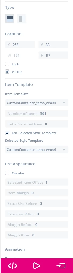

Inquire about how to set the scroll wheel step change.
hello
The scroll wheel is set and used as follows.
​0693W00000QKNLVQA5.png​
void ScrTopSetView::scrollWheel_ScrTopSet_minuteUpdateCenterItem(CustomContainer_temp_wheel& item, int16_t itemIndex)
 // Override and implement this function in ScrTopSet
	int data;
	minute = itemIndex;
	 Unicode::snprintf(textArea_ScrTopSet_nMinuteBuffer, TEXTAREA_SCRTOPSET_NMINUTE_SIZE, "%02d", (minute ));
	 textArea_ScrTopSet_nMinute.invalidate();
One step at a time is good.
I need a configuration that changes by 1 step or 10 steps depending on the setting value, but I am not sure how to set the 10 step change.
I'd like to know how to set the level at which the scroll wheel changes.
thank.​

mSH.1
mSH.1Author
Jul 4, 2022 10:19 AM UTC
hello, @Osman SOYKURT​
-> It is implemented by referring to the basic example.
The scroll wheel value changes in one step.
0693W00000QKNbiQAH.jpg​
-> What I need is to change the value of the scroll wheel by 10 steps.
0693W00000QKNdKQAX.png​
Show 10 steps on the scroll wheel and void ScrTopSetView::scrollWheel_ScrTopSet_minuteUpdateCenterItem(CustomContainer_temp_wheel& item, int16_t itemIndex)
In the function, the value of itemindex changes in 10 steps.
I'm trying to set it up while looking at the API, but I'm not sure yet
tnank.​

Ok, then I think you can use scrollWhellUpdateItem() function. You can then update your item like that :
item.updateText(itemIndex*10);
We have an example of scroll wheel usage on TouchGFX Designer, I invite your to have a look at it.
Another solution would be to update your scroll wheel in it entire with function like :
scrollWheel.setNumberOfItems(ITEM_NUMBER)
if you want to filter your items, then use modulo (%) to show what you want, for instance if you want 0, 10, 20, 30, then a %10 is good.
