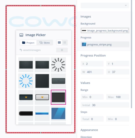

Inquire about error occurrence when using image in skin folder in "imageProgress" function
hello
If you select the project folder in the "imageProgress" function, it works normally, but if you select the image in the skin folder, an error occurs.
0693W00000NrJQ1QAN.png​
PC simulation works normally, but an error occurs only in the target board download.
The error message is as below :
  compilation terminated.
    gcc/Makefile:339: recipe for target 'TouchGFX/build/STM32H735G-DK/TouchGFX/generated/images/src/__designer/image_Blue_ProgressIndicators_fill_tiling_progress_indicator_fill_striped_normal_horizontal.o' failed
    make[2]: *** [TouchGFX/build/STM32H735G-DK/TouchGFX/generated/images/src/__designer/image_Blue_ProgressIndicators_fill_tiling_progress_indicator_fill_striped_normal_horizontal.o] Error 1
    make[2]: *** Waiting for unfinished jobs....
    gcc/Makefile:289: recipe for target 'generate_assets' failed
    make[1]: *** [generate_assets] Error 2
    ../gcc/Makefile:49: recipe for target 'all' failed
    make: *** [all] Error 2
thank!

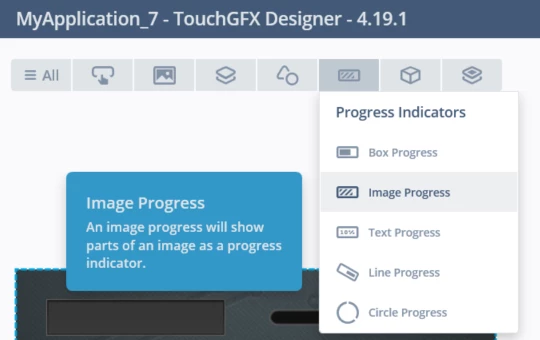

  • What is "imageProgress" function ? What does it do ?
  • Which version of TouchGFX are you using ?
Thank you,

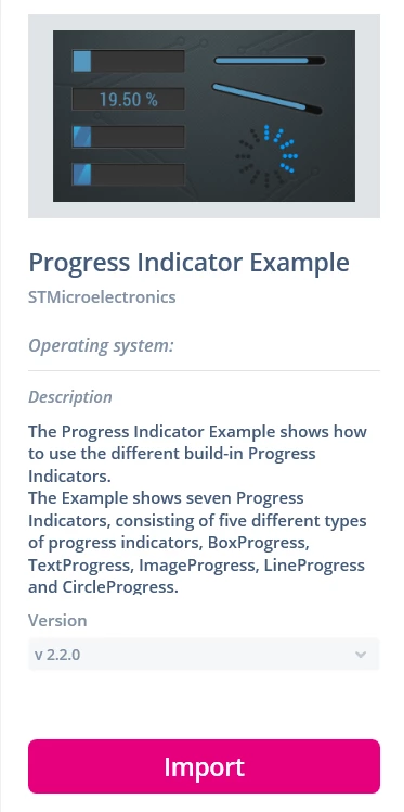

I am studying while watching "Progress Indicator Example" during the TouchGFX demo.
While studying, the above error occurred while using "Image Peogress" in the project I made.
Summarizing the phenomenon,
  • TouGFX Demo operates normally no matter where you select the image of "Image Progress" from "Project" or "skins".
  • If I select the image of "Image Progress" of my project in "Project", it works normally, but when I select it in "skins", an error occurs.
At this time, the error situation occurs only when the PC simulation works normally and downloads it to the board.
-> The latest version, 4.19.1, is being used.
-> But the strange thing is
When I moved the PC, the error did not occur and it works normally.
I don't know what could be the problem.
