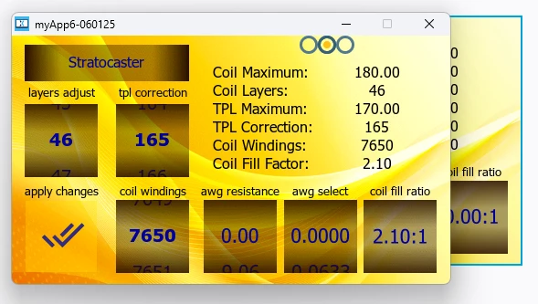

Thank you for all of your suggestions everybody.  Your input encouraged me to think in greater depth about what I was trying to achieve using radio button groups in preference to another widget type.  At some point earlier in the new year, frustration got the better of me and I ripped out all the button code, replacing it with a combination of scroll wheel and scroll list widgets (which, in my humble opinion appear to be much more suitable for my application).  I'm not where I want to be yet however, I am over the problem which prompted my post although I still do not know what was causing it.
  I'm much happier with the result    :)
