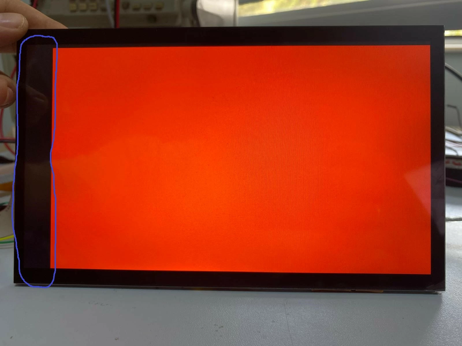

Hello everyone.
I am doing a TOUCHGFX project with STM32H750IBT6, W25Q512, IS42S32400F-6TL. I took my first screen printout and the image came out shifted. I am using my screen vertically by rotating it 90 degrees in Touchgfx Designer. I still haven't solved the problem. I would be very happy if you could help me.

Hello @MKoca.1 ,
Is this screen displayed using TouchGFX or are you directly setting the pixels? (I guess you are using TouchGFX but just making sure)
What happens when you do not rotate the screen by 90 degrees?
Do you also have to issue when you directly set the pixels?
Can you do this step without issue?
What is shown in the simulator? A full red screen or is it also shifted?
Please, if possible, use an image so that we can be sure whether the screen is shifted or if it is partially hidden/undisplayed.

Hello dear official @GaetanGodart ,
thank you for your answer. I solved my problem. I forgot to move the Mode pin of the TFT LCD screen I use to high. When I set the LCD_Mode pin high, my problem was solved.

Hello @MKoca.1 ,
I am glad you solved your issue! :smiling_face_with_smiling_eyes:
Don't hesitate if you have TouchGFX related questions.
