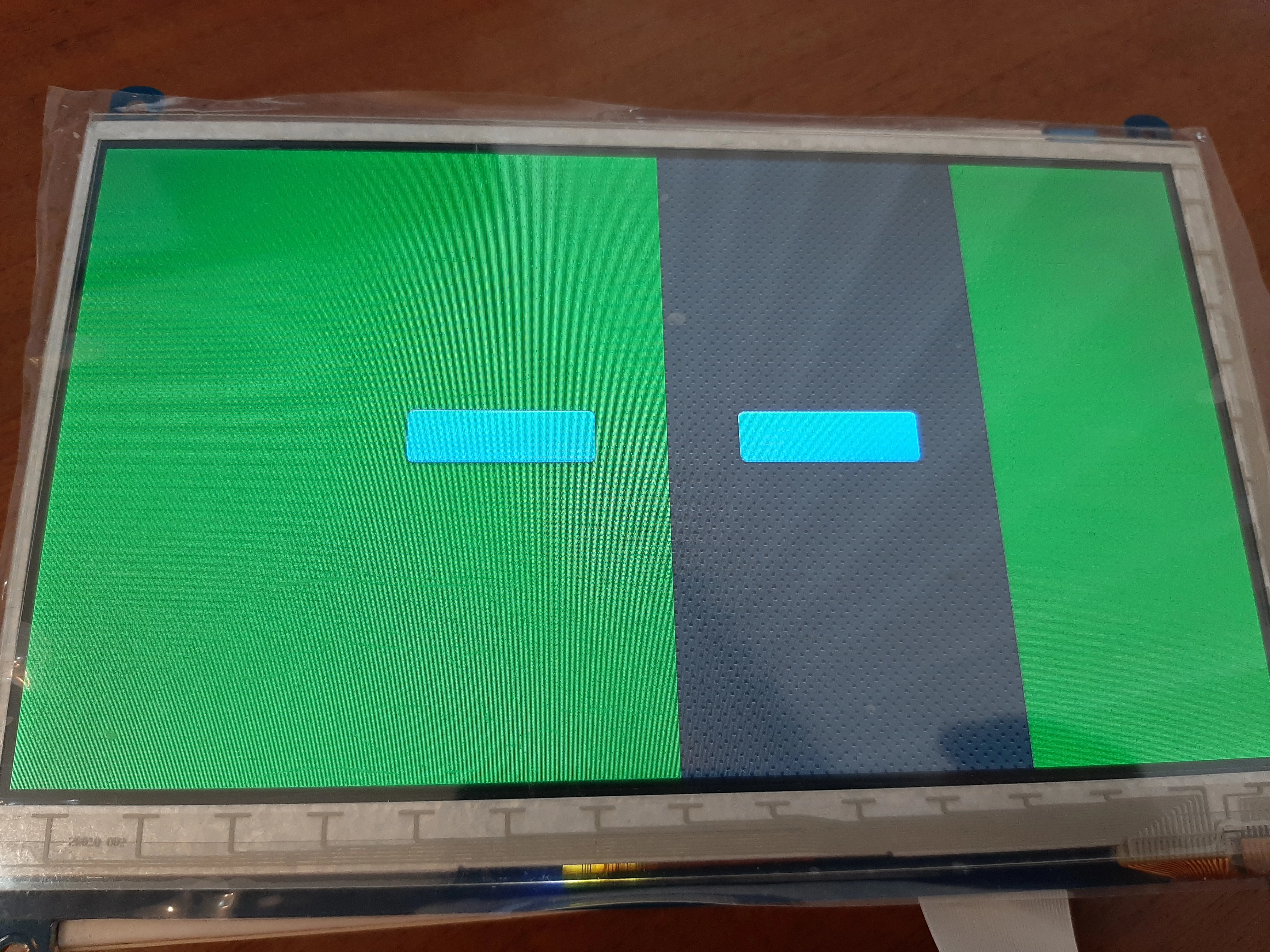

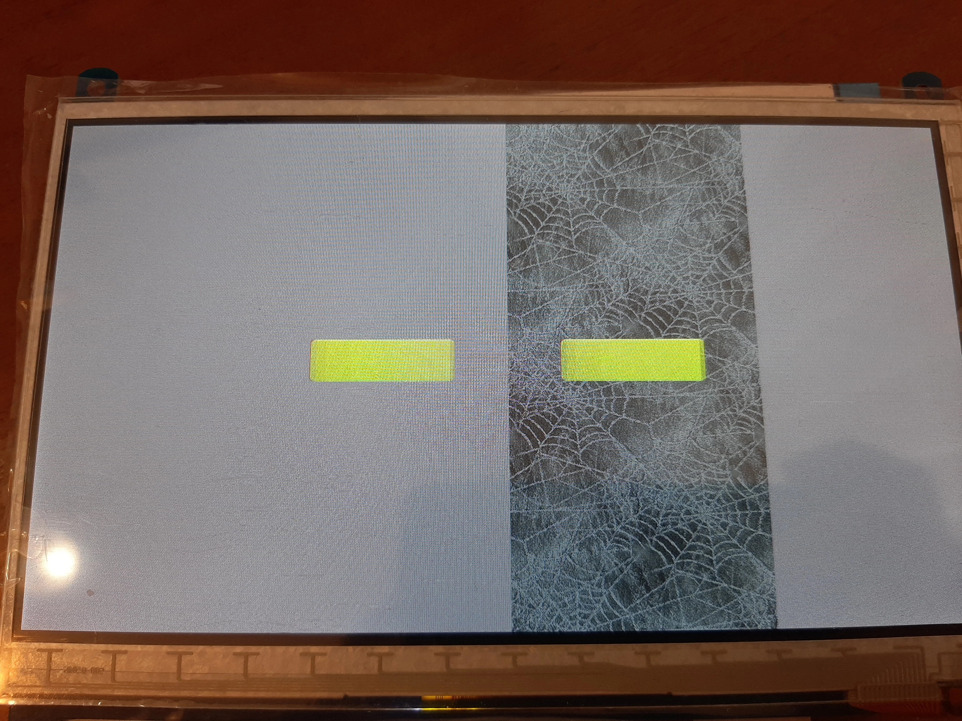

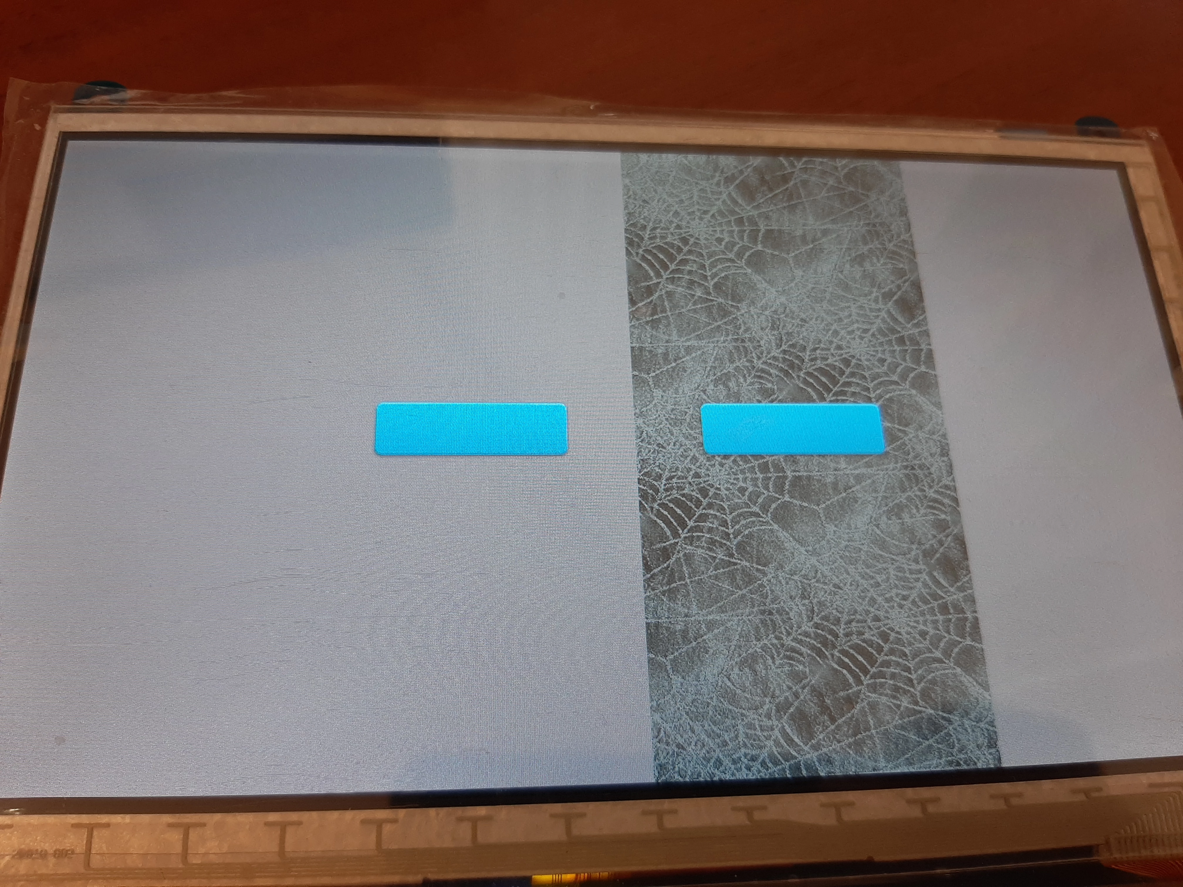

Incorrect color of standard buttons. png with transparent background. What is wrong?
Hi.
The problem is
The project is in the memory of mcu (flash).
button - OK
The project is in the memory of QUADSPI.
what could be the problem?
Добрый день.
Проблема �?ледующа�?...
Е�?ли пиши проект в mcu, отображает�?�? корректно. Е�?ли на флешку, то пропадает цвет кнопок.
Что может быть не так �? проектом???
Видео и проект во вложение.

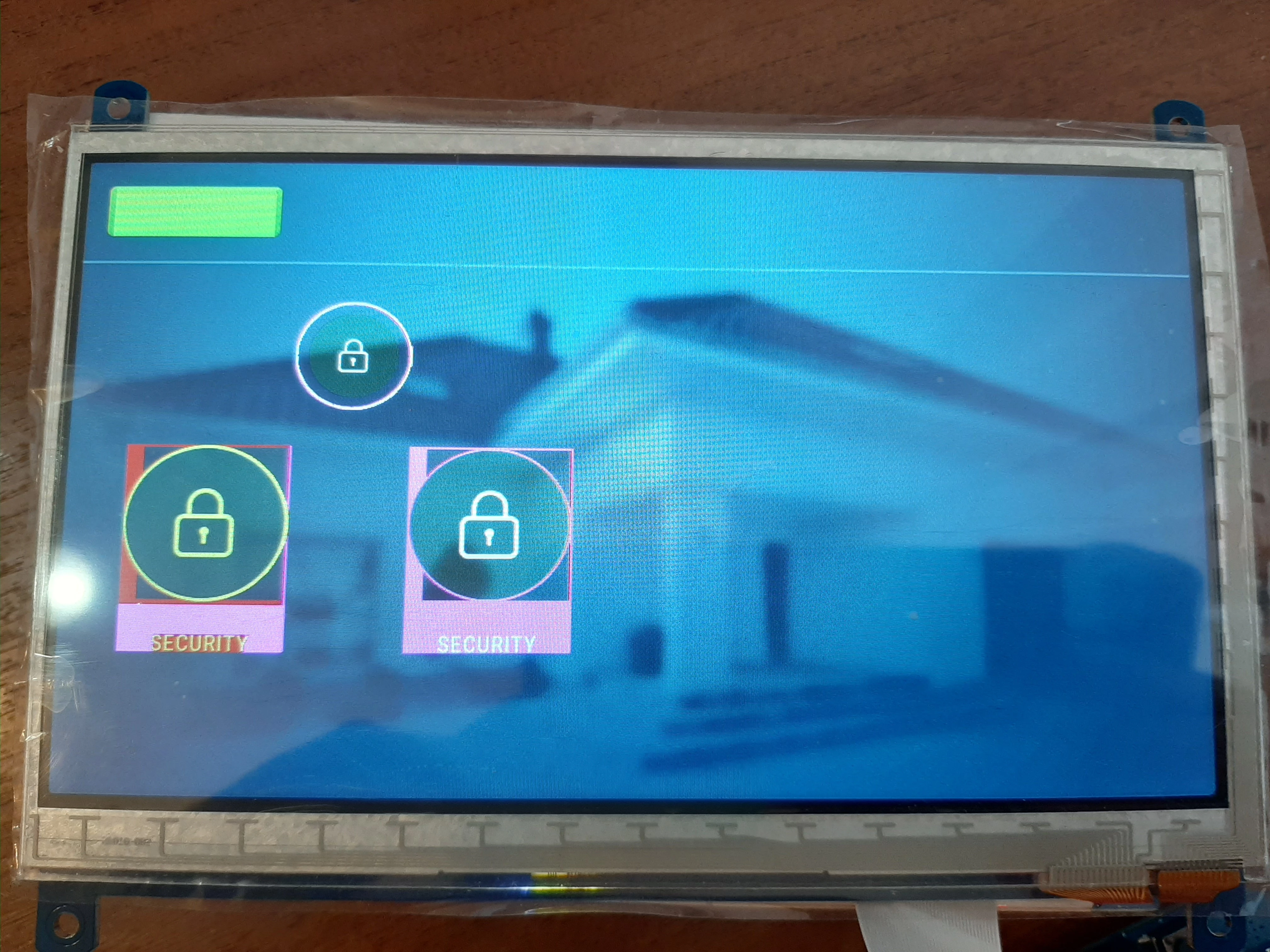

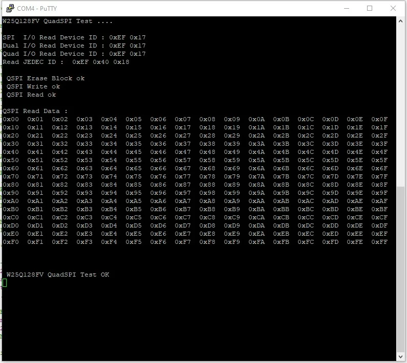

Oct 2, 2019 11:58 PM UTC
I see you are using a custom hardware (QSPI W25Q128 and others). Did you run sort of validation tests to make sure writing and reading from the QSPI is fine?
With regards,
Badreddine

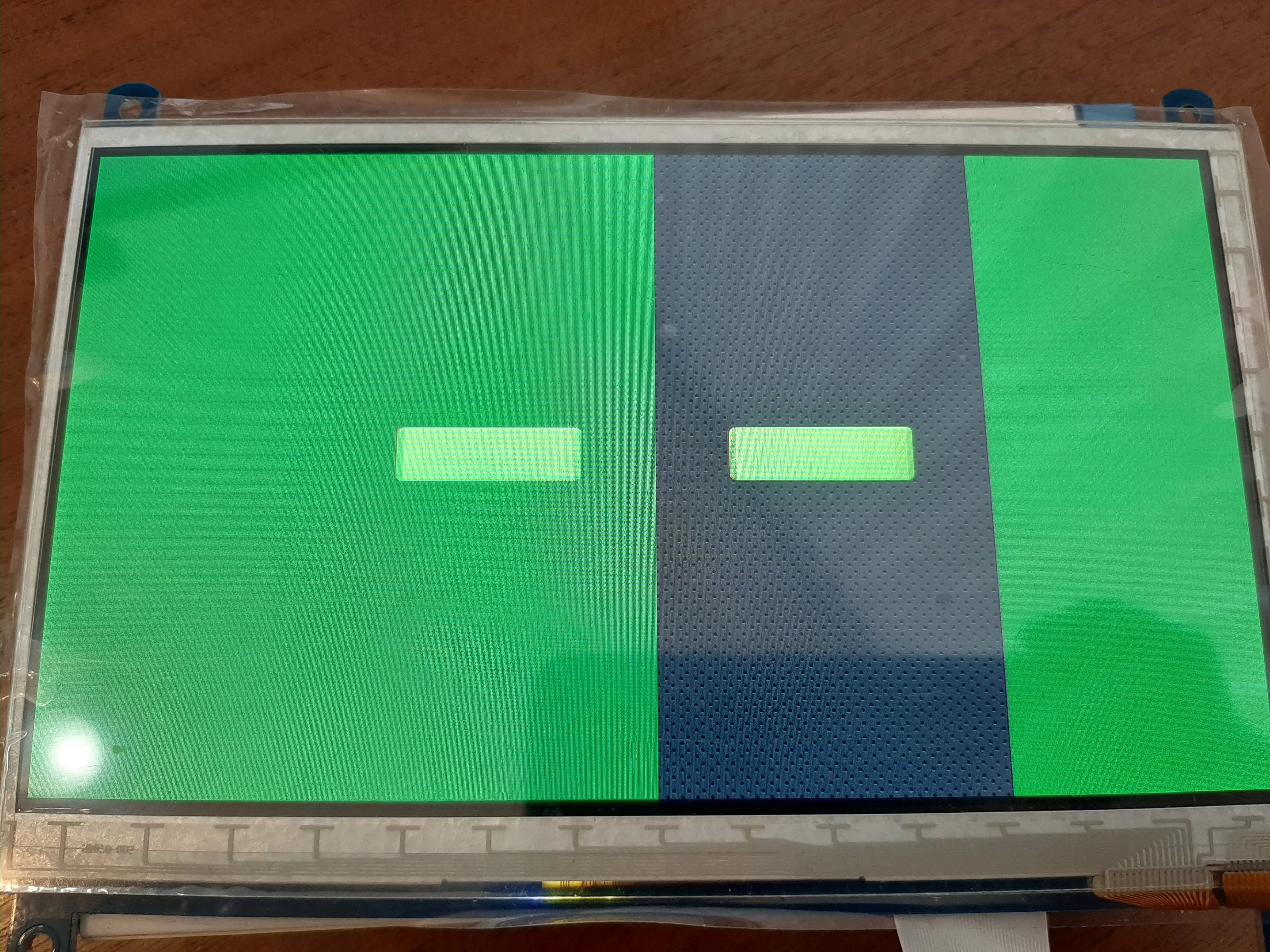

test project
