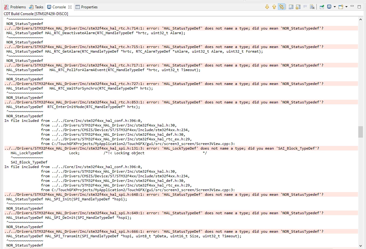

I use a STM32F429 with touchgfx.
From my GUI, I would like to use hardware features of my card like RTC for example, so I activated the RTC on the STM32 and re-generated the code.
So from my "Screen3View" file generated by touchgfx, I make an include of #include "stm32f4xx_hal_rtc_ex.h" to be able to use the rtc features on my GUI.
But when I compile, I get more than 300 errors.
Also, I noticed that if I import any module "stm32f4xx_hal..." then I get exactly the same errors.
I don't understand the errors...
Here's my code and it's the third line that poses a problem

Best answer by SGROU.1
I find the solution, I had to include :
#include "stm32f4xx_hal.h"
#include "stm32f4xx_hal_rtc.h"
