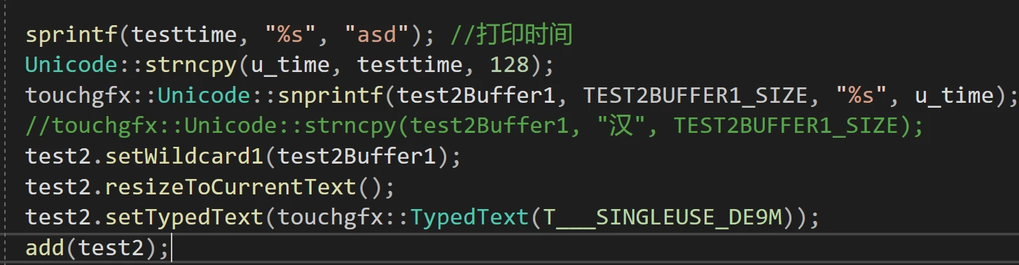

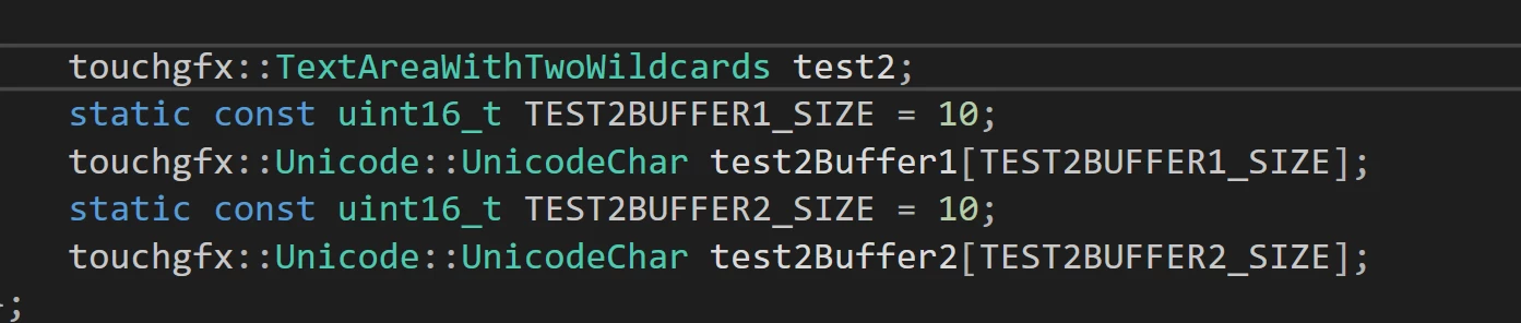

Thank u for your advice. It  works. However, I plan to implement a combination display of Chinese and dynamic numbers in a TextAreaWithOneWildcard , like“第%d组”,But it seems that there is no such function, and I can only continuously convert values to adapt to the sprint function in C language, but it still shows failure

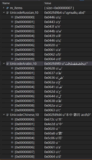

I use u"" approach:
static constexpr char16_t const * const UnicodeRussian = u"цупыйц";
static constexpr char16_t const * const UnicodeChinese = u"本中 您将";
static constexpr char16_t const * const UnicodeArabic = u"بطضغفحلظت";
 Now, all strings are Unicode and can be used with cast:
reinterpret_cast<touchgfx::Unicode::UnicodeChar const *>( UnicodeChinese )
