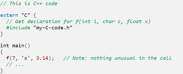

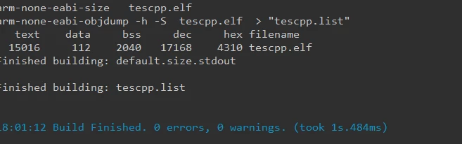

you need to add the extern "c" before you include your header i have tested it and it works fine this is illustrated in the picture bellow you can check this link for more details about mixing c and c++ you will also find a screenshot of the template project  with extern "c" addition
the main.cpp
example.h
example.c
BR

Calling a C function from C++ code requires the function to have extern "C" linkage, see https://en.cppreference.com/w/cpp/language/language_linkage and HAL header files.
hth
