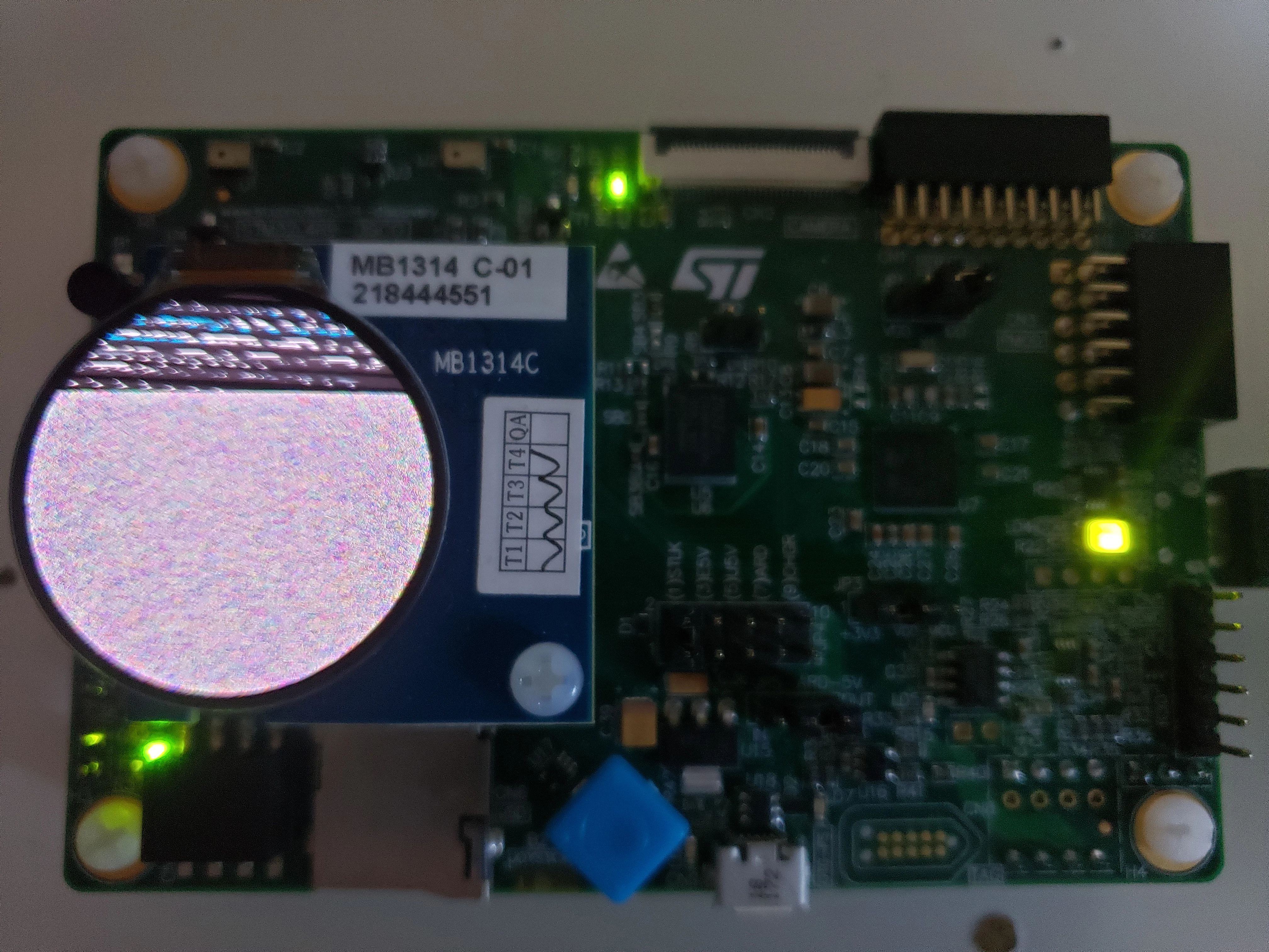

I am trying to implement a product that needs to swap between landscape and portrait mode of the same screen dynamically during run time.
I am using TouchGFX designer 4.16.0 with the TouchGFXWatch UI template to do some basic tests. When I run the target in landscape mode it works as expected. If I change it to portrait mode, as shown below, and run it on the L4R9I_DISCOVERY I get unexpected results as shown below (which is the same result I get from my code base).

Best answer by MM..1
On round display and maybe your code is used MMU for memory round and here maybe need you more changes in target code too , i recommend here dont waste time, you set only one orientatioín and in code rearange objects XY and angle...

For TouchGFX it is hard job, or for you, because angled design need some thinks twice. But simpler is when your LCD support change orientation by HW regs and very simple is when width=heigth.
When not then all images you need in two version one 0 and second 90. usw

The display I am using does not support 90 degree rotation (I cannot change the display), so the two options I have found are to either use TouchGFX's portrait and landscape mode or to create two screens (one at 0 degrees and one at 90). Preferably, if TouchGFX is able to do this it would be significantly better than having to maintain two identical screens with a 90 degree offset.

You can use one screen and rearange all object on rotation event , images need swap 0 with 90 then you need both ID, but some objects maybe dont have angle support.

You make it sound like swapping between landscape and portrait modes is a bad idea but the TouchGFX code base does seem to support some of it (get and setDisplayOrientation). Am I trying to use the TouchGFX code base for something it does not support?
