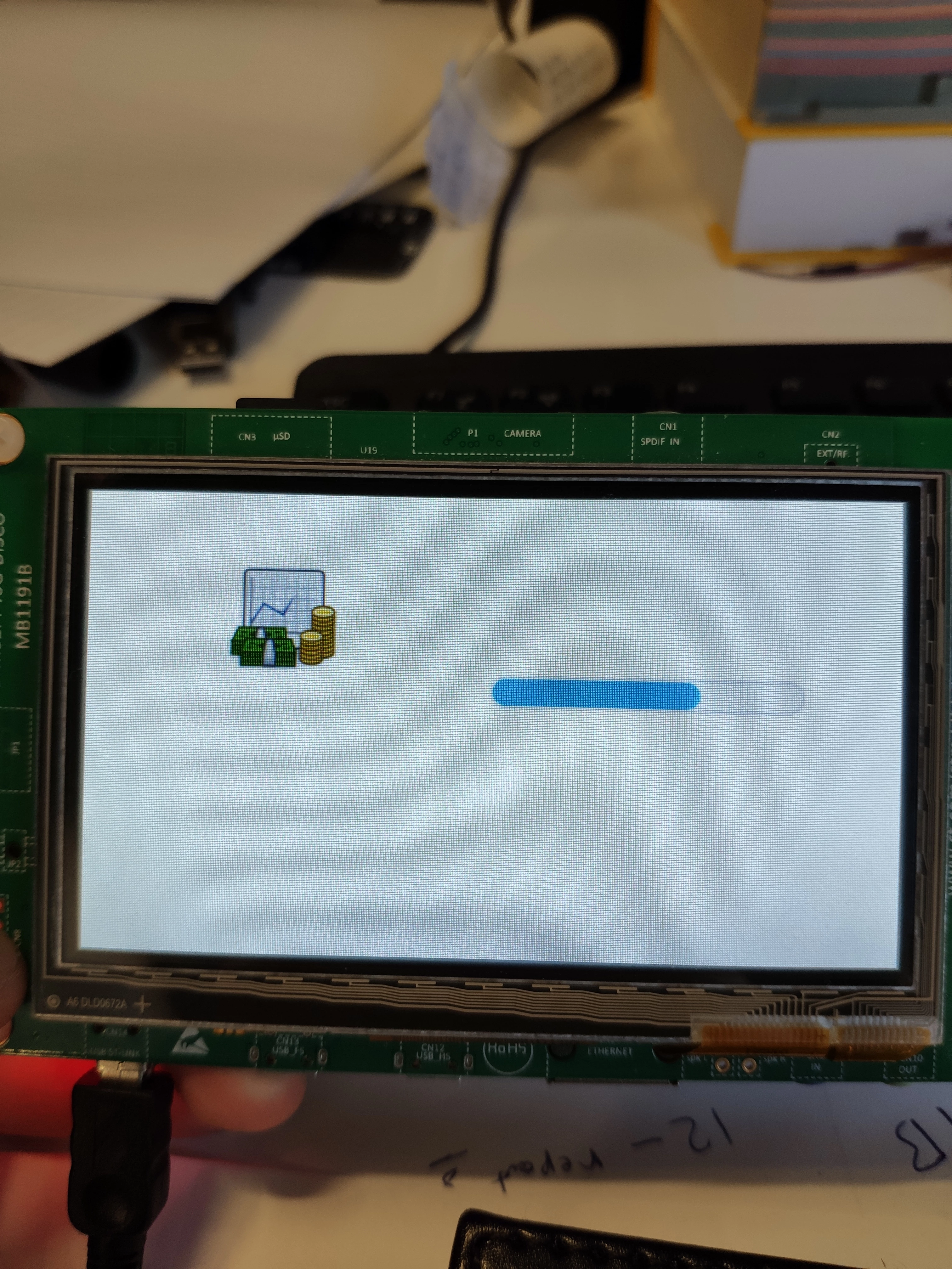

Here is the screen when compiling through TouchGFX Designer (GCC):

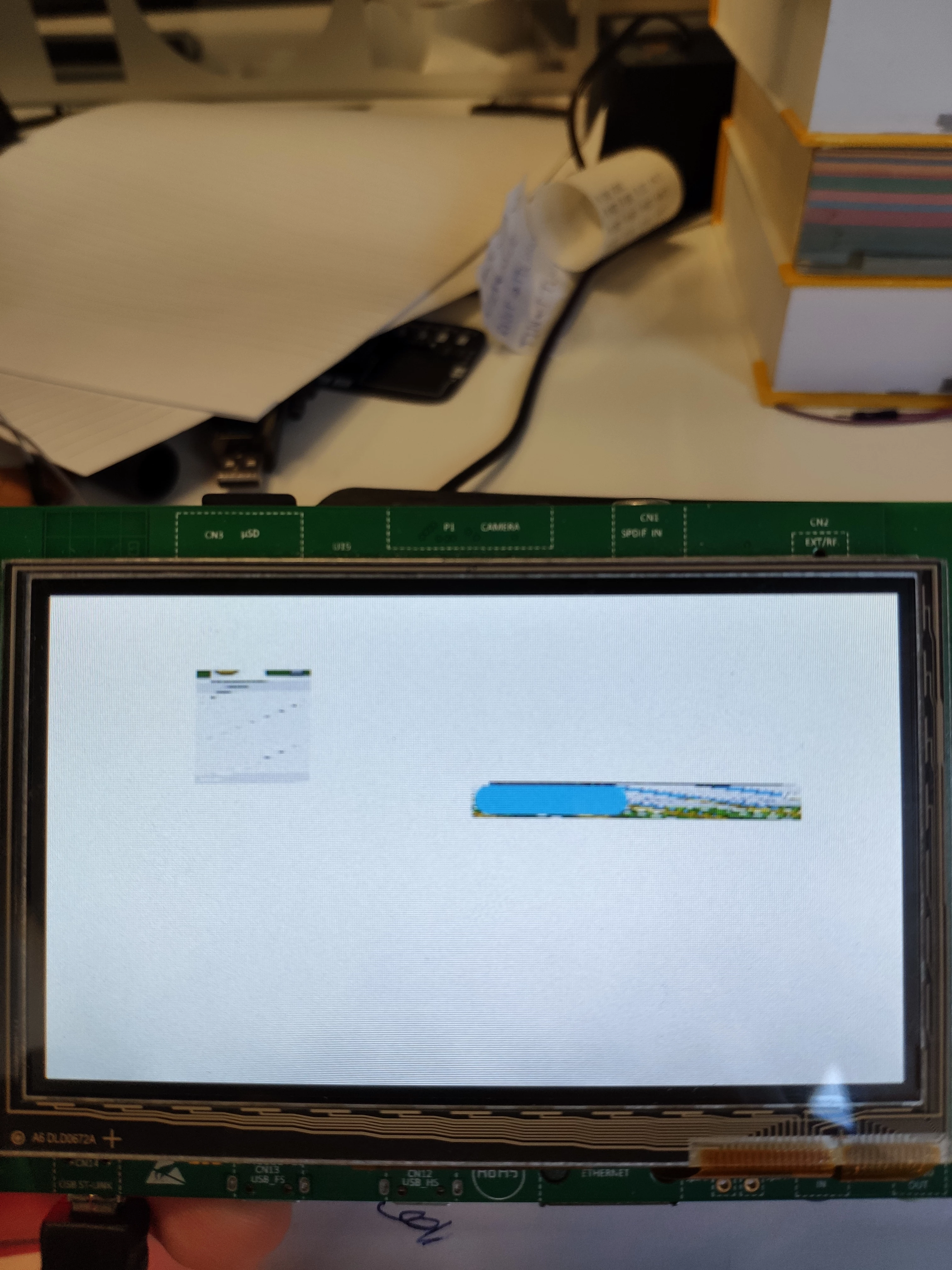

Here when compiling through Keil:0690X000009YFj0QAG.jpg
Any solution to let Keil compile correctly ?

The post-generate command in the keil projects should generate a .hex file that you can open with ST-Link or STCubeProgrammer. Choose the External Flashloader that matches the one on your board - This enables ST-Link or STCubeProgrammer to program the range present in the .hex file.
Let me know if that makes sense

Hi, I think you need to reprogram the flash. The Keil project does not support a flashloader for the QSPI (Where as the TouchGFX project calls ST-Link behind the scenes).
/Martin
