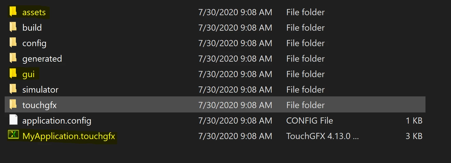

You enclose a zip file to your message. You can see a paperclip logo below the message box of your post, that allows you to enclose the zip file.
The only folders that are necessary in the archive are the ones in yellow in the image below. The other folders can be deleted.
/Alexandre

Because I created the project using the Stm32F769i-Discovery template, I ended up adding the STM32F769I_DISCO.ioc file, the STM32CubeIDE directory, and the directories you mentioned placed in a TouchGFX directory.
These are in the attached zip file.
I tried including just the files you listed but when attempting to run it, I needed these extra files.
Hopefully, this way the simulation works for people ;)
